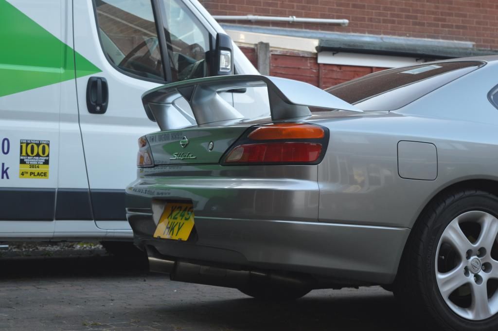

Started making some decent exterior changes to the car over the past couple of weeks. Firstly i fitted the aero spoiler that i bought before i even had the car. Tried finding a boot with the holes already drilled but none popped up so drilled the holes myself at work. Just marked the centre of the holes inside the boot lid and drilled. Think it looks alot better now personally

Just a question, but since you've put an aero spoiler on your trunk, what are you going to do with the OEM rearlight behind your rear window?
If you decide to sell it, here's an interested person :-D
6 October 2013
301
West Midlands, England
Just a question, but since you've put an aero spoiler on your hood, what are you going to do with the OEM rearlight behind your rear window?
Will more than likely just remove the bulb to be honest buddy. May change my mind on the spoiler in the future so gonna keep it just incase :)
