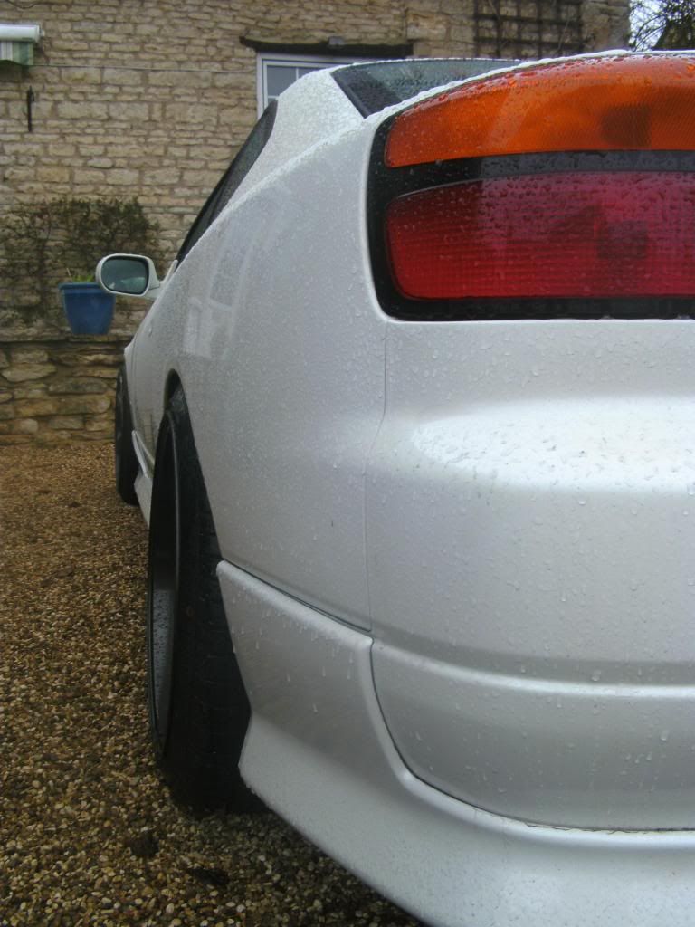

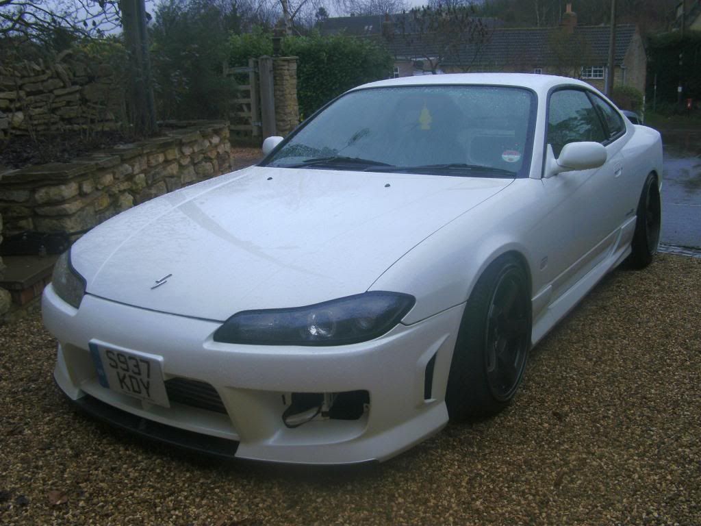

Hey all, been a while since my last update... again! i should definetly get on here more as there seems to be a lot happening!! Ive done a few more bits and pieces to the car and took a few quick photos this morning (excuse the bad photography skills!!) :rolleyes:

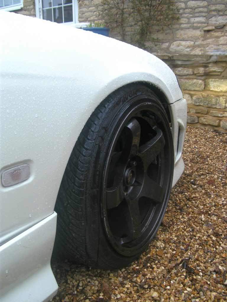

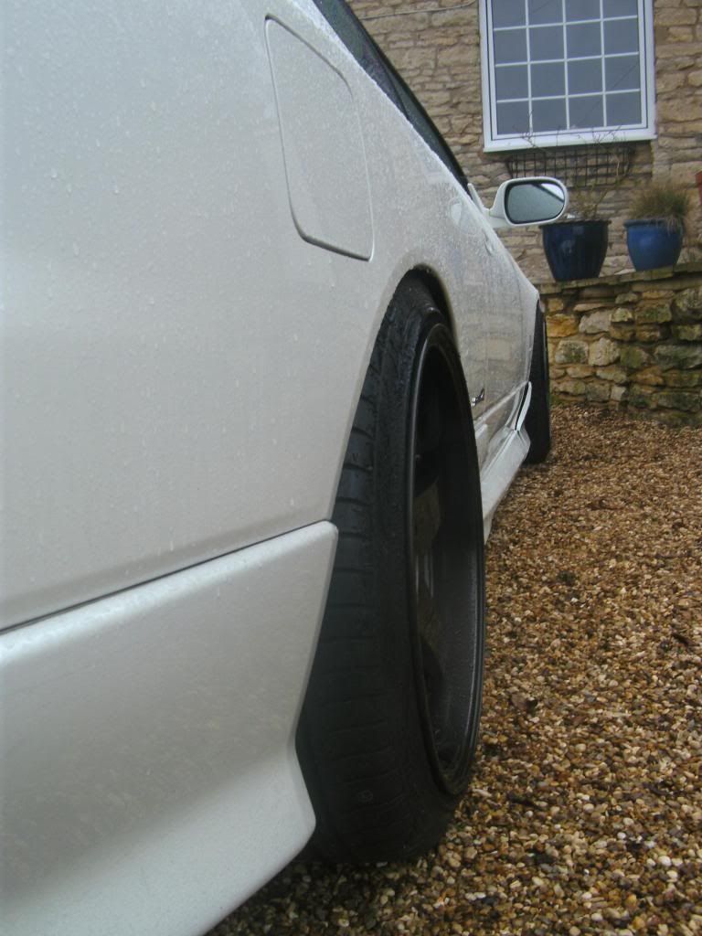

Ive added a nice front mounted intercooler and changed the rear wheels to Rota GTR-Ds in 18x9.5 flavour so its now running staggered fitment with the 17x9.5s up front! Plan now is to get a slight flare on the rear arches and run a lot less rear camber with a 20/25mm spacer so my track ends up the same as, if not wider than the front! :wack: ...also it'l look mint!! :p
Next i picked up a nice Bride Zeta 2 seat with a Recaro side mount rail and a Safety Devices 3 point harness and ive done away with the aero boot spoiler! (for sale ;)). Also ive been working on fully stripping the boot and rear seats of all sound proofing, plastics and belts etc etc. The front is nearly done too but its a mission of a job!!! The weight saving is immense however and i dont mind the extra noise! :cool:
Heres how she sits now...

What offest did you go for for the rear? Saw your wheels when i picked up the GTR rims :D
What front mount also? how was the fit? see you have removed your foggys
Mike
29 April 2009
476
Kettering
Alright Mike! The offset is +28 but ive added a 3mm spacer as all i have lying around so now its +25. As for the front mount im not sure on the brand, i got the core brand new from Tooley and i bought the pipe work new from eBay! Quality is all top notch! Yeah ive done away with the fogs but i prefer it without them anyway, going to have the bumper off and cut out the fog brackets and tidy it up, maybe get some mesh in there? Not sure :) Cheers!

car is looking sweet,love the stance mate look really nice! how does it handle with that set up?
Cheers mate! Im a bit of a stance whore now (spent too much time on Driftworks) :rolleyes: Handles well in the corners with the -2.5* negative camber up front... never a hint of understeer! Only problem i have is straight line traction in the rear if its a bit wet out but if i flare the arches and wind the camber back from -4* to -1* it should be a lot better! :)
