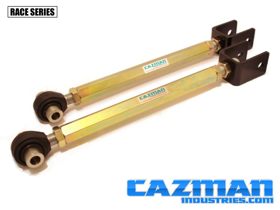

So after my last track day, one of the rear adjustable toe arms has been making a lot of weird noises. Initially it went away after I sprayed some WD40 on it but it eventually returned and got worse and worse...
Jacked the car up today and have a close inspection, turns out that there it a huge amount of play in the ball joint (pillow ball joint I think it's called). And this was caused by dirt and crap getting into the joint and wearing it out.
Conclusion, don't install any suspension arms that don't use rubber boots around the ball joint...
So I just ordered some Cazman Industries rear toe arms, high quality product made in Australia. Will install once it arrives and hopefully remember to take photos while I install it.

So finished install my new toe arms today, everything went pretty smooth.
Jacked up the car and marked some lines on the elliptical washer/bolts so that I could put them back in exactly how they were. Removed the toe arms and measured them so I could adjust the new arms to the same length. Once they were in I did up the nuts loosely, car was then lowered to the ground and the nuts were tightened to the correct torque.
Couldn't find a (good) alignment shop open today so will have to wait until Monday to get that sorted. Kinda sad car has to stay at home all weekend though =(
