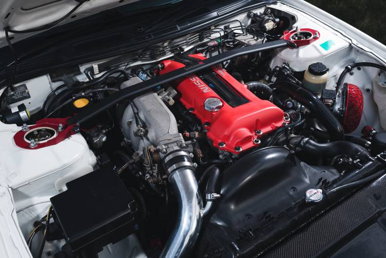

Ive finally booked in with greg at protuner to get the link installed and tuned, so far i'm having him fit a 255 fuel pump, 740cc nismo injectors, new fuel pump relay and wiring, link ecu, intake air tempurature sensor, map sensor and mafless intake pipe (hks hotboi pipe), compression test, boost leak test fuel, ignition timing alignment, hks evc 6 boost controller set up with link and obviously full dyno and road test and tune. I'm booked in for the 3rd of June and can't wait to feel her come alive, before that day can anyone advise me on anything else that may need doing or fitting around the same time to help protect the engine or that would be worth doing whilst its with him? any advise is welcome! thanks in advance

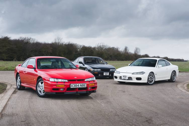

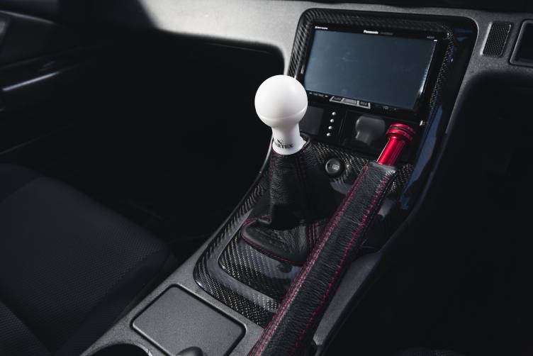

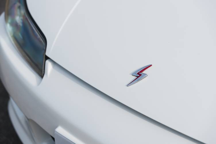

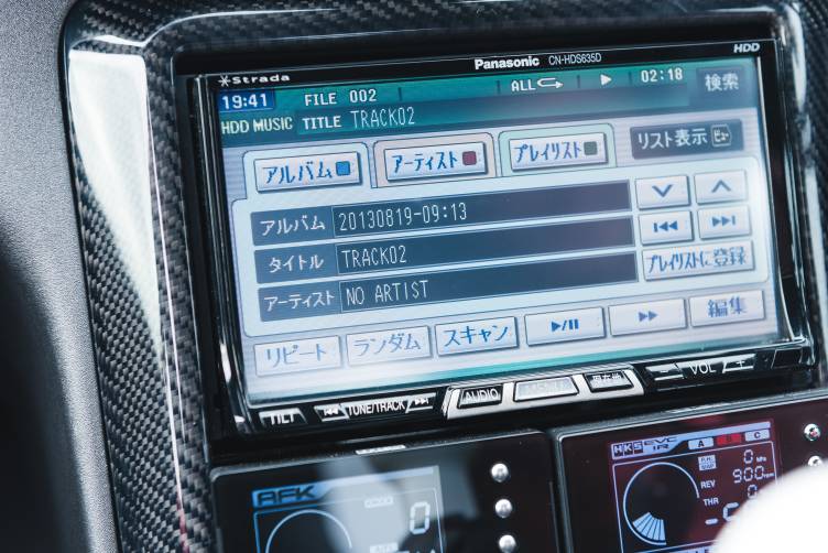

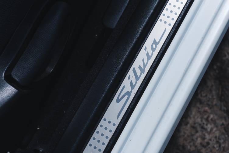

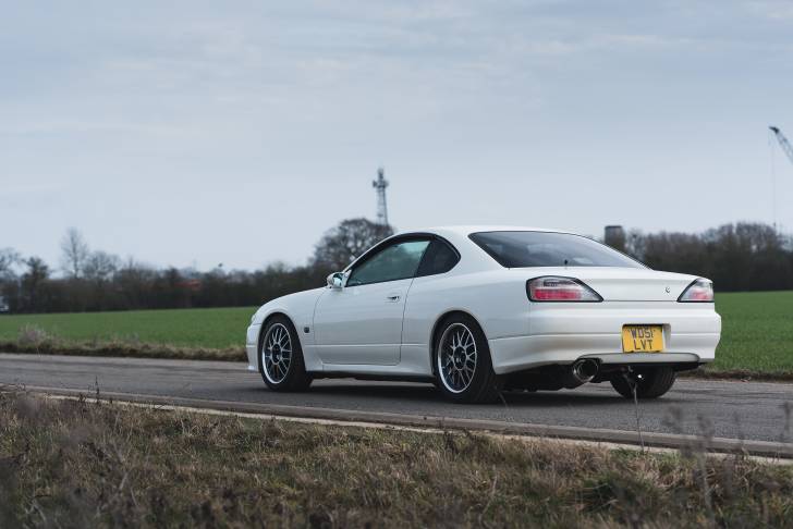

Since its been released in shops I can now officially say that my 15 was chosen for a shoot for modern classics magazine! As you all can imagine I was stoked to do it because having your car in a magazine is badass! Especially as it was chosen as being one of the cleanest stock bodied cars in the UK. Anyway thought I'd share some of my favorite photos from the shoot, all photos taken by Jordan Butters one of my favorite auto photographers so again pretty stoked about this!

Yeah I spoke to him yesterday and he has finished mapping! Had to take the hks boost controller out cause he couldn't get it to work so it's now just a really expensive monitor but he did fit the link controller and got 320bhp peak on 1.075 bar which is pretty sweet! So yeah should be really fun now can't wait to test it out! It's been fitted with a switch as well so I have high and low boost settings now, low is 0.8 bar high is 1.1 basically.

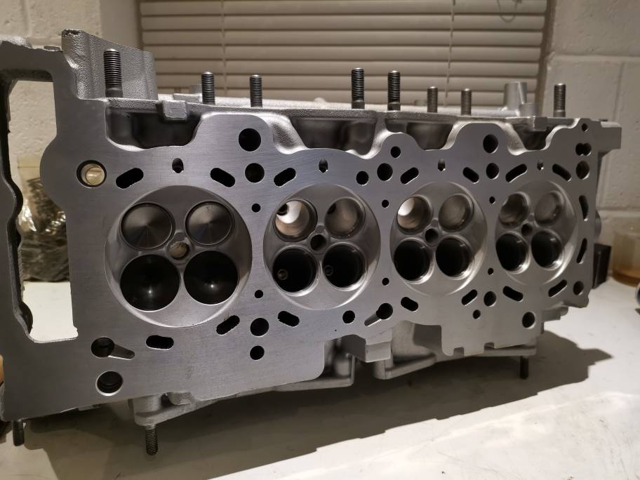

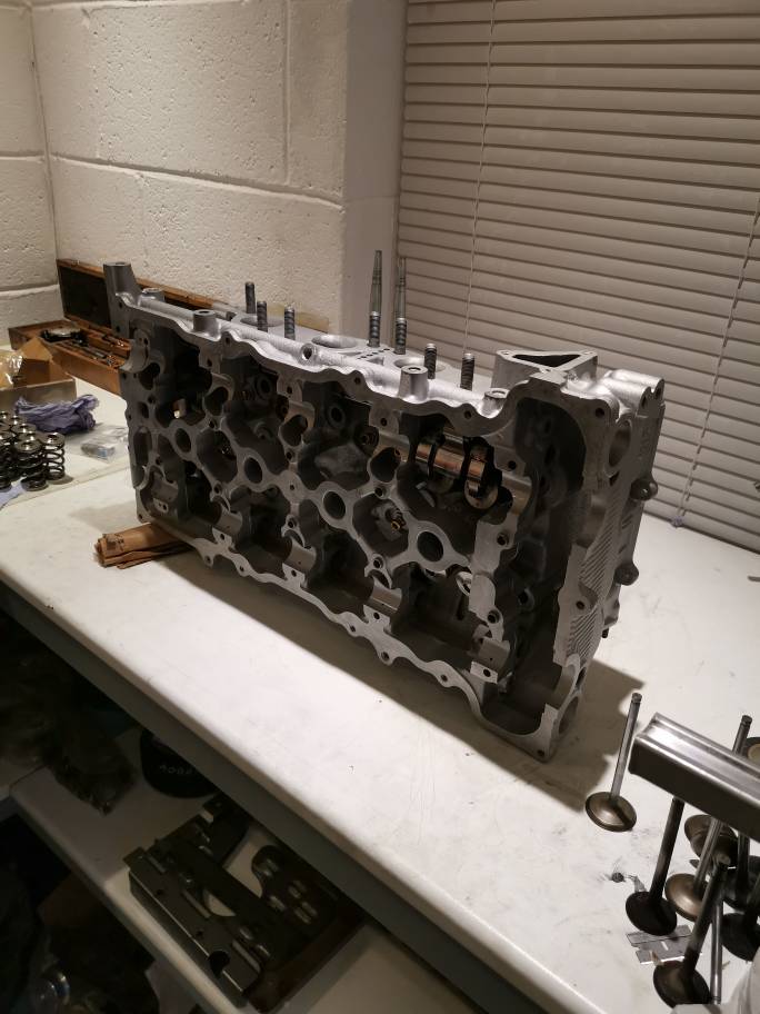

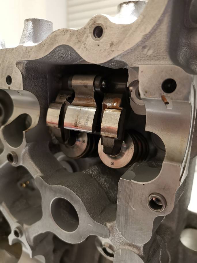

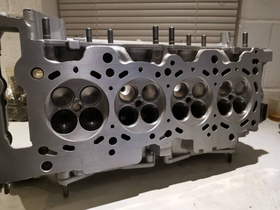

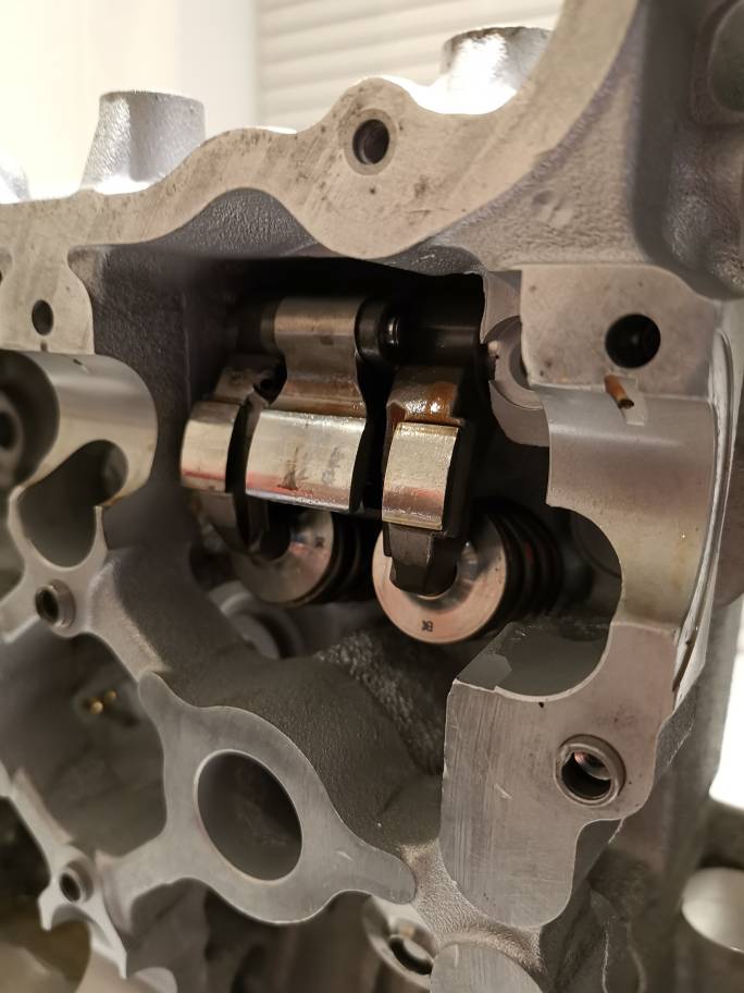

Cheers man , how was it down there ? No idea why it’s got bc retainers in there though was meant to be full supertech head

Your engine looked beaut in his build room though! He mentioned that there may have been an issue with the other ones?

Ha ha quality man. Glad it was worth the wait ! Yeah I will wait till I get full assembled pictures before I get too annoyed ha ha although bc is the last thing I want in there when I have spent so much money on the engine see what happens I suppose .

For reference:
R34 gtr fuel pump with new wiring and relay
Nismo 740cc injectors
Link ecu mapped by Greg protuner
Conversion to map with hks maf less intake pipe
Air intake temp sensor fitted in front of throttle body
Link boost solenoid with 0.8 and 1.1 bar switchable map
320bhp on 1.1 bar
Previous mods:
Tomei manifold
Hpi turbo elbow
Decat
Hpi twin front pipe
Kakimoto regu 06 exhast
Hks power intake and filter
Split fire coilpacks
Blitz fmic
Tomei rocker arm stoppers
Stock turbo
Stock internals
