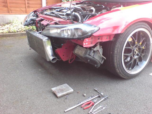

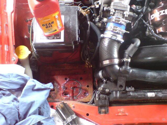

HKS FMIC fitted

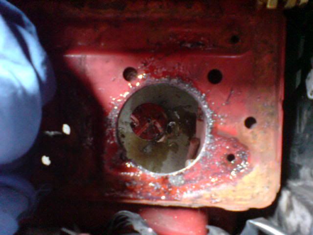

Thanks to Mike and Ian G for the loan of the hole cutter to save me the pain of drilling a multitude of holes in the battery tray and then chiselling and filing the resulting mess...
After much slow drilling and the drill snagging and trying to smash my arms into the inner wing, it finally went through...
Cooler fitted, just before removing the wing mounted one. Cheers for supplying the temporary one, Chris :) :wave:
The pics I took of the fitted item didn't come out so I'll take some more later. For reference, the centre of the hole is 100mm from the right and 120mm from the fusebox side of the battery tray, and is the same for the generic FMIC pipework kits (from the Apex pdf) , and was spot on.

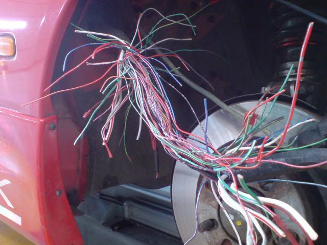

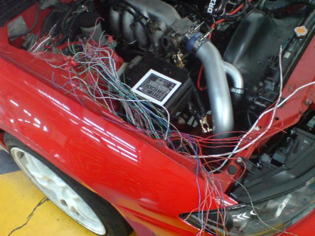

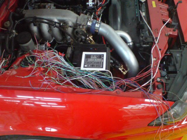

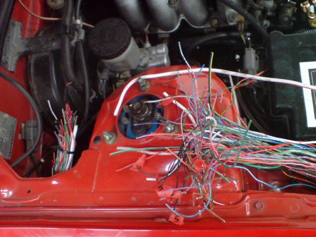

Took the car to USC last weekend, and found that the 18's were rubbing through the loom on the driver's side. I decided to cut it and relocate it to the engine bay, something I will never do again in this way. Took absolutely ages :nod:
Just needs wrapping up now that all the wires have been reconnected and heatshrinked. So glad that it is over :annoyed: :nod:​
