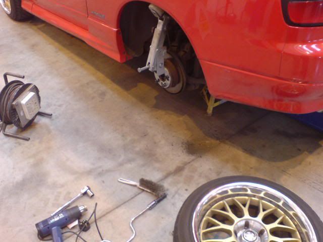

Spot of arch rolling...

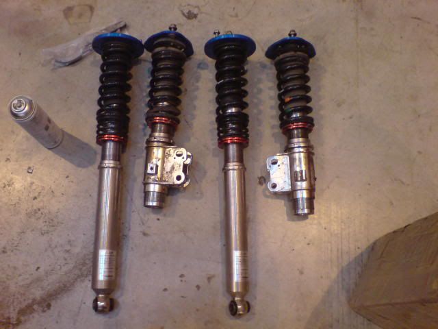

The cuscos prior to fitting

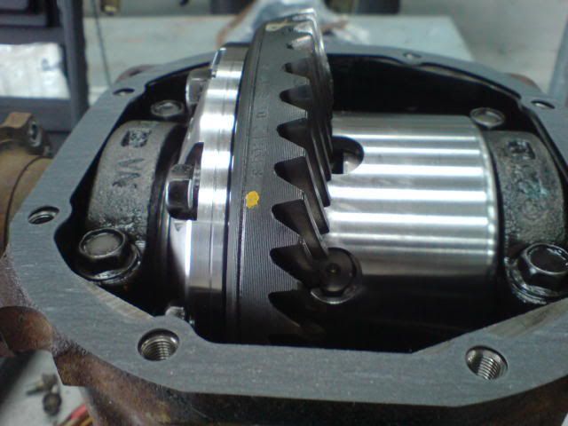

New shiny Kaaz 2 way diff

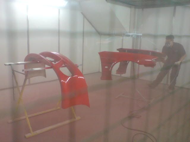

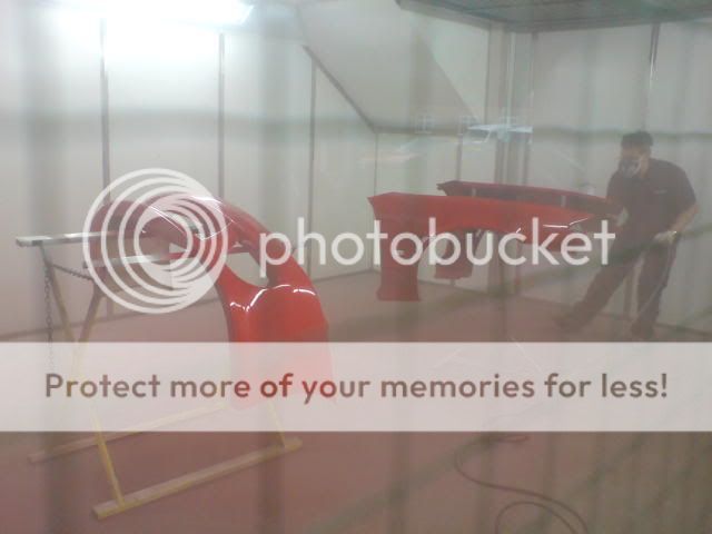

Martin (LK Drifter) painting the wings and bumper. Cheers mate...

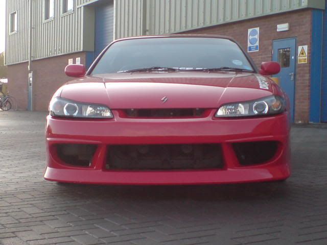

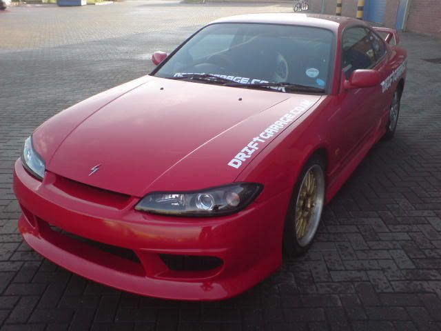

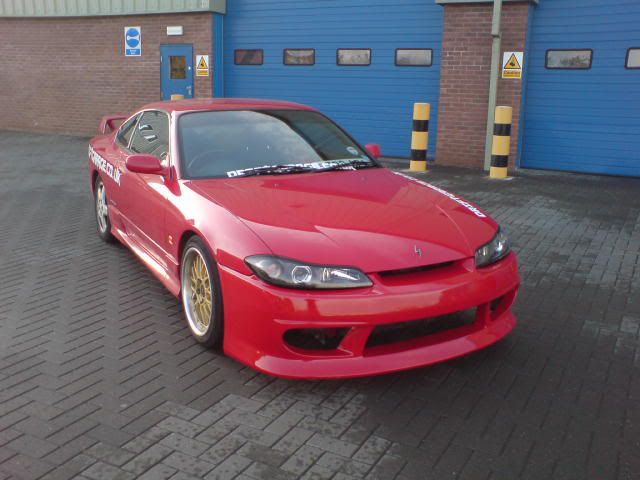

And front bumper fitted. Excuse rear wheels, I'm off drifting tomorrow:D
did you have set up back lash etc or was it a case or remove open and drop in kazz? is this a job for a pro or could a dummy like me do it

No, kept all the original shims and it dropped straight in. No dramas at all, this one...

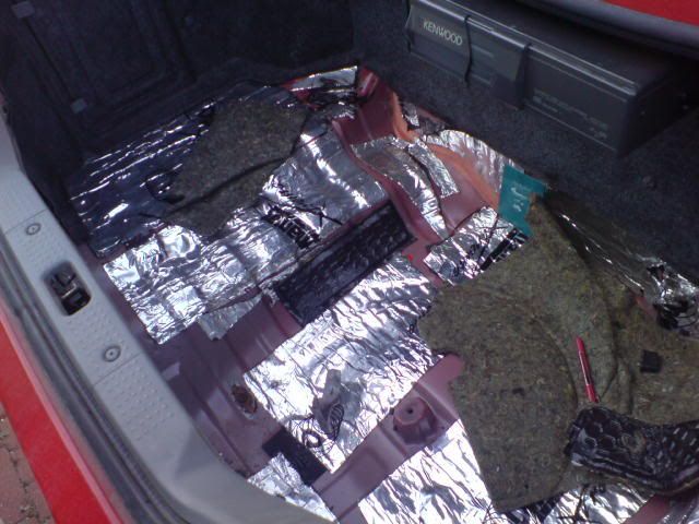

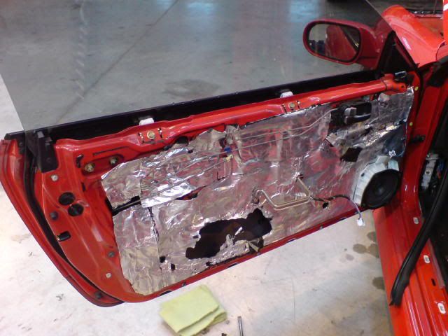

One of the first jobs I need to do is free of charge but I'm dreading the most. The amount of dynamat sound deadening in this car is unreal, and the gooey ****e backing the metal foil all needs to come off. It's in the boot floor up to the shelf, rear quarters, doors, parcel shelf....I'm not looking forward to lifting any piece of carpet as I'm bound to find more. Then once that's all off, I have to strip out the original sound deadening that Nissan put there :D

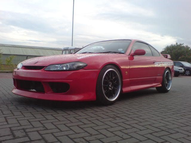

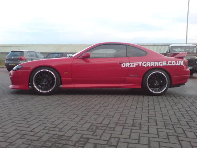

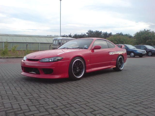

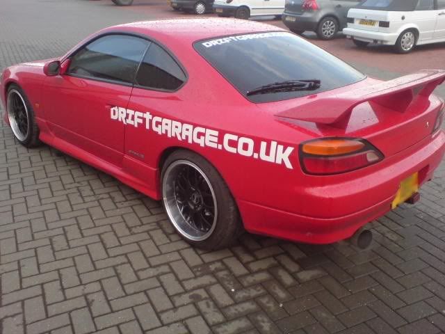

Cheers mate. Here it is with the ultralites fitted. The fronts needed a small spacer to clear the coilovers, but I'm thinking of putting the other dished pair on the front to match the rears, and get the centres painted gold. As a daily drive I wanted it to look tidy, so engine hasn't been started yet.​

cars looking pimp mitch i gotta say a little sex wee dribled out :smitten:
Mitch, did you have money you needed to get rid of quick before the IR caught up with you or something...? :p

Nah, just sold the 180 so had to use the money before the house purchase swallowed up the rest:D You'll get used to the difference in speed...I'm just not a huge fan of those long drawn out projects that don't get used.

Looking good mate, did you not have wider front wings for it?
What sizes and offset are the wheels?
M
mitch
I do, mate. I just didn't have time to put them on yet, as I was in a rush to go drifting.
I have 9.5X18ET35 and 8.5X18ET30, but I have another pair of 9.5's which I may put on the front with the wide wings.

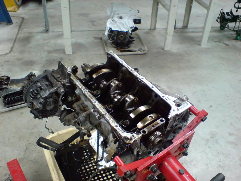

Anyway, update time. I've been pootling around in the car and starting to sort the SR20DET conversion out, but have been held up as the main bearings are bollocksed...oh well.

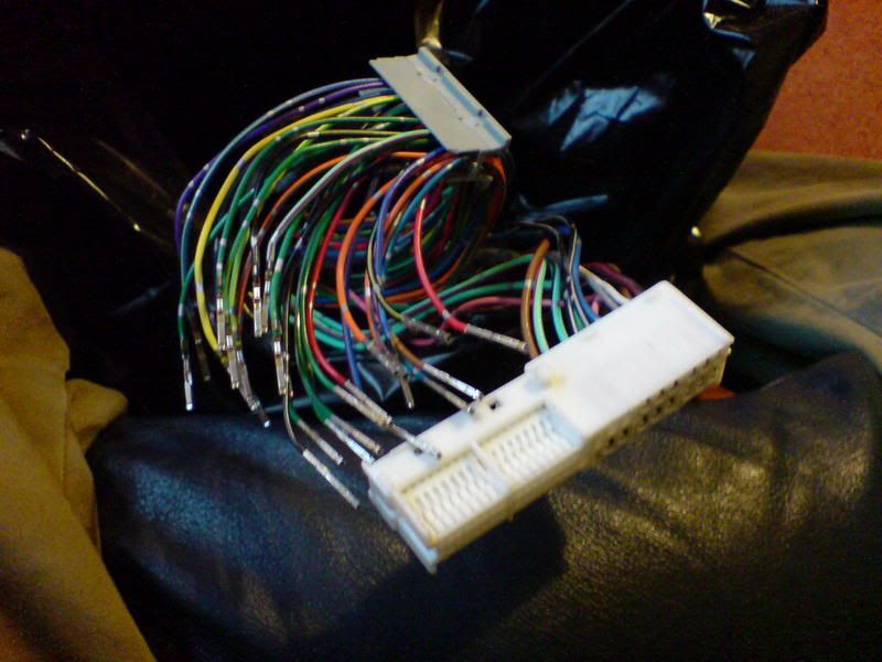

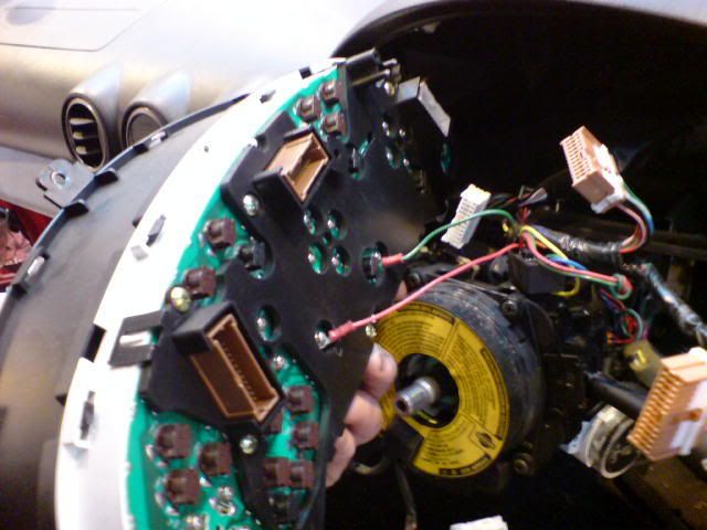

Oooh, spaghetti....

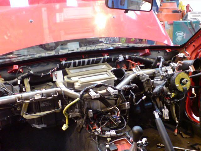

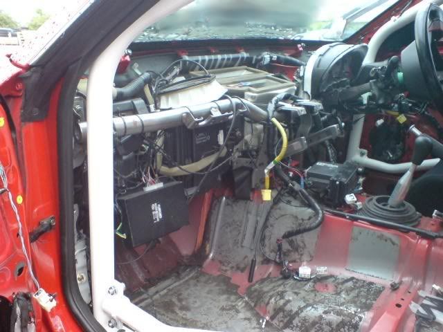

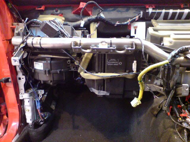

Been removing some of this...

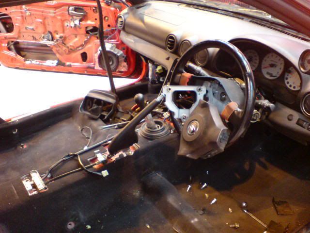

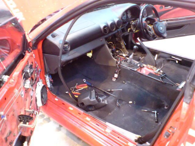

Then started prepping the car to go away for the cage...

Massive thanks to Max (V-Max) for driving over today to lend me the security torx tool for the passenger's airbag. I had got some of them off but a couple of recessed ones were being a right royal pain.
Cheers mate, you saved me a lot of work :)

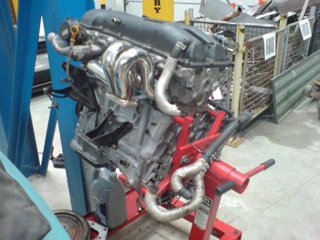

I had a result yesterday, as a mate had some new main bearings for his upcoming engine build and he let me buy them, so the engine is now built. I just need to fit the manifolds and ancillaries now, but the car was dropped off for a cage this morning so I have two weeks without it anyway. Just in time for the house move, so that ties in nicely.
Also yesterday, I removed about half of the interior sound deadening material, which is a bit of a mission in itself:D

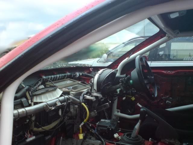

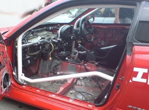

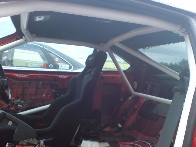

Here are the cage pics at last. Basic enough that I can fit the spare rims in the back, but sturdy enough to make the regs :)

However, the engine is nearly ready for installation now, I just need a couple more bits fitting to it and then drop it in this week. This is the slowest project ever :(

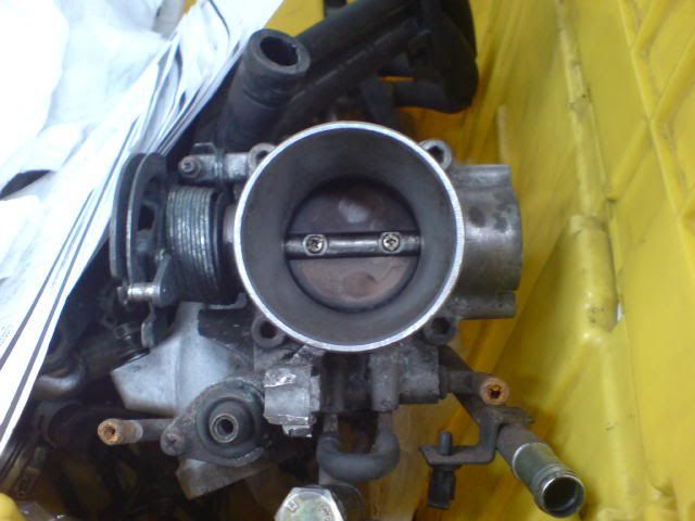

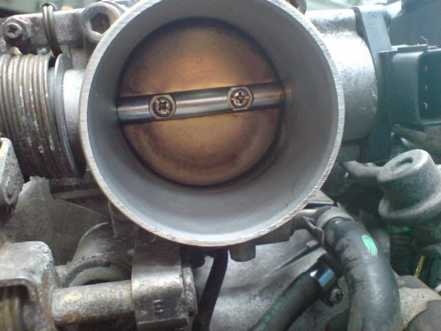

Salvaged a part off the DE engine to replace this...
That's better....
