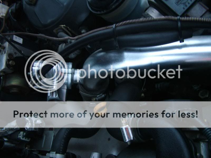

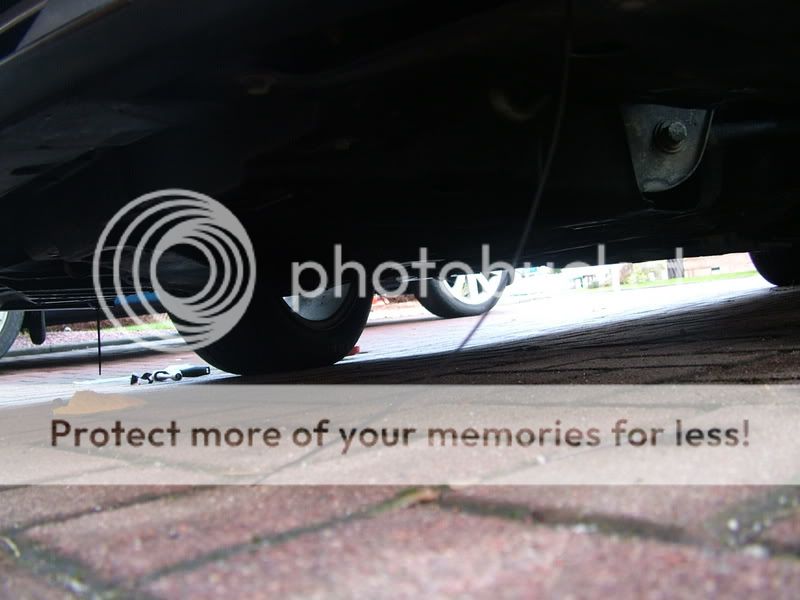

Are you sure the wire thingy is not for some sort of EGT setup? The fitting looks to be the part.
I must agree.
That's some over-engineered piece of work if it's for boost.
I would put my money on EGT, or possibly a mechanical oil temp or pressure gauge. Get a electric gauge instead and you would only have to run a signal wire through the firewall instead of that AN3827 pipe-line :)

indeed i think its actually a mechanical pressure gauge for oil pressure maybe???
The gauge dosnt say boost it says pressure.. 100x something i think on it.

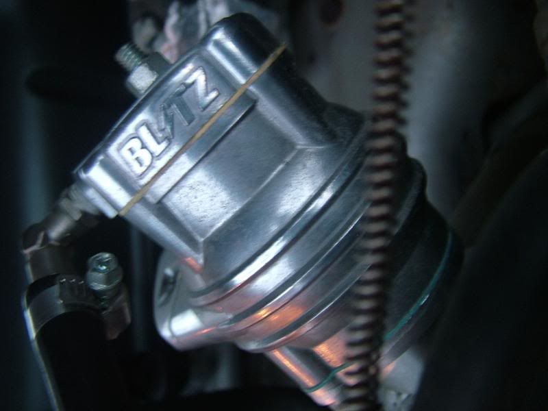

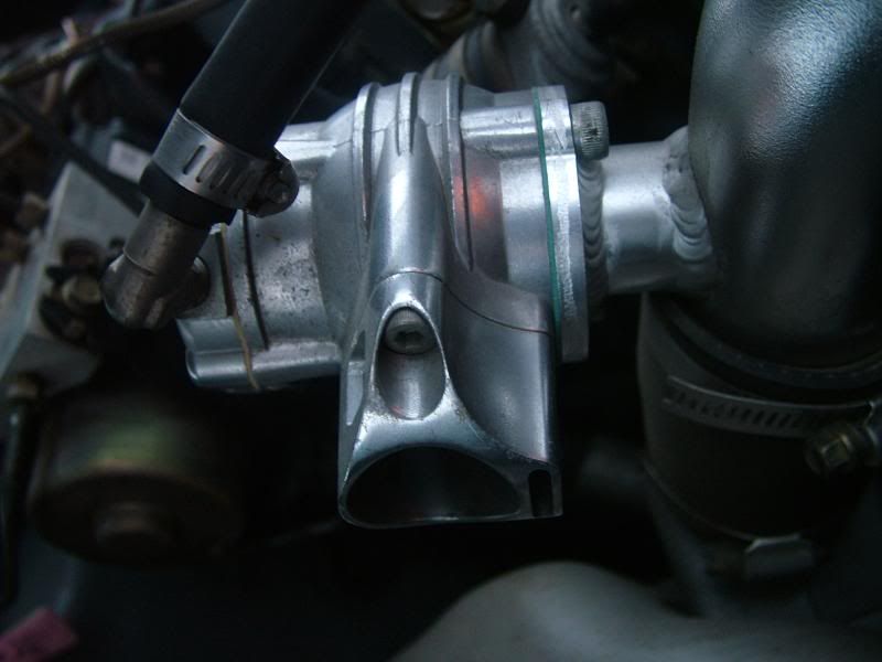

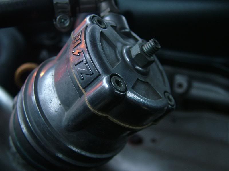

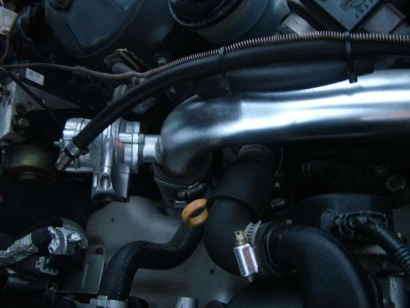

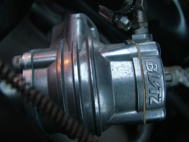

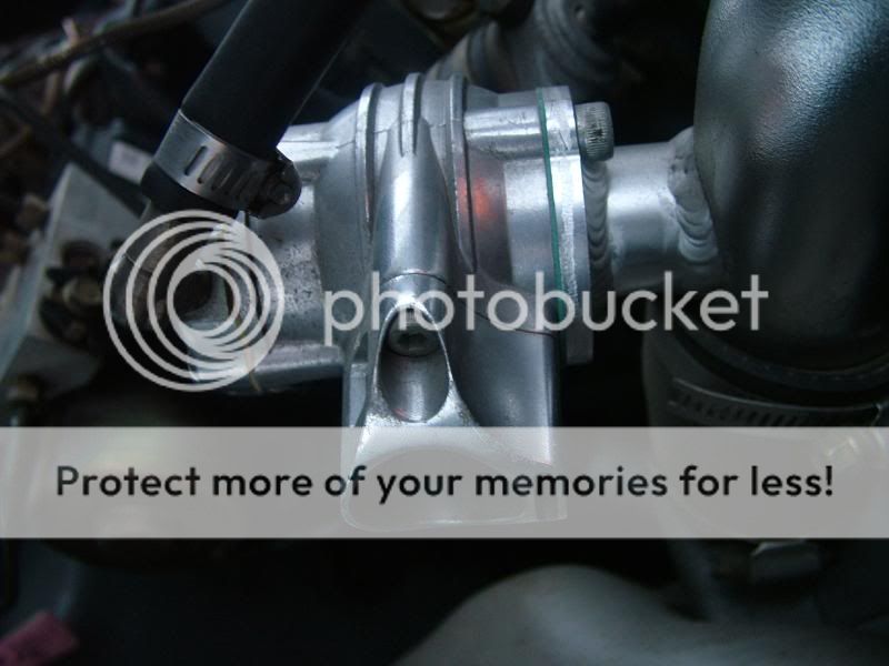

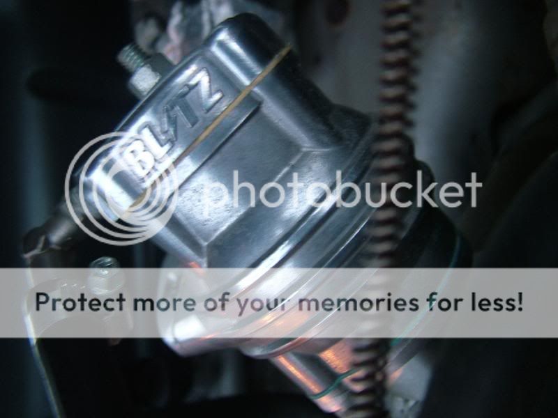

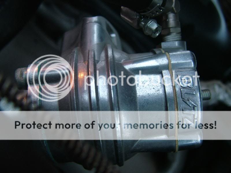

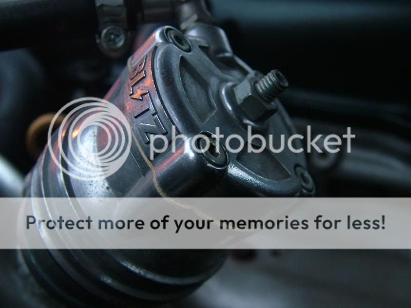

Whats eids? I'll go take a pic of the BOV see what you guys think..
-Mint
This is where you adjust it, loosen off the nut, the wind the threaded part in or out (cant remember which way), do small increments, then tighten the nut, go for a drive, get the revs up, dip the clutch, if its stalls twist the threaded part the otherway, if it doesnt stall, is should hold the revs better.
I must add that with an atmos bov, its will never run as smooth as the car was designed to.
Yes, thats exactly what i mean, the reason is, the excess air is dumped out of the system, the AFM has read it and added enough fuel for the air in the system, with the air now gone, the excess fuel it still in the system, causing pops/bangs etc, i.e. overfuelling. This also makes coming off the throttle very lumpy.
With the bov recirced, the air and fuel mix is still correct, and coming off the throttle alot smoother.

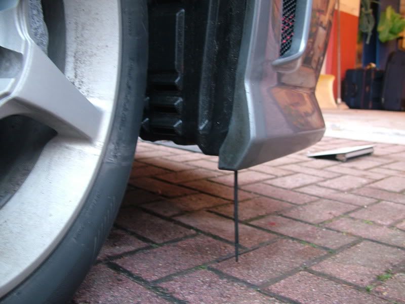

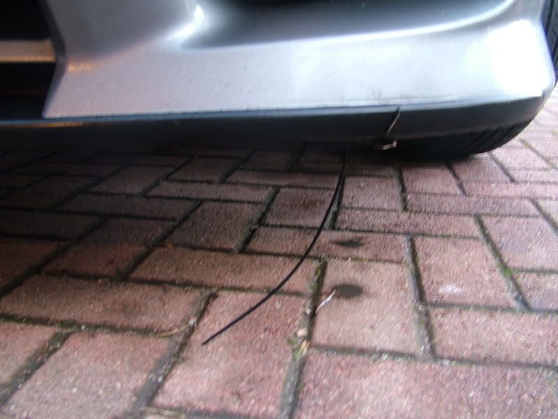

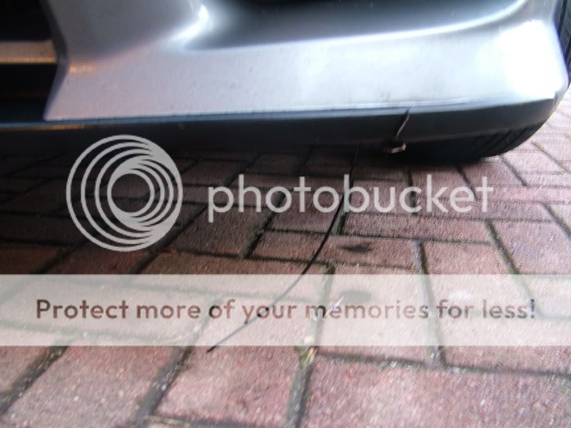

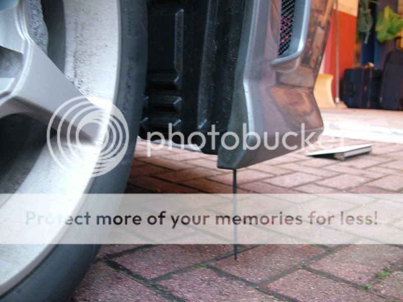

um.. yeah i lost some laquer and the paint is sorta cracked. I just tie wrapped it back together lol dori spec y0!
There is a small dent under the front fog light, a cracker the rear undertray on the pass side (t.rapd y0!) and the end of the bumper on the driver side that meets the inner arch is a bit bend outa shape but meh.. im not worried tbh.
Im going to get a new kit when im back from Japan so its all grand.
