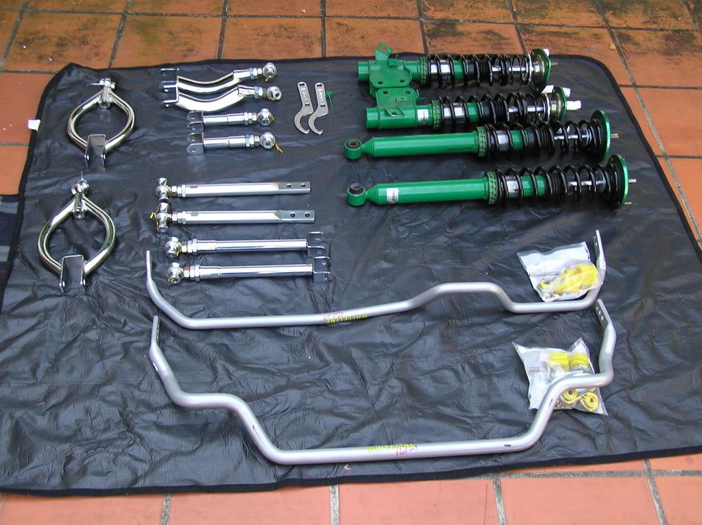

UPDATE: Been a while, but some new goodies are now fitted.
Tein superstreets (fulcrum modified), Whiteline swaybars and fully adjustable camber, caster and toe rods. The car is a lot firmer in ride quality, but not teeth shattering. The car has been lowered by about 1.25". Unfortunatley, I am nearly at the end of the ride height adjustment, but with new wheels, it should look awesome.

What's that two round ones??
Looks like rear upper arms for s13... but it looks like u have the s15 rear upper arms as well....
Yeah they are S13 rear upper camber arms. I don't know why he sent them too me. I suppose I will just sell them on ebay.

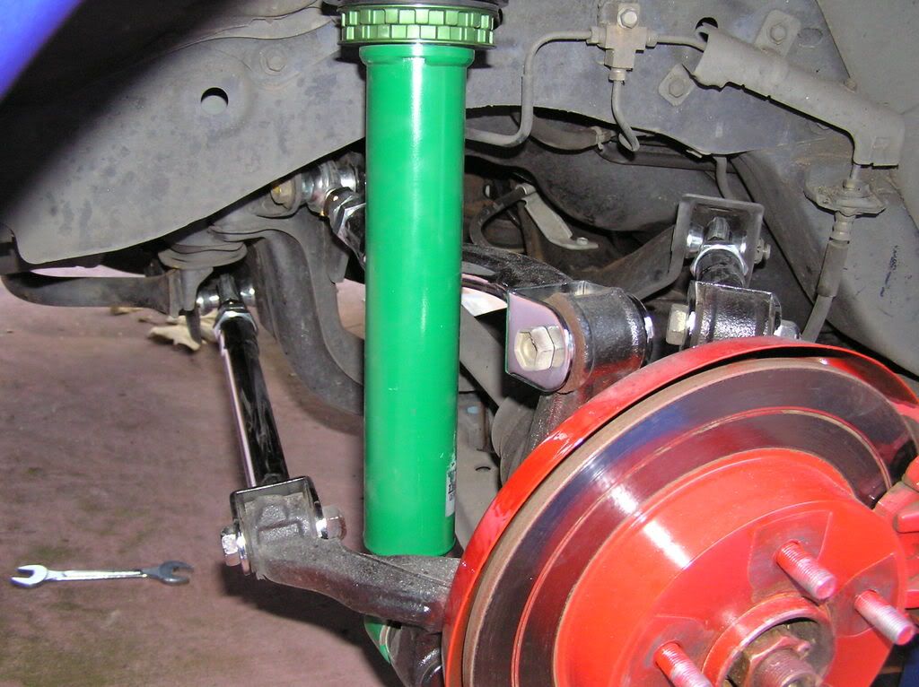

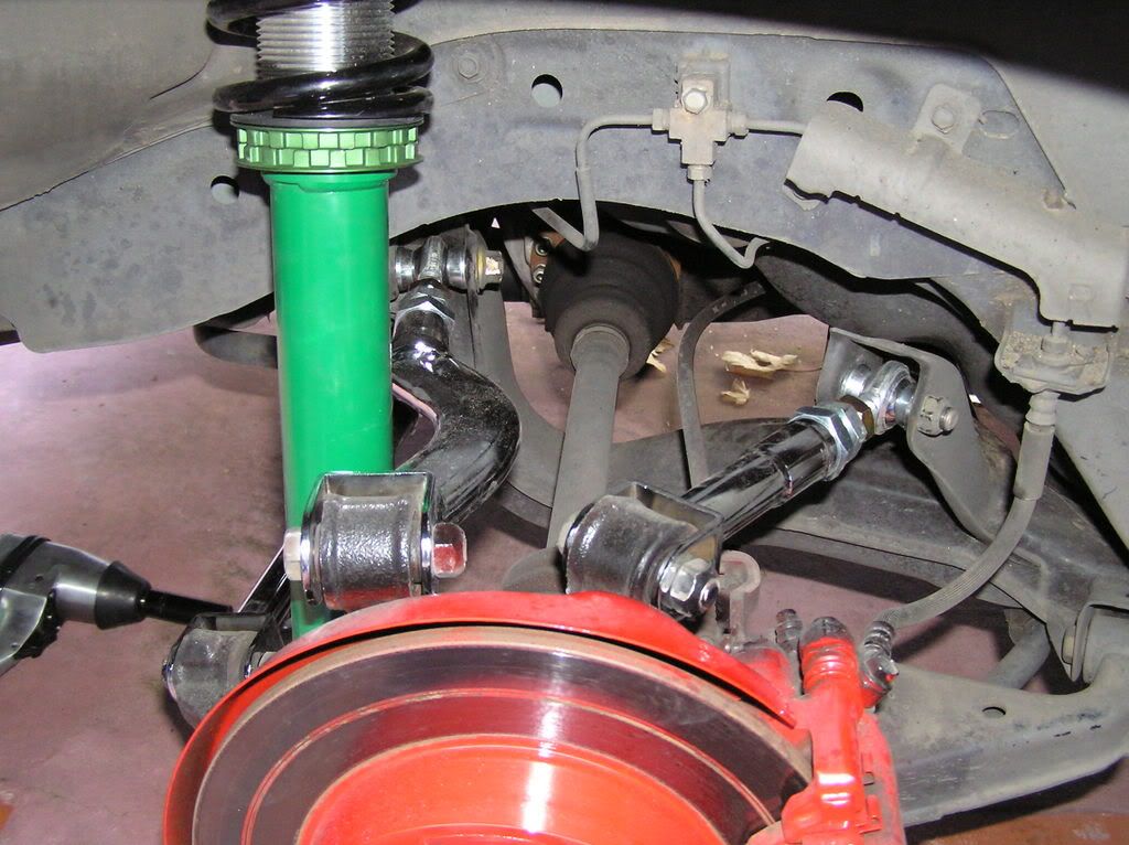

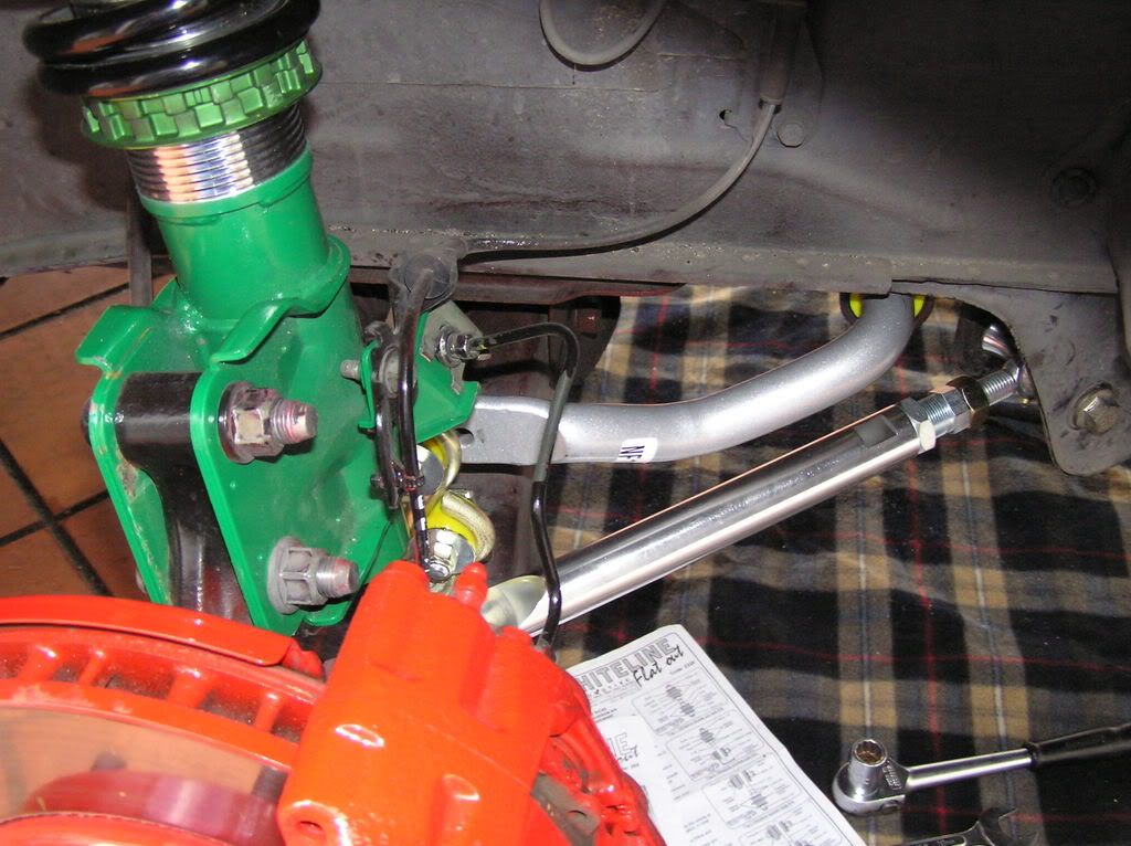

Here are some pics of my new suspension fitted, before the wheel alignment.
Please no comments about the red brake discs. It was done for free. Even still at that price I was not very happy, but atleast they won't get rusty. I will fix them up when I change the discs.
Rear Suspension
Front Suspension

How's the ride after the new goodies?
pretty good, but one of the rear toe arms squeeks. If could be that the bushings wern't as long as they should be. Once I make up some spacers, hopefully the squeek will go away.

Did you grease the sway bar bushes? I was getting an irritating squeek from my White Lines and it was cause the bushes were installed dry:rolleyes:
Nasty scoring on that rear disc...
Yeah, I have fixed that. There is a little paint in there which makes it more noticable.
Yep, I even regreased one this afternoon. It is definately the toe arm that is squeaking. The bushes are too short. Going to try to fix it tomorrow with some spacers / washers.
It must be the swaybar. I fixed the toe arm spacing and it still squeaks :mad:
I finally sorted the problem. The rose joint in the toe arm was the culprit. Lucky they have grease nipples on them. A quick squirt of grease to all the arms and they are a lot quieter. The other side had just started to squeak too.
