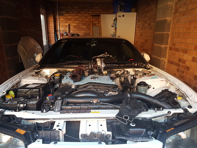

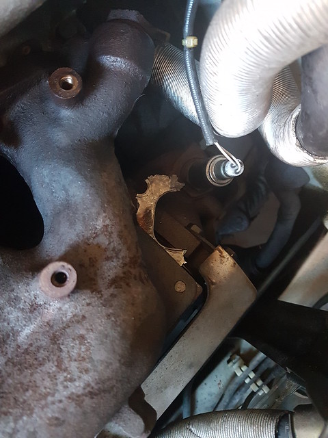

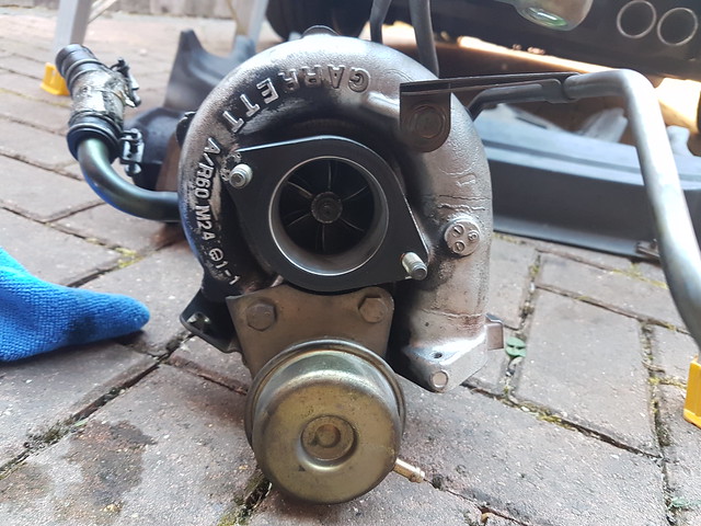

Over this winter, being such a long, cold and SALTY winter, she was SORNed for almost 6 months. It was awful! I got her MOT'd end of May and taxed her in June. I'm back at work again after mat leave so now it's just weekend fun. About 3 weeks ago I took the kids to a stream train in Llangollen - She was making a raspberry blowing sound which got progressively worse and so bad that on the way back I sounded like a Harley I'm sure of it! Got Yuki home and to my horror - blown a turbo gasket!

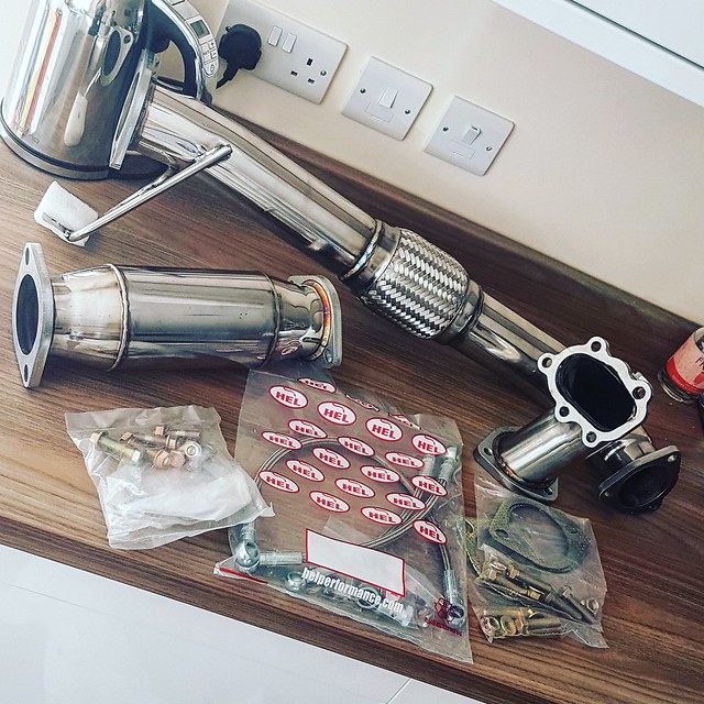

So, sort of a big job, air box, manifold, turbo etc off - well whilst it's off I guess I best make some changes! Again a limited budget (childcare grr!) but I got new Japspeed downpipes, sports cat, turbo elbow; copper turbo gaskets from Slide Motorsport, and some braided turbo lines from Jack Pilkington (HEL).

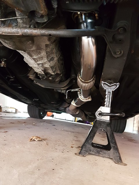

All fitted, and took the boys to Manchester airport last weekend and she flipping' flew! I don't know if it's actually given me much of a gain in power, or whether she's always been underpowered by a weeping gasket, but her response now under acceleration is breathtaking in comparison to what I've known! Honestly cannot describe how much more responsive she is, the fella isn't pulling away in his M3 now mwahahaha!

Top job.
What was the Japspeed stuff like to fit?
Lil SpecR
2 October 2015
401
STOKE-ON-TRENT
www.ejmcarphotography.co.uk
@lil_ej_x
Honestly?
Sh1t! :heh:
I was promised it would be fine and it was basically the same as the S14 so we would have no problems - (I double checked because I hate bodging stuff!) - no problems my assssss!
Probably didn't help I had the Flexi pipe rather than solid as that makes the circumference wider and puts it right against my floor, so had to get a spacer for the exhaust to step it away from the floorpan. It has all fitted nicely now with some tweaks, fortunately legit tweaks and no ****ty bodge jobs, but if you're looking for a straight forward easy 2 minute swap then you won't get it.
However, worth it in the end, Im more than happy with sound and performance :)
