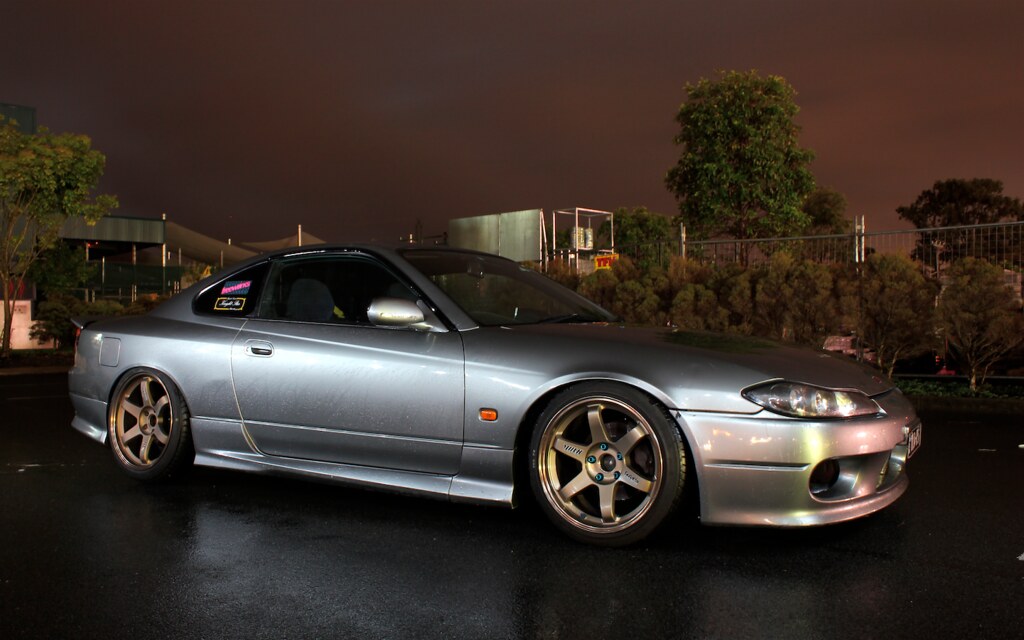

Hi! Just want to know how did you slam in 18x9 at the front? Did you do something to the front fenders? What are the offset of XD9s? BTW, nice ride bro~

Hi mate, just coilovers set low and the guards have been rolled with a bit of camber put into it. Be careful of your wiring loom... You might want to make a bash plate to protect it!

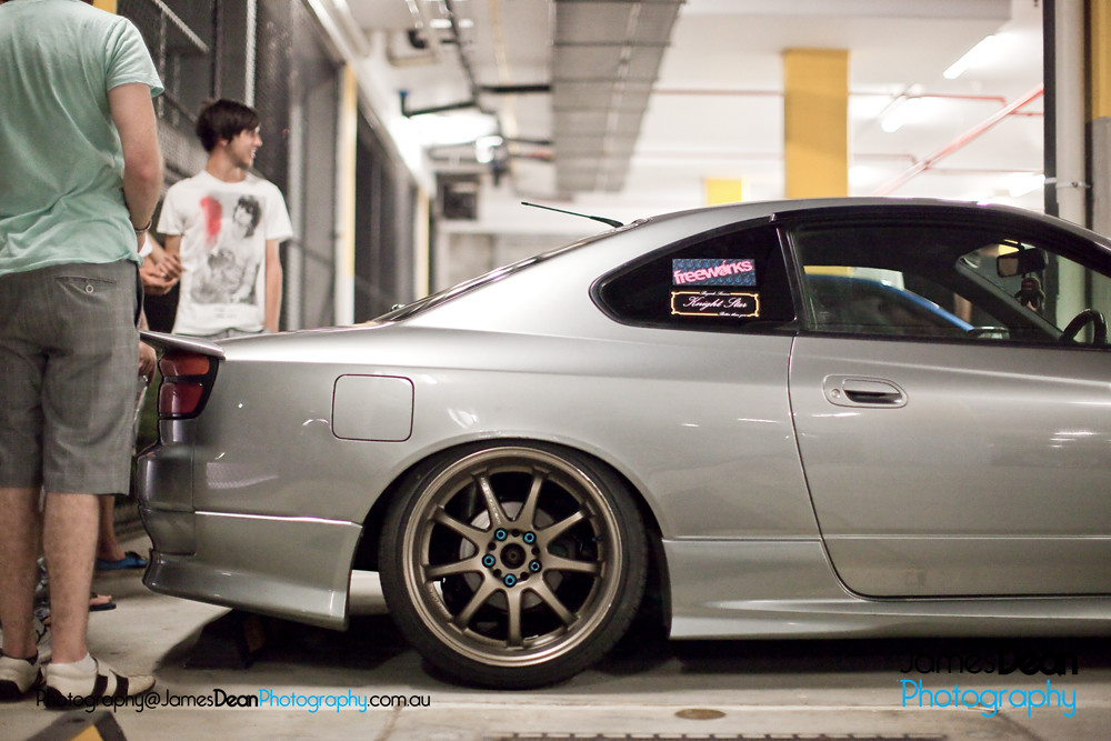

Here is a photo from the JDMSt meet from up here in Queensland
Just bought new wheels :) I think I'm going to get the rear guards worked on though as there is maybe just a bit too much camber :p
I am running 17x9.5 on the front and 18x9.5 on the rear :D Staggered FTW!
Sorry for the picture quality :p I will get some decent shots shortly...

Anyways, I am trying to work out the best way to remove camber out of the rear end... So far, I have these options:
Pull the guards out
Pump the guards 5-10mm
Sell my TE37's and get slightly higher offset wheels
Cut & Shut my Lower Control Arms 10mm to pull the bottom of the wheel in rather then trying to push the top of the wheel out
Thats about all I can think of at the moment. But yeah. -5ish degrees of camber on the rear is stupid, I have no traction in the rear end and I need grip to slide... If anyone has any other ideas, voice them out please!
