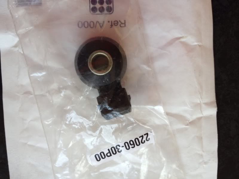

well i managed to get a new knock sensor for a decent price, so today i went at changing it.
in order to get to it, i remove the oil filter (excuse to do an oil change too) and also the alternator
after a lot of swearing i got it off, and pulled the loom up to the top of the engine to swap to the new sensor
refitted - tested - still throwing a code 34...........what to do!
I'd leave it where it's supposed to be mate as it'll be a very sensitive item and designed to be where Nissan fitted it.
Very interested to see if this cures your problems. Thank you for the photos and looking forward to the next update :)
Hopefully this will sort it mate... at least the more you work on the SR the more you understand and can diagnose faults in future! :thumbs:
