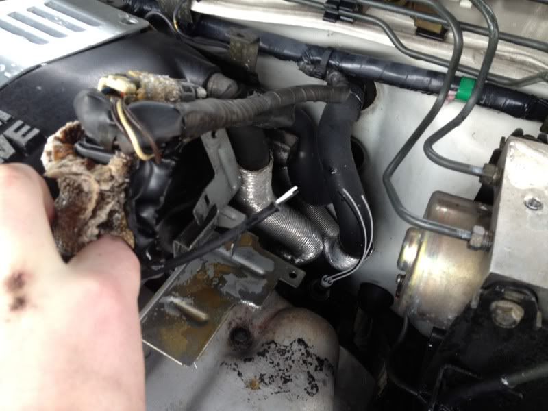

I proceeded to clean the engine bay, and as i moved a connector block, it revealed this
The 3 wires to the o2 sensor on the turbo elbow were broken.
Could i have found the problem? would the o2 sensor cause it to run like this?
I repaired the wires, 1 black wires and 2 white.
black to black, obviously, but the two white wires were not marked up. in the past on other cars i have replaced faulty o2 sensors with a universal o2 sensor, and the white wires do not seem to matter where you connect them.
I test drove it again and it hadnt seemed to of made a difference. maybe the o2 sensor is faulty/white wires not wired correctly.

That 'possibly duff' o2 sensor wouldn't cause this type of fault?
O2 sensor wouldnt cause that sort of issue. Just unplug it and try again to eliminate it.
