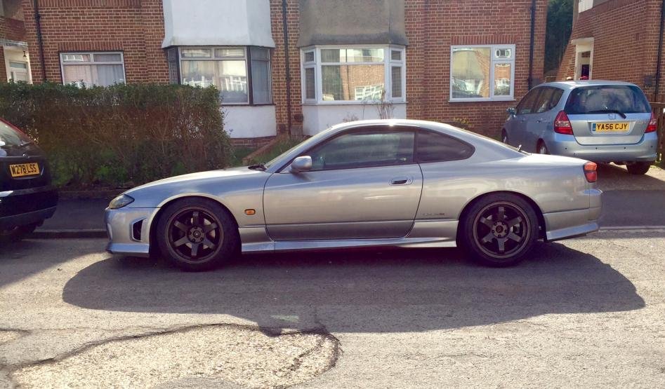

Thought I'd update with a pic and a list of things I've done (for reference)
-switched wheels to Rota grid 17x9's
-New tyres fitted (235/45/17 & 245/45/17 Goodyear Eagle F1 AS2's & Hankook V12 EVO's respectively)
-fitted HSD monopros
-switched springs to 5/4kg
-fitted whiteline ARBs
-fitted a cheap stereo
-fitted defi guage using oem wiring
-fitted gizzmo EBC
-changed engine and gearbox oil (Millers Oils NANODRIVE CFS 5w-40 NT Full Synthetic Engine Oil & Silkolene Comp Gear 80w-90 Semi-Synthetic Ester Racing Gear Oil)
-fitted Nismo clocks
-changed interior gear stick
-changed gear stick gaitor
-changed center dash surround
-added silencer to exhaust

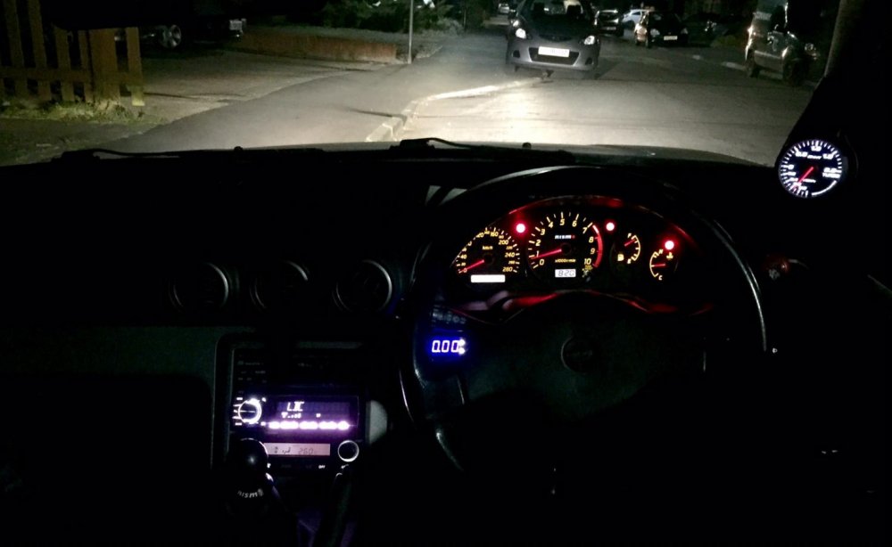

See attachments for current progress including driver view complete with S13 wheel and LBC on the radio for street creds init bruv!
next things to do:
-double din OEM look stereo from Qashqai
-subframe bush replacement
-turbo oil and water feeds/drains replace with braided hoses
-dash replace
-interior steering wheel retrim (received today, but sent back to be re-done sadly)
-switch seats for minty ones
-sound proof the whole thing so it doesn't squeak and road/exhaust noise doesn't drive me wild.
-find driver side undertray piece and fit
-add mesh to holes where fog lights would go
-walbro
-maaaaaybe FMIC :)
