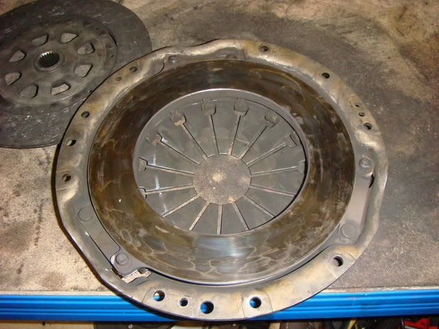

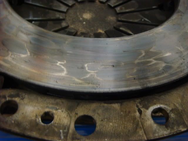

You may well need to skim the fly exactly as andeeps pics and report from the engineers proves :) nothing serious needed although "mild clutch kicking" doesn't exist...

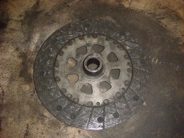

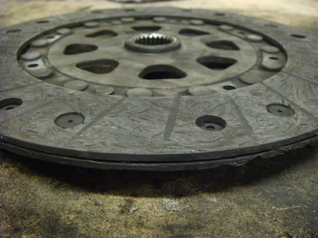

Got the flywheel back from machining, they took 1.225mm off it. The flywheel was warped quite badly and the surface had a bow in it. There are heat marks in it, but the surface is perfectly flat.
Before:
Good pics and nice to prove to people that of course you can skim the thing it just depends on your equipment. Mine was identical. I put that down to driving it for 100 miles before getting it changed. Sometimes still wanting it to be ok and driving like normal giving full acceleration; it slipping around peak torque and looking at the revs thinking "oh bugger it really does need changing" as they slowly dropped to meet gearbox speed. :)
