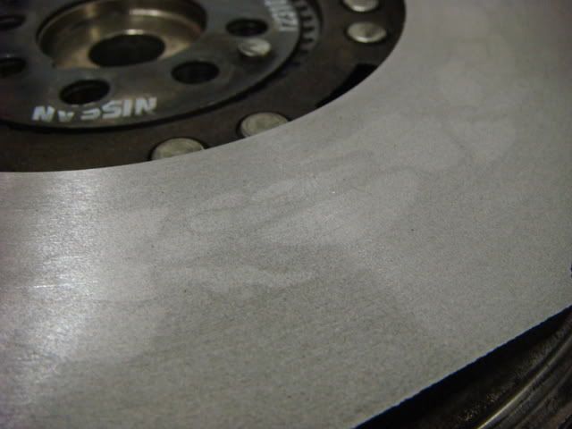

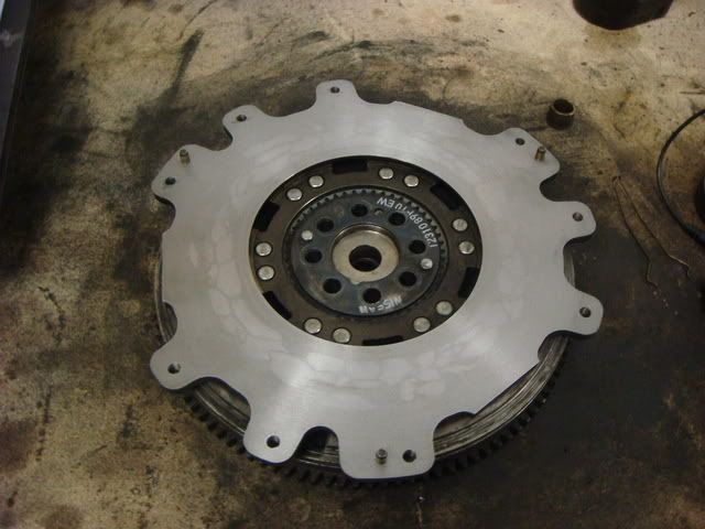

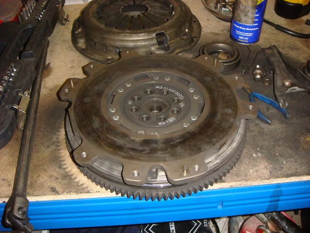

Got the flywheel back from machining, they took 1.225mm off it. The flywheel was warped quite badly and the surface had a bow in it. There are heat marks in it, but the surface is perfectly flat.
Before:
After:
What were you doing to get it that hot? Or do you think it was like that before you got it?

Only thing I can think of is some mild clutch kicking. But for all I know, it could have been in bad condition from the previous owner in Japan.
I clutch kicked loads before my OEM clutch went (and even took it to DWYB). The clutch dies over time but the flywheel should remain ok... my dual mass never needed skimming or showed warping when I (mistakenly) changed it for another entry level Exedy.
I'd say the previous owner prob couldn't drive and put some serious heat into the baby lol...
