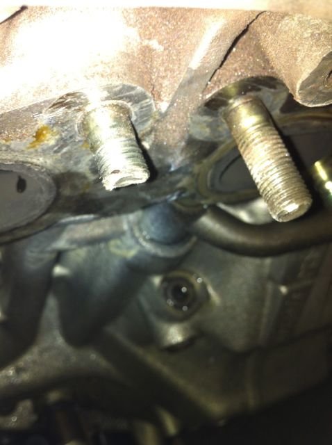

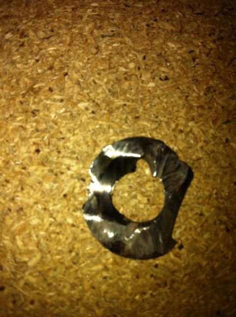

Finally got that last nut off today. Tried a few things and ended up angle grinding and dremmeling it. Was actually surprised when it dropped off.
This is all that was left of the nut.
Sadly though the stud had had it and snapped.
How best to get this off. From my research a bad idea would be to use the easy out as they appear to do more harm than good. I (I think) fortunatly have a fair bit of the stud and a lil bit of thread sticking out.

It depends on how tight it is, i had one snap off at the end of the thread end tried a stud extractor and hung off it with a bar didn't shift it, i ended up filing it flat and re cutting
the thread on it and just re used it, but thats never going to happen for you lol.
i'd try a stud extractor or if you can get 2 nuts on it try that method.

I did try to get 2 nuts on but only 1 would fit. If I can get thinner nuts that might work. This would be my prefered option I think.
I've read so many stories of the extractors breaking in the stud and apparently its not easy to weld to it if that happens.
I just really don't wanna balls it up like I did the nut. If I can help it that is.
