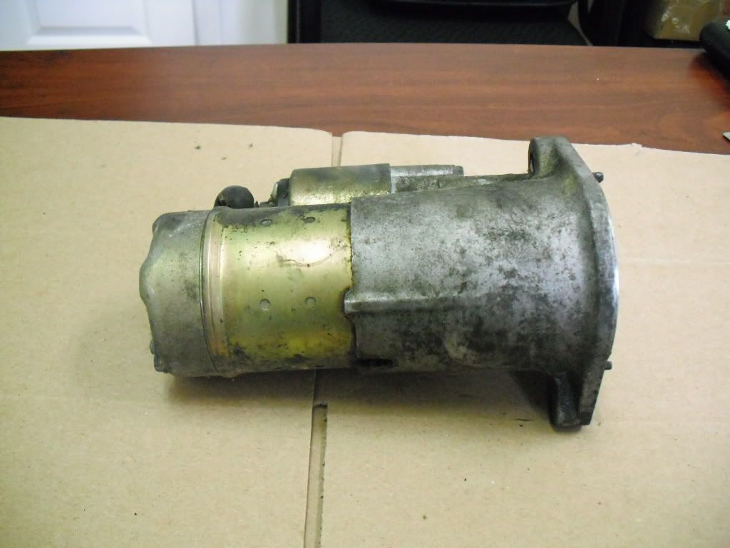

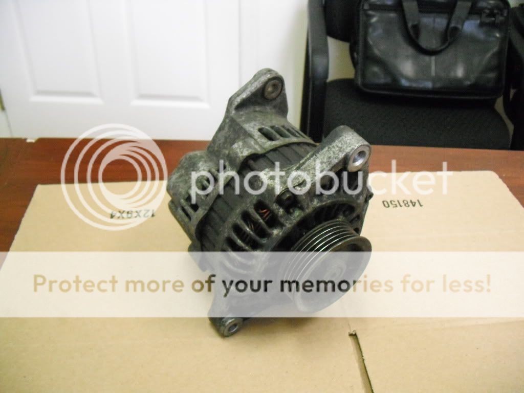

Little update,

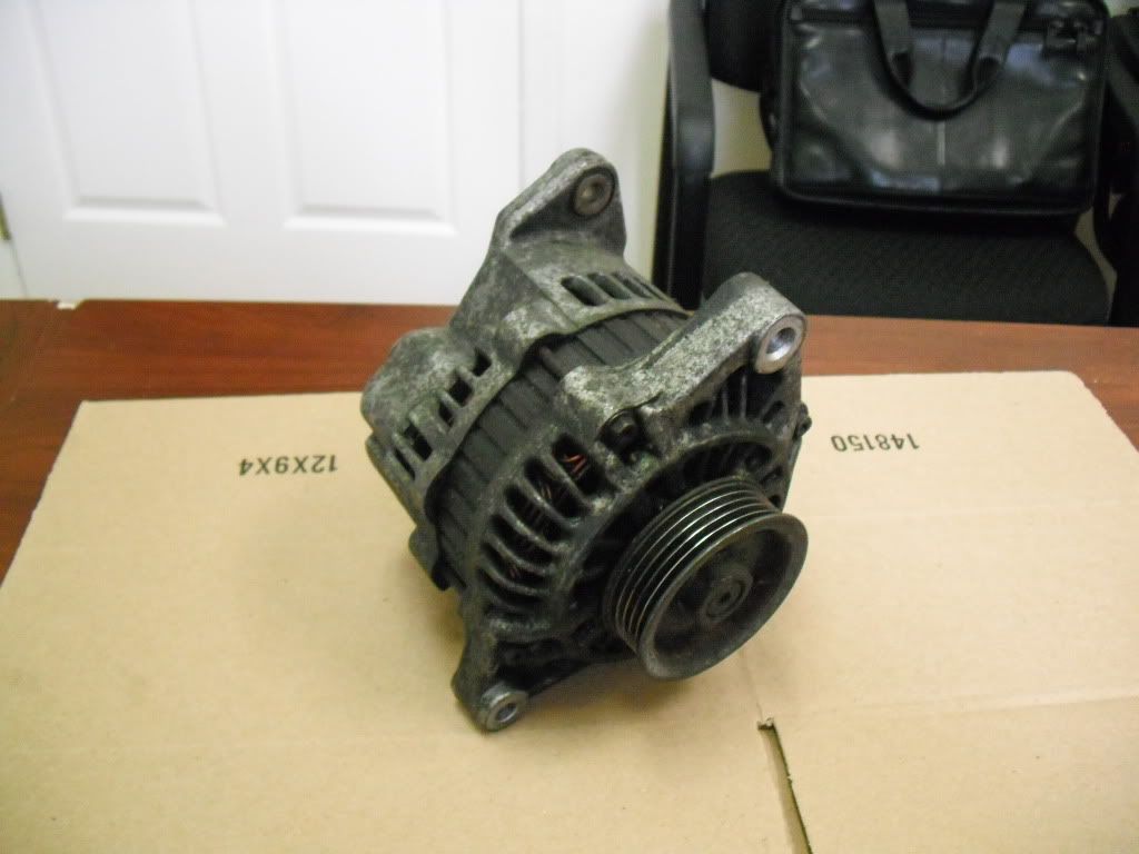

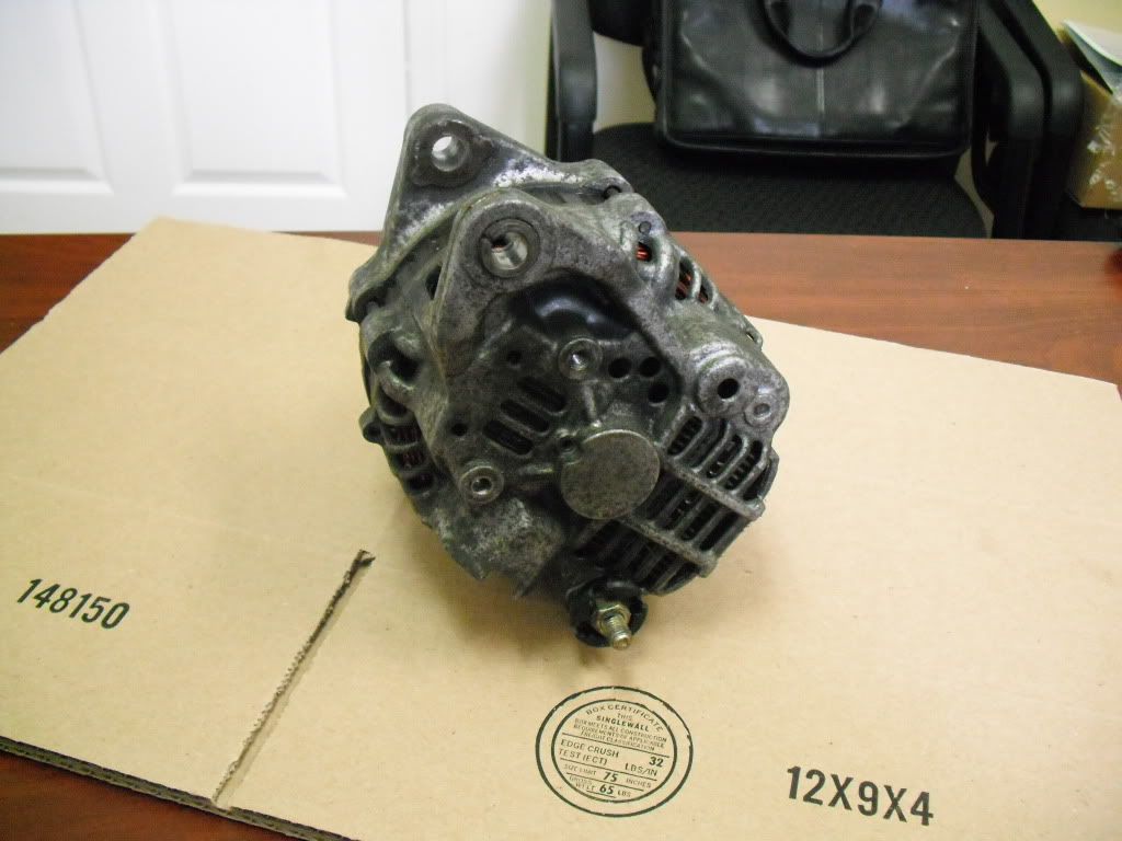

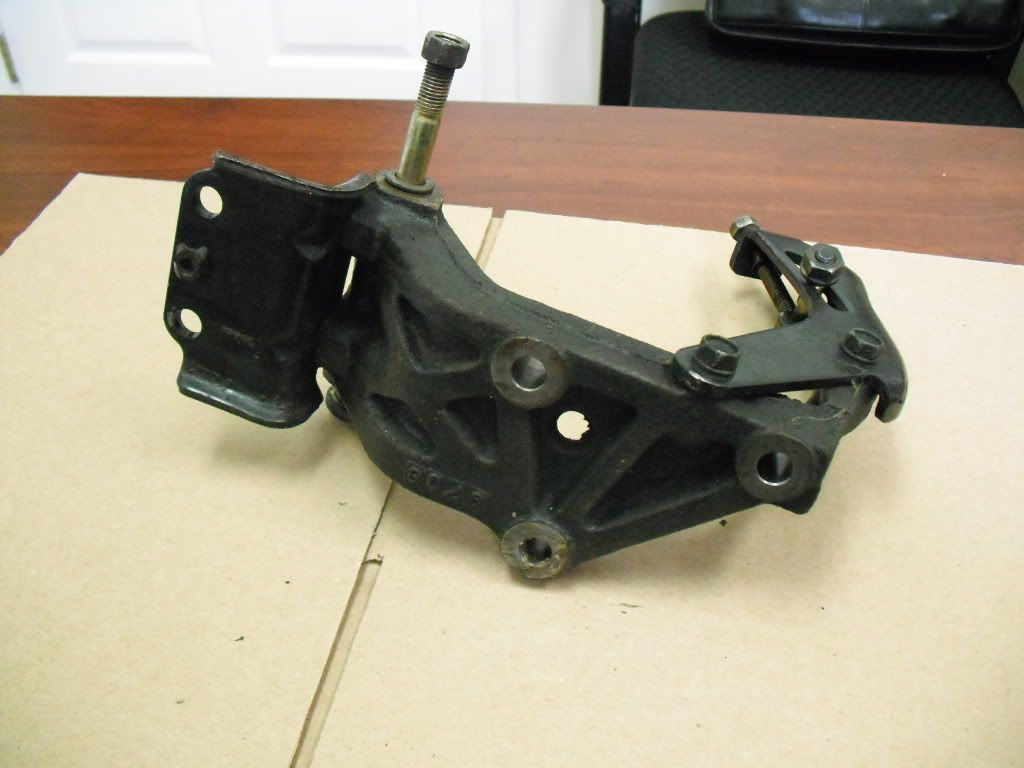

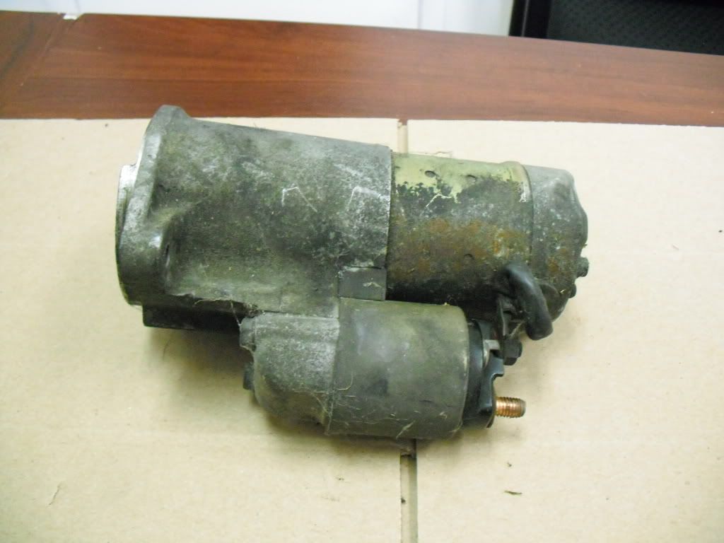

I've sourced a spare S15 Alternator and Starter Motor, both going off for metal polishing and the alternator bracket is going out for a powder coat.
Before
All pretty horrible, hopefully they will come back a bit more shiny :)

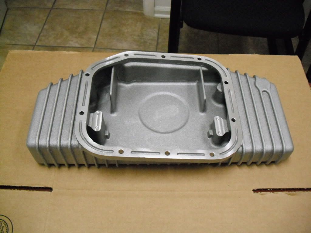

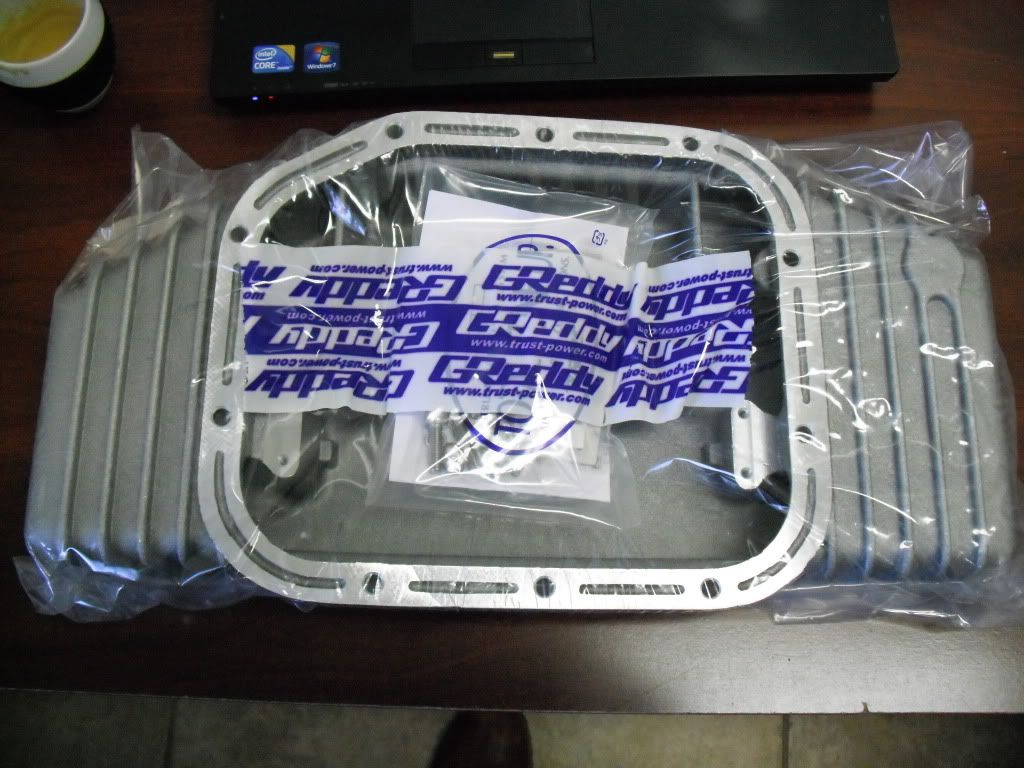

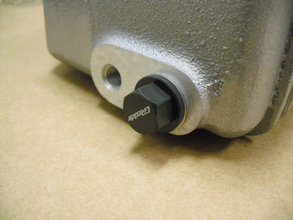

Greddy Oil Pan

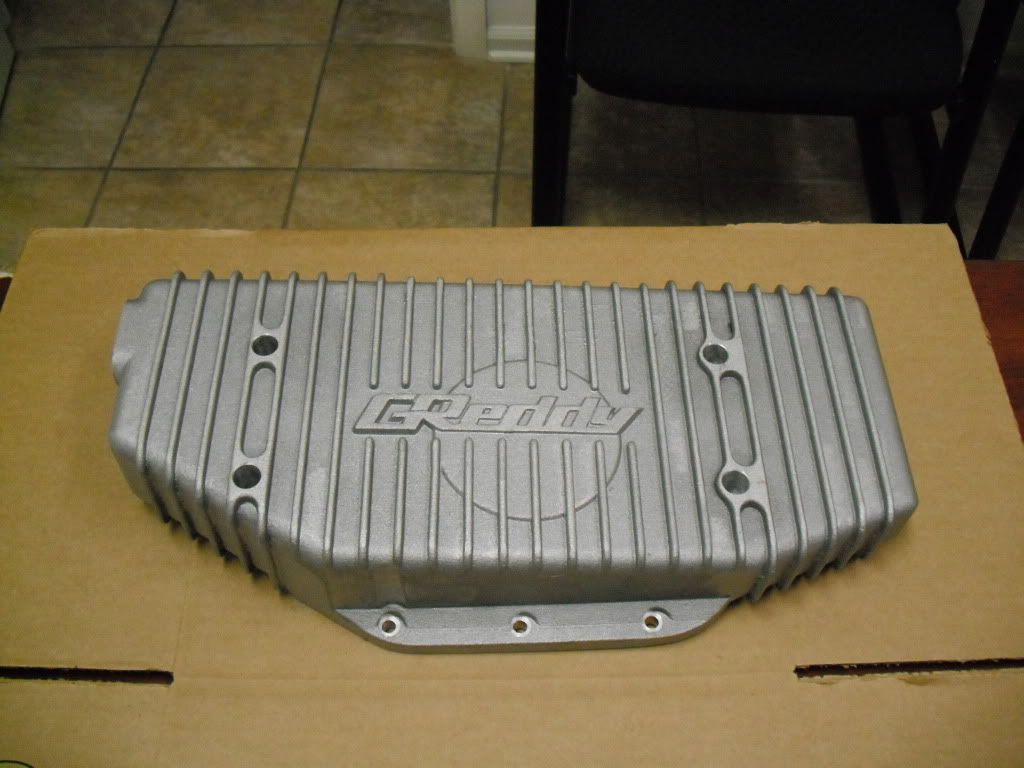

Some new parts arrived today
Greddy Oil Pan

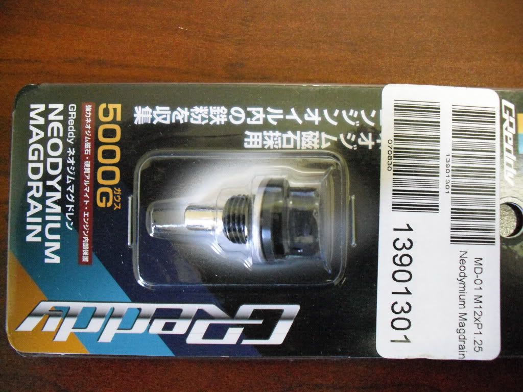

And Greddy magnetic drain plug
Got a bit of a shock with the quote for the alternator and starter metal polishing, but going to get it done anyway, alternator going off first (shipping Monday) should be turned around in a week so we'll see if i've had my pants down or not

Alternators a difficult one to find, did try to find one too but the only one found was more than a dollars if I recall right.
Well done mate looking forward to your next update!
13 July 2010
567
12
Brighton-UK
I was lucky, the guy I bought the block and head off was also selling an S15 alternator and starter motor so I had those off him :) Plus a complete intake manifold with tps and injectors, no idea what to do with that now, lol.

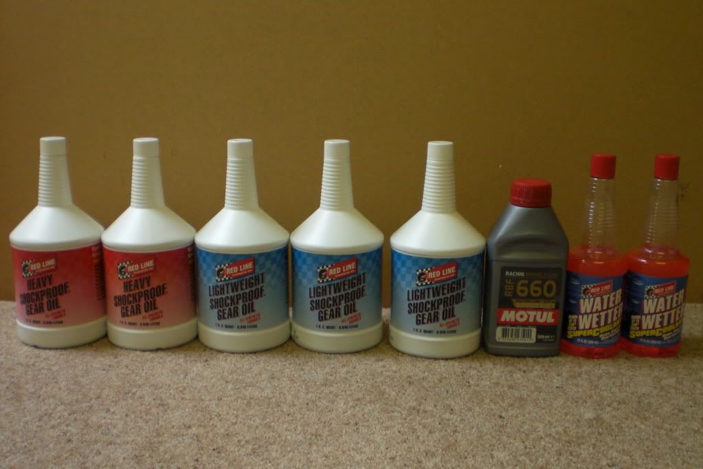

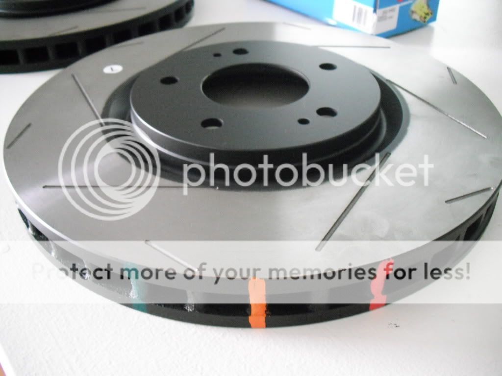

A few more parts to go on before Christmas, plus it's due for a service so i've got in a full set of fluids for the service.

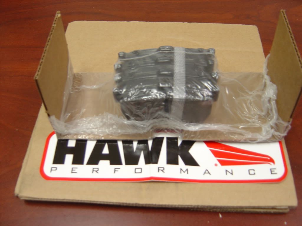

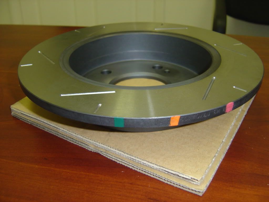

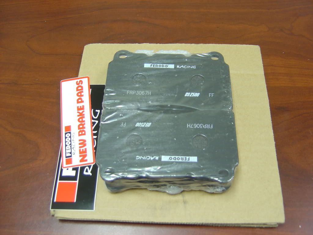

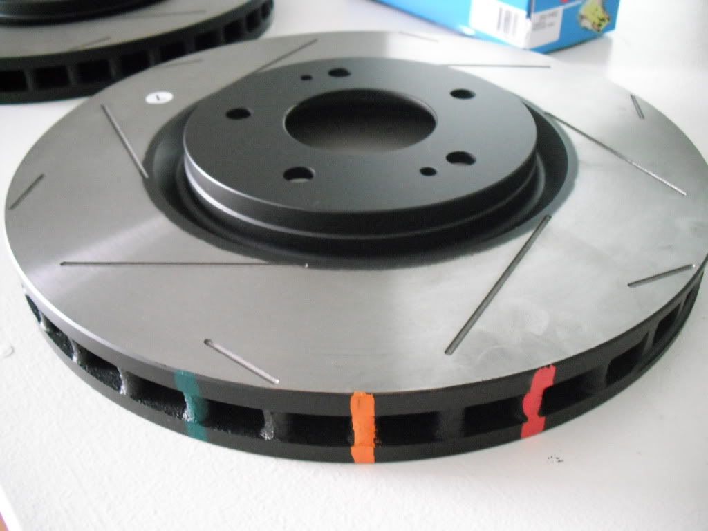

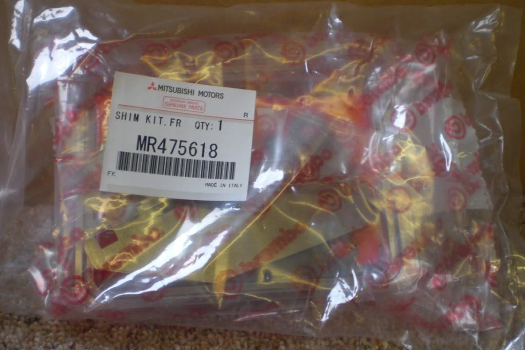

I bought a set of Evo calipers before I decided on the more powerful build, so it looks like eventualy i'll need to go with something like a K-Sport 8pot/6pot with Z32 handbrake set up, but for now i'm going to fit the Evo calipers, bought a nice set of DBA4000 disks (front and rear), Ferrodo DS2500 for the front and some Hawk pads for the rear, had ordered Project Mu HC+ allround but after waiting 4 months for them and then being told it might be another 2 I just cancelled the order and went with these.
My Evo mates also convinced me to buy anti-squeel shims so got these as well.

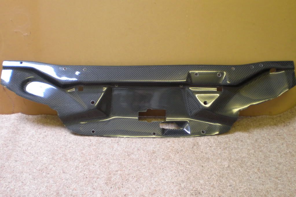

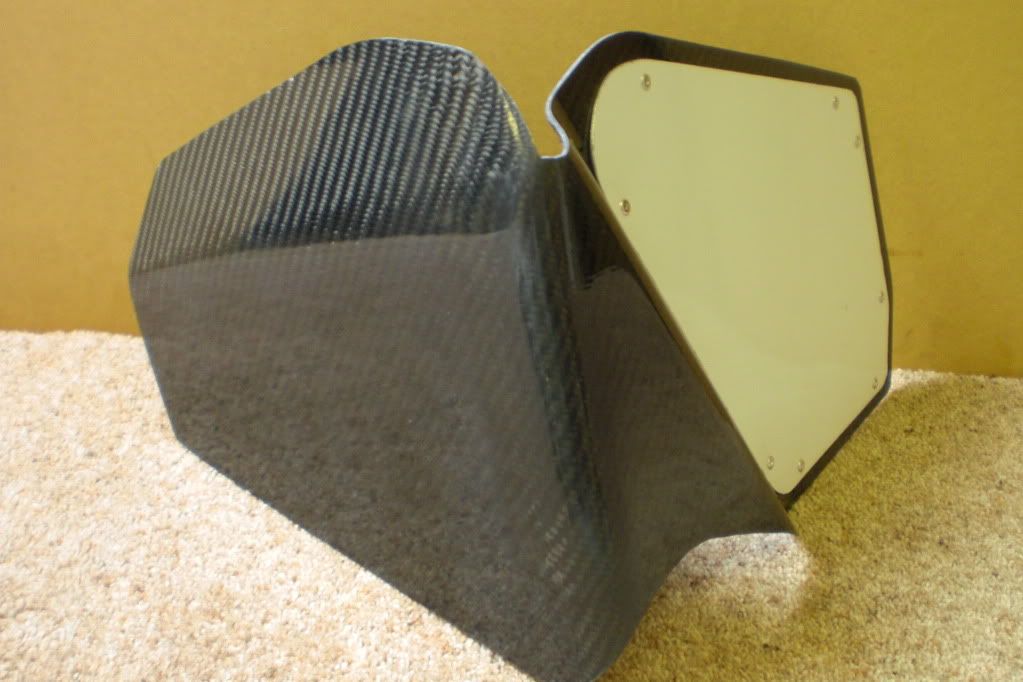

CF ABS Shield (Cheers Craig)
CF Cooling Panel (Cheers Craig)
DBA4000 Fronts
DBA4000 Rears

Hawk

Service Fluids

Are the shims a mitsubishi part or do you order them through brembo my evo calipers are a bit creaky? Those disks look quality mate!Awesome mate! I have blue defi's they looks the nuts!
