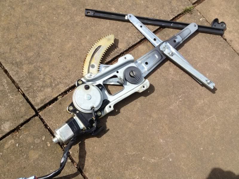

There was still some light left so i managed to replace the kaput drivers side window motor.
i sourced the replacement from japperformanceparts

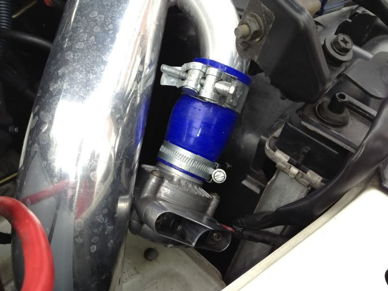

I also thought i'd fit my SARD R2D2 BOV. i didn't plan to fit it, as i love the chatter, but thought i'd give it a whirl.
extremely happy with it, still chatters as before, and only blows off on high boost. perfect.

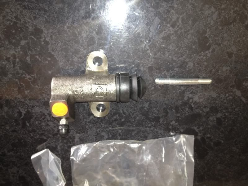

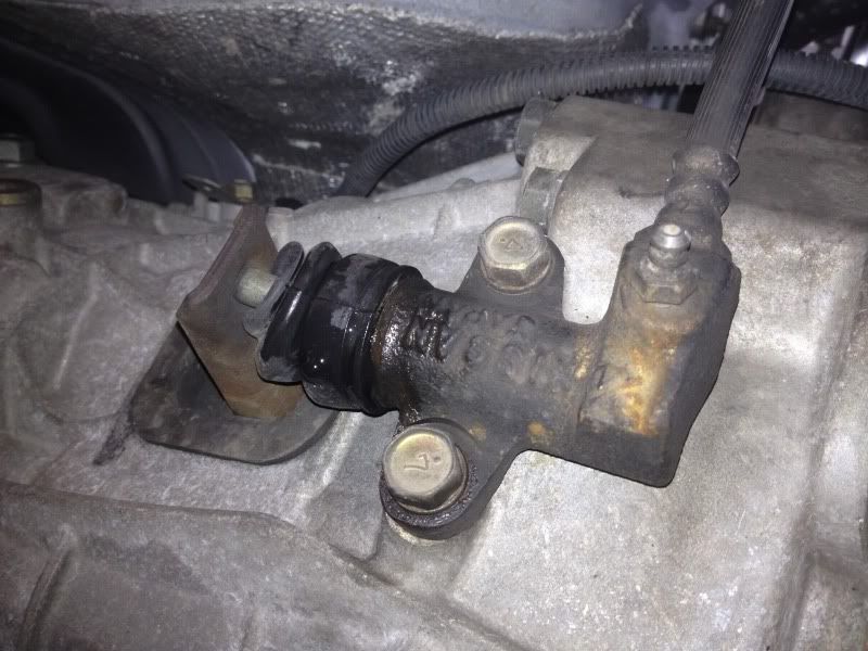

After a couple of weeks trouble free driving, yesterday i jumped in her to go to work. pressed the clutch in, tried to engage 1st gear - denied.
The clutch wasn't disengaging. with no time to investigate, i took my A3 and headed to work. a night shift of contemplating the worst case scenario's lol, first thing when i got back, took a quick look at the slave cylinder oil reservoir, happily confirming my theory of a leaking slave cylinder.

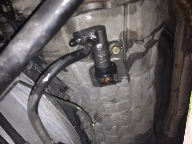

Ordered the replacement, thanks to 'spoonman' for the part number, and it was ready to collect today, so i went about fitting it.
oil residue confirming the fault
within 15 minutes it was swapped over, bled and ready for testing
Now the gear change feels a lot more precise, which leads me to believe it was leaking for some time.

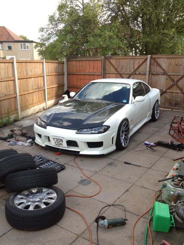

Been a while since i updated.
well, it has become my daily for the time being, as my 'reliable' A3 TDI daily is kaput. so i haven't been able to have it off the road for any period of time to work on her.

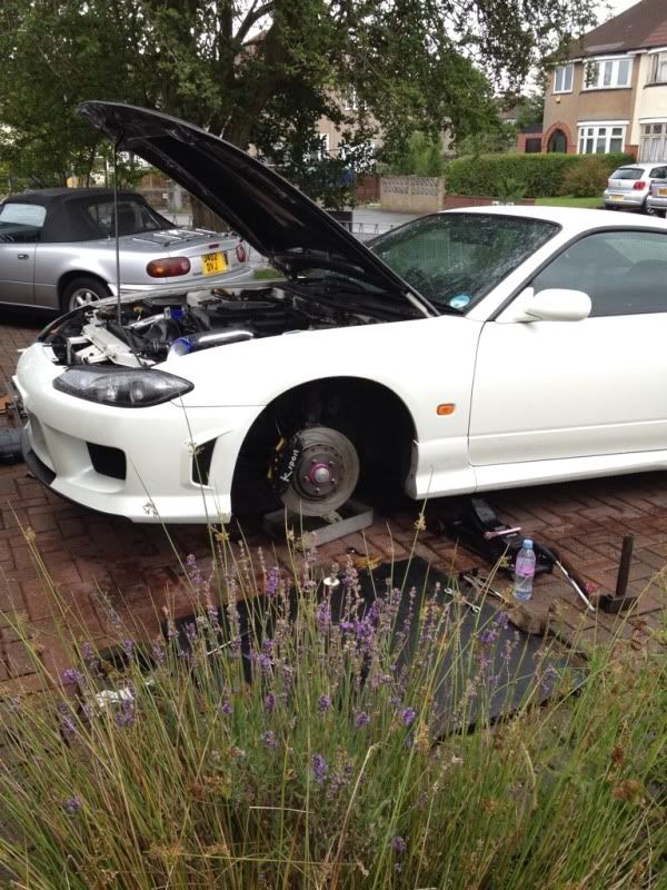

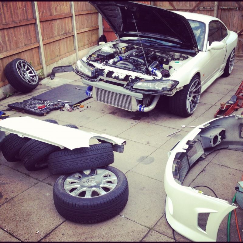

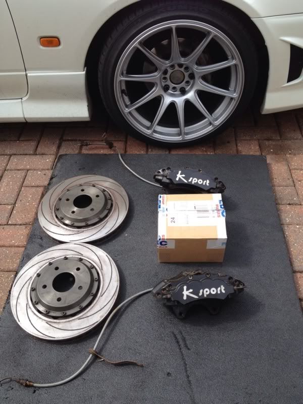

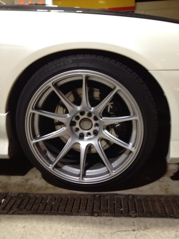

booked some time off work either side of my Holiday so finally had time to fit the K-Sport front brake setup, & EBC Yellow Stuff Pads.
Pretty straight forward fitting them.
all back together
not as impressive with 18" wheels :rotfl:
overall very happy with them as iv'e been bedding the yellow stuff pads in, night and day difference with the oem setup.
i will bleed them once again as the pedal feels a little spongy still.

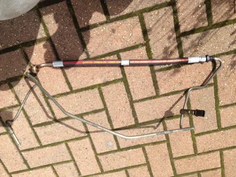

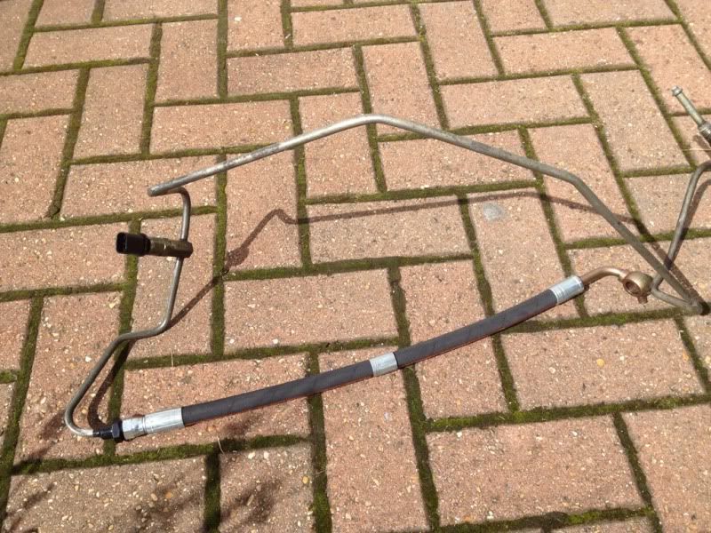

I also repaired the leaking power steering pipe.
it was a bit of a fiddly job as it ran down from the pump, along the underside of the subframe, and up to the steering rack. instead of finding a new or second hand one, i decided to go see the guys at Pirtek. they replaced the piping, and even gave me a joint in it, to ease re-fitting. Brilliant job

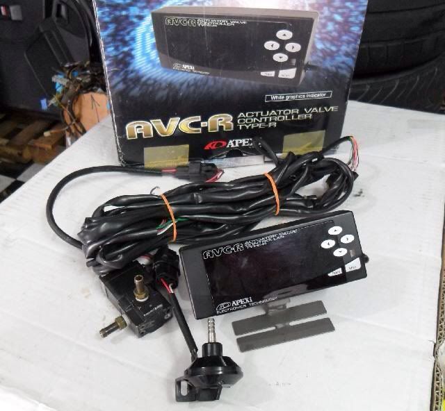

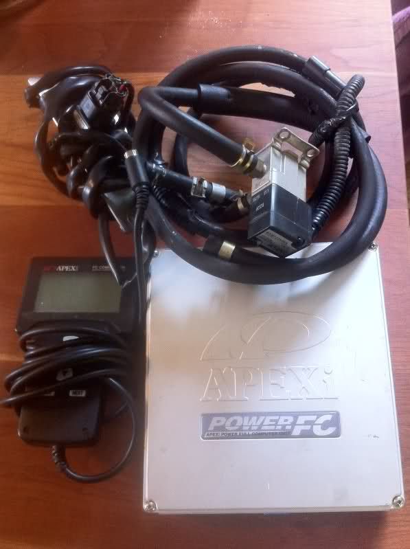

Now, as most of us i'm sure, I've got bored of the standard power. after searching for a few weeks, i managed to nab a mint condition Apexi AVC-R Black Edition
and also an Apexi Power FC with Hand Controller, & optional boost control kit. I will be selling the boost control kit as i wont need it with the AVC-R.
next on the 'to do list' -
fit walbro 255 fuel pump & apexi avc-r. i will mounting the avc-r flush in the dash, to the right of the steering wheel, in a custom panel, which hopefully will go nicely with the rest of the interior.

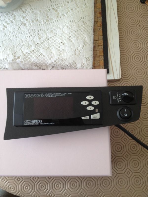

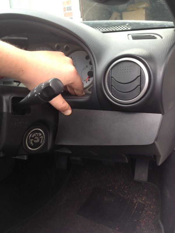

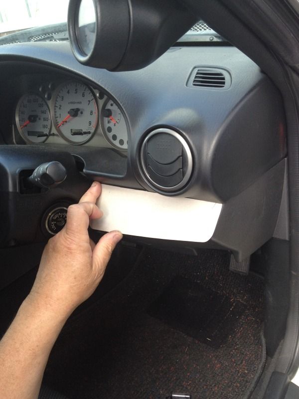

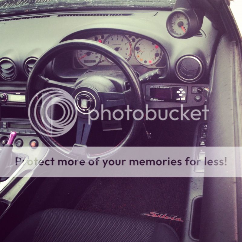

Fitted my Apexi AVC-R Black Edition last weekend, incorporating the controller into the lower rhd of the dash.

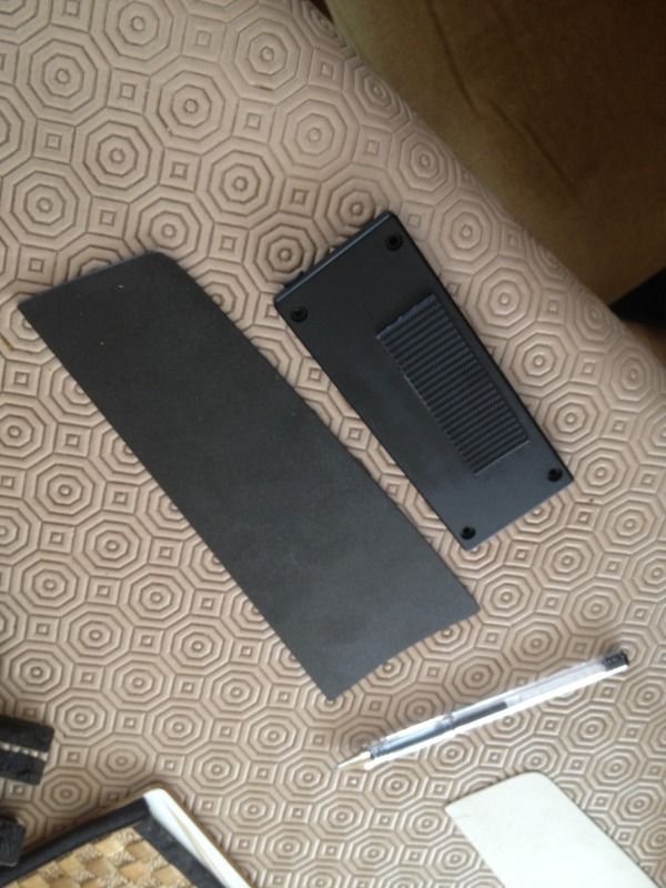

I made a surround to house the AVC-R, the headlight angle switch, and the rear foglight switch.
First i made a template out of card
then cut the plastic
then to accurately cut the hole for the AVC-R, i removed the back of the unit, and traced around it
i then cut the hole for the headlight angle switch, and drilled the hole for the foglight
not being happy with the lower section of the panel, i remade it with a bigger lower overhang. i then cut the hole in the dash, and it was finished

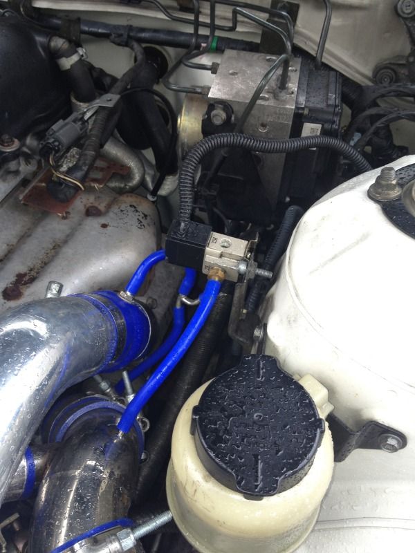

the pressure sensor
the boost solenoid

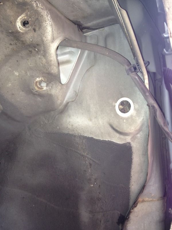

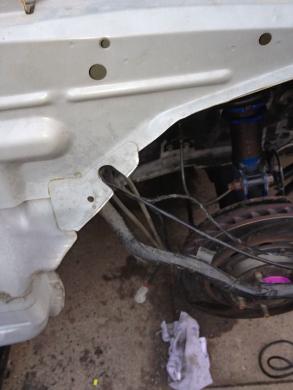

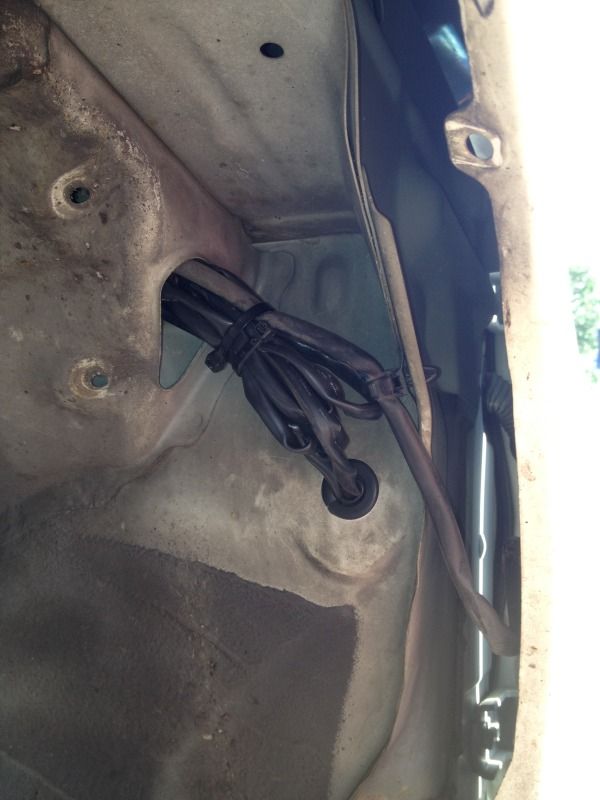

now it was time to run the loom to the ecu
i removed the passenger front wheel, and splash guard, to reveal a nicely placed grommet.
i used a screwdriver to poke through the sound deadening, and fed the wires through
wrapping up the excess wire, and storing it out of harms way

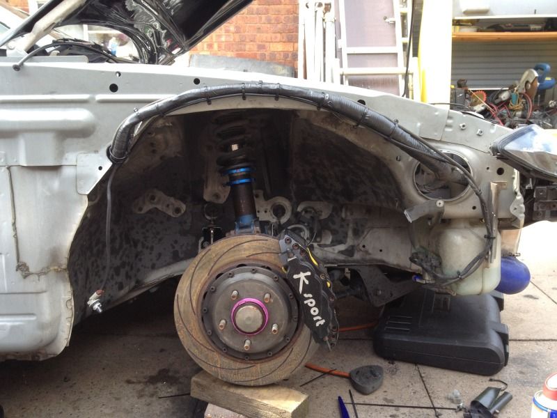

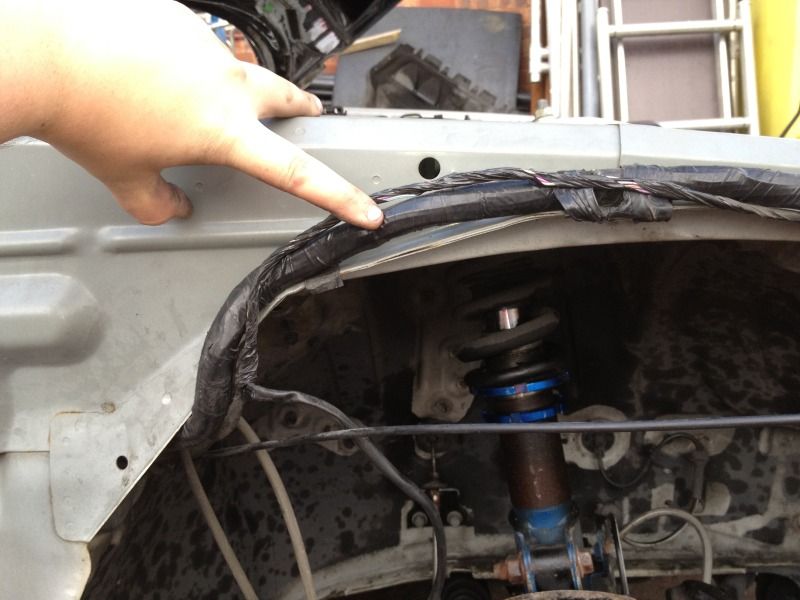

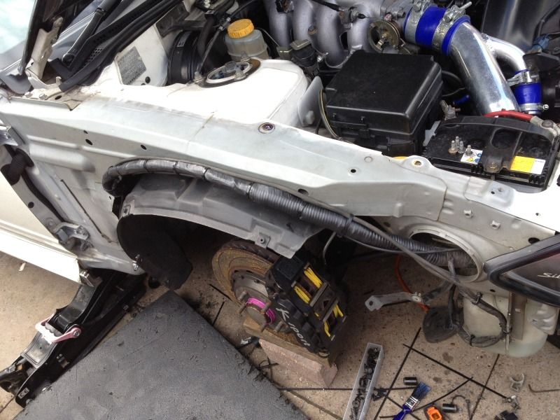

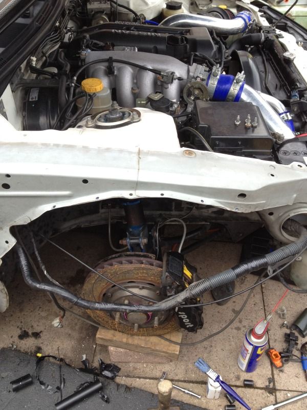

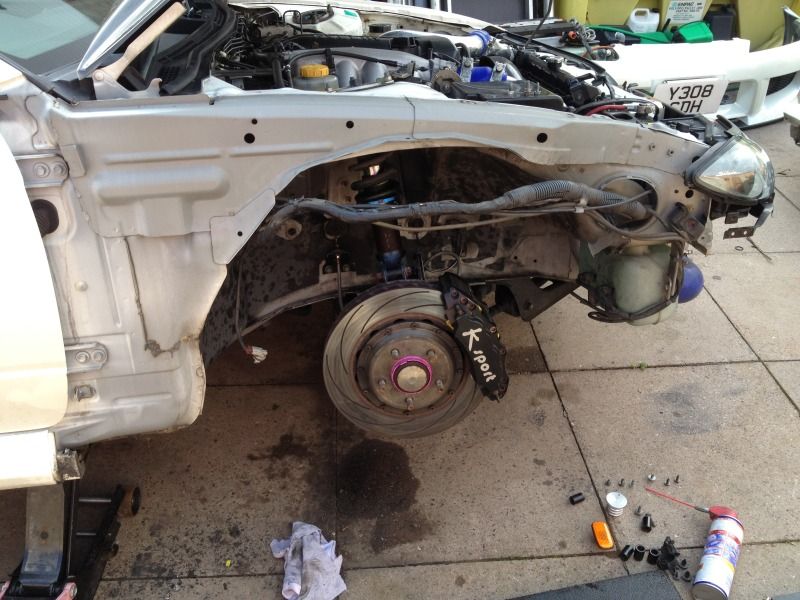

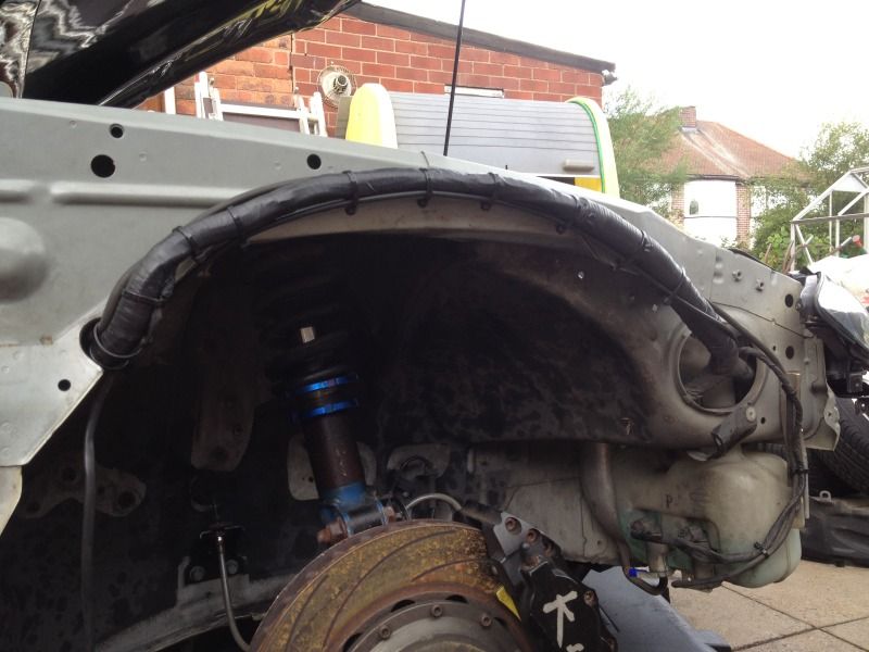

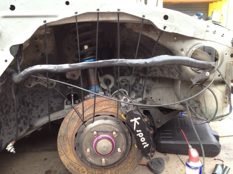

next on the to do list was to relocate the loom that ran in the drivers front arch
up bright and early to get to work
i removed all clips and cable ties to see how much slack was available, and at the same time sprayed the coilovers with WD40 to free them up for lowering later on :thumbs:
there was a sufficient slack to be able to run it above the 'ledge', well out of the way

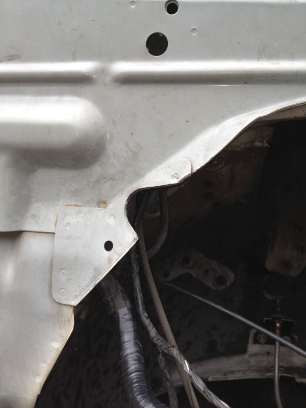

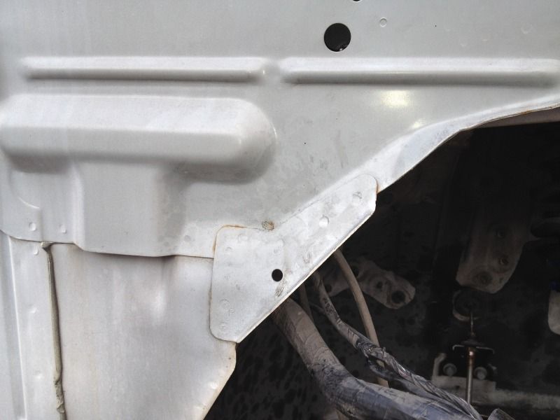

now to make it work, i would have to modify this plate for the loom to exit the arch, and run along the ledge
first off i drilled it out
then cut a slot
i then hammered the 'tab' around as opposed to cutting it, to retain it's strength.
I then cut the desired finished slot, chamfering the edges to not damage the loom once its in place.
i painted all the bare metal with kurust to protect it
next was to drill holes in the ledge to enable me to use cable ties to secure the loom
again, covering the newly bare metal in kurust.
And also wrapping the whole section of loom in electrical tape for added protection.
and rest......
very happy with the end result, fits perfectly. that's how it should of been done from the factory Nissan!

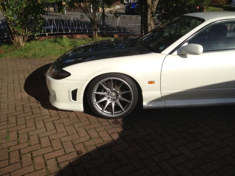

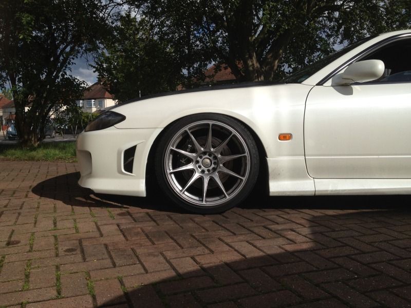

next up, was to lower the front a little more. i wound down the coilovers around 25mm, which turned out to be a little low
The wheel now caught on the spring, as it happened i had some 5mm spacers lying about so fitted them to clear the coilover
this now meant the tyres caught the arch a little, as cool as it looked it had to go higher
i raised her up just enough to clear the spring, removed the spacer, and it was now ok

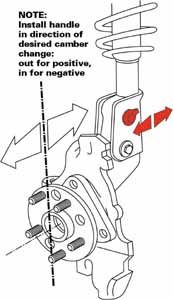

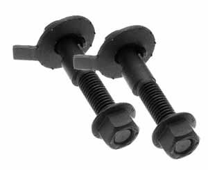

taking it for a quick test drive, on big bumps in the road it would catch the arch slightly. with the top mounts maxed out on camber already, i decided to order these, to give me a little more to play with
Eibach Camber Bolts
They use a smaller diameter bolt to oem, and have an eccentric cam, that allows you to adjust your camber settings. this should sort out the rubbing issue.

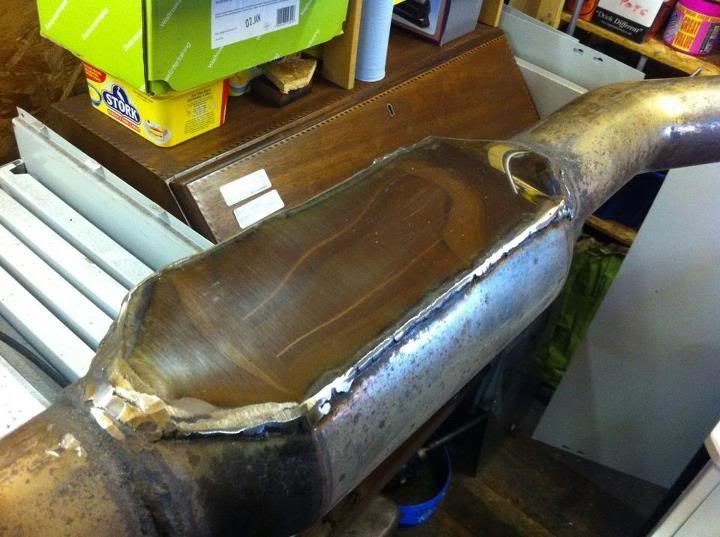

having the middle box removed, leaving just the back box silencer, i think will be a little too loud. but what other alternatives are there for getting more ground clearance?
CMR
22 August 2011
417
Yorkshire, UK
I got the centre box cut out on mine, and it was stupidly loud so got it welded back in. It only scrapes on speed bumps and when going some down country roads and I'm as low as you are so I'm just living with it. The only exhaust getting it cut out of works with is the HKS Silent hi power, as the backbox is just full of deadening so doesnt put the noise up too much, but I can't be bothered buying another exhaust.

As for the centre box, one of my mates cut his centre box in half length ways and welded a piece of flat sheet to the bottom...had great clearance and still silenced as normal..
