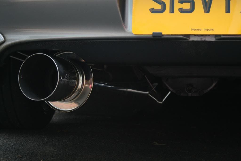

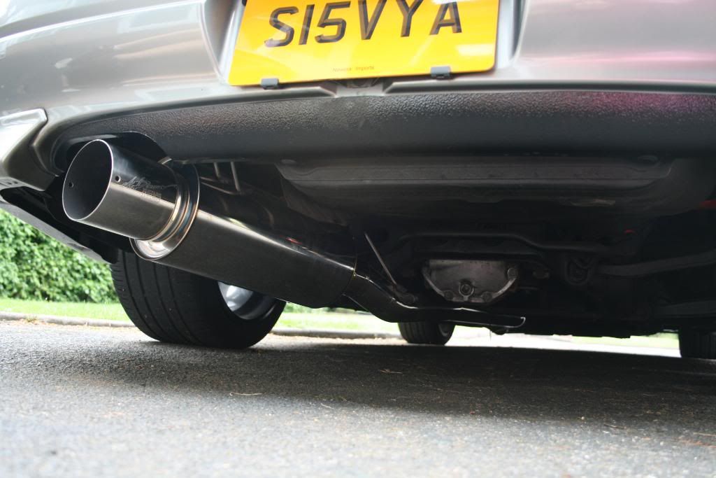

Exhaust update time!

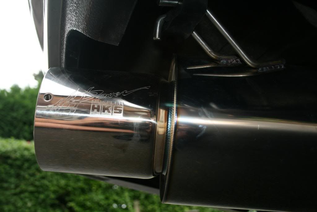

After seeing and hearing about people removing the mid-box from HKS systems, I thought I'd have a go too! I wanted to get the HKS Hi-Power Spec R exhaust which is a titanium one-piece system without the centre box, but the £1000+ price tag put me off a little, so I thought I'd get something similar made myself!
Started off with a brand new HKS Hi-Power muffler (as the last one sounded so good!) courtesy of Apex Performance and finished the job with a trip to MIJ Performance in Walsall for them to make the rest of the system for me. Taking inspiration from the HKS Spec R system, I decided to keep it one-piece and as I have never fitted a cat to the car, I decided to incorporate the decat into the system. So Now I have one continuous section from the back box, and flanged onto the downpipe :) MIJ did a really good job making the rest of the system, using preformed mandrel bent angled sections and 3" stainless pipe, stainless TIG welded and finished off with a machine polish.
When on idle and cruising I swear it is quieter than my old Hi-Power system, but on WOT it makes a lot of noise combined with some 'thrust' too. Love it! :)
nice work mate. looks great.
does look good mate, hard to make out in a couple of the pics but looks really nicely made :)
Cheers guys :)

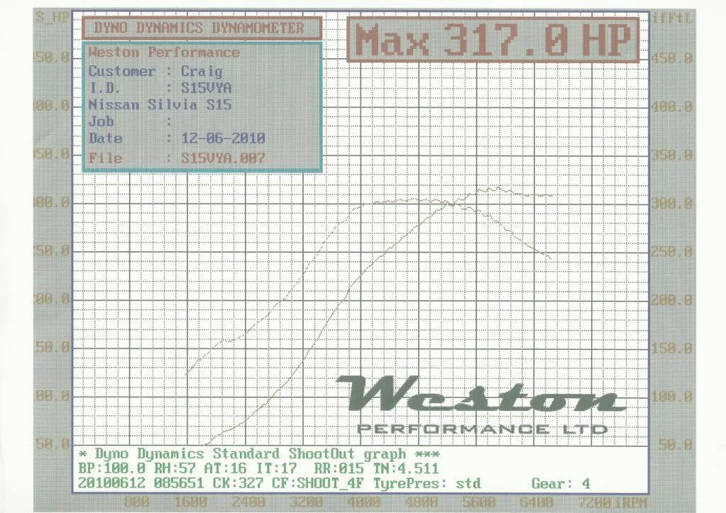

High boost setting (GOLD coloured lines) - rapid boost climb peaking at 1.09bar - Max Power - 317.0 BHP. Max Torque 306 Ft-Lbs

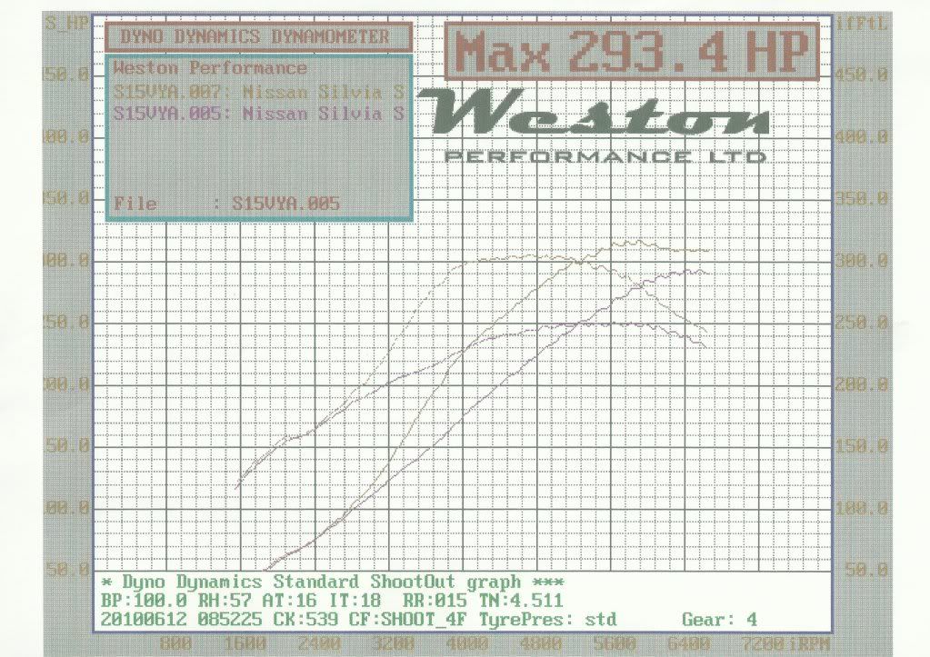

Low boost setting (PURPLE coloured lines) - smooth and steady boost climb peaking at 0.86bar - Max Power 293.4 BHP. Max Torque 251 Ft-Lbs.

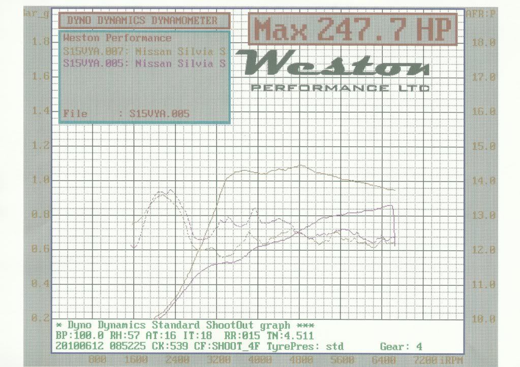

AFR and Boost - (247.7 HP is WHP on Low Boost. WHP on High Boost was 268.1 HP)
Again..
