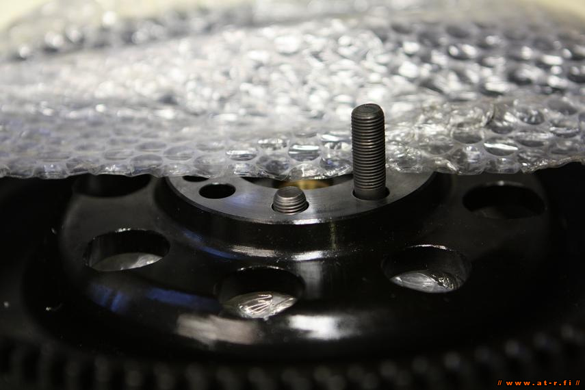

No complains on flywheel quality, but bolts are bit of issue. Those s14 bolts are way too short. Flywheel is 20mm thick at center. Would need M10x1.0 ~32mm bolts for it.
Read that Ford Pinto bolts are 30mm long. Would 10mm of thread (contact) be enough?
tbh, should have gone with Apex flywheel. Too late now, tho.

Just notice that Driftworks have added new bolts included with flywheel... *sigh*
Emailed them about bolts. Hope getting some answers next week.
I thought it sounded a bit odd using S14 bolts, hence my comment. Have you tried the S15 ones yet? I bet they are the right ones.

S15 stock bolts are too long and thread stops too early. So not possible to cut them either.

Argh what a nightmare mate! Hope Driftworks sort you out! It's their fault really for supplying you with incorrect info on their product! :(

Or more of not enough info at all.
Should be sorted now. They are actually sending me those bolts! :)
