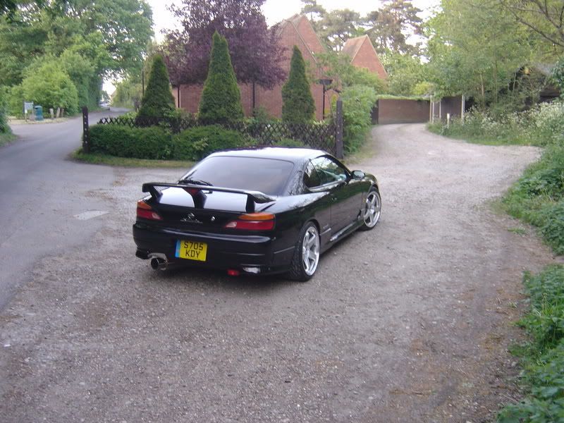

Took a few pics today :D
I like the angle of this pic. How did you get the camera so high up? Cant imagine you up on a telephone pole with a SLR... :)
I still prefer the stock rear lamps. Its just me.
After looking at rear Nissan logo many times over, I got to admit its a little crowded there.
I agree ^^ :) Its very difficult to get a good shot of the rear without the spoiler making the car look ungainly. :)

I think I stood on an old tree stump to get the pic,shame it's a bit blurry,will have to take another one :cool:

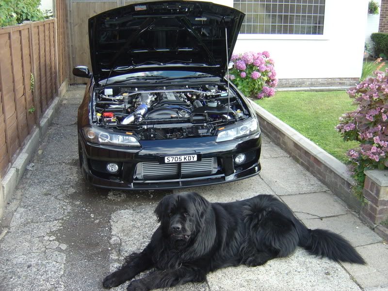

If you look closely,you can just make out my mobile security system :wack:
