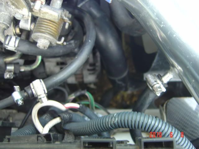

T Toby Guest 8 June 2010 #22 Hose on the right from the I/C piping goes to the Boost Solenoid. Hose on the left goes into the car for the boost controller and gauge. So I tee into either? is one better than tother to use?
C craig8585 I'm so cool, I have my own fan thread :p 🔥 Contributing Member 🔥 Joined 16 November 2007 Messages 4,118 Reaction score 0 Points 0 Location Lichfield, UK Country 8 June 2010 #23 Actually, I'm wrong there, sorry.. It needs to be between the turbo and throttlebody, but preferably in the coldpipe. Can someone confirm that as i've just confused myself and havent got my S15 to check! :wack: But yeah, you'll be ok to 'T' it in.
