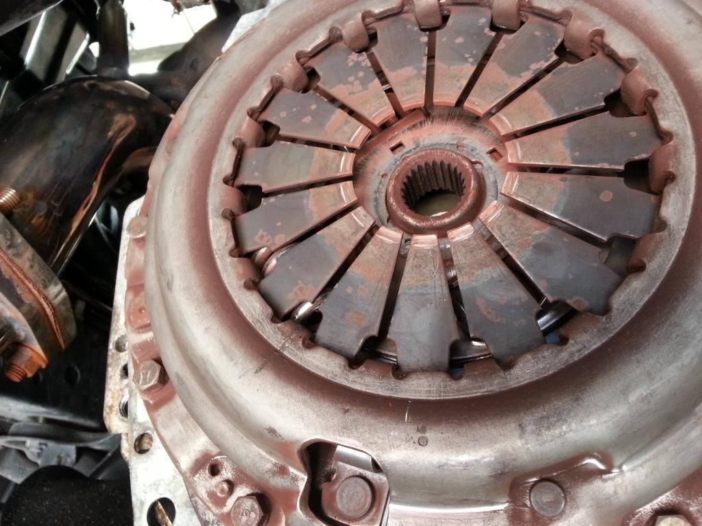

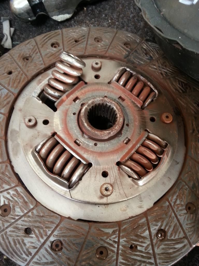

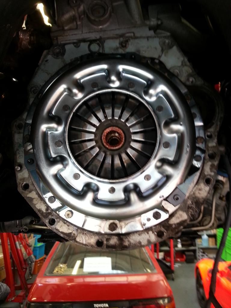

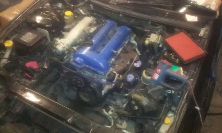

Last night the clutch went funny, soggy, savage vibration and not releasing. Took it down to see superclarkey at Doritech and had it apart.
Don't think that should be like that...
Certainly not!
What was left of the pilot bushing..

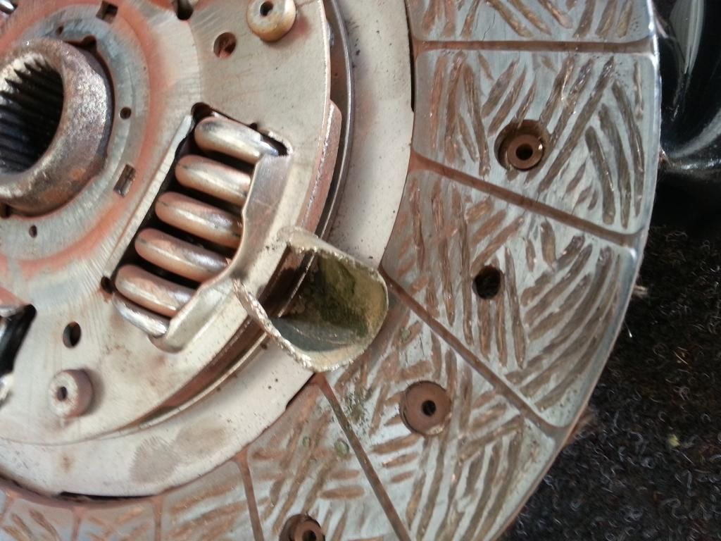

So anyway this happened.
Along with a new pilot bushing, and dowels. All of this is because the dowels were missing, I dismissed it and fitted the gearbox without. This resulted in running the clutch out of line slightly and last night it all exploded.
The car also found a friend..
Rich at doritech did an amazing job and identified further issues that I would have missed and caused another clutch to prematurely fail. Would recommend him to anyone.
