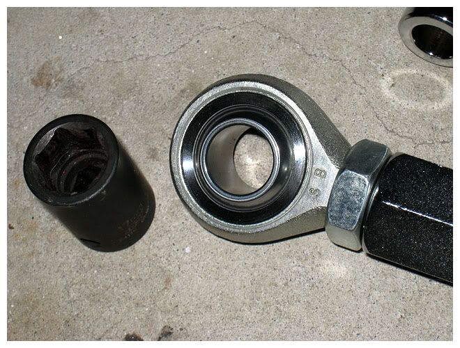

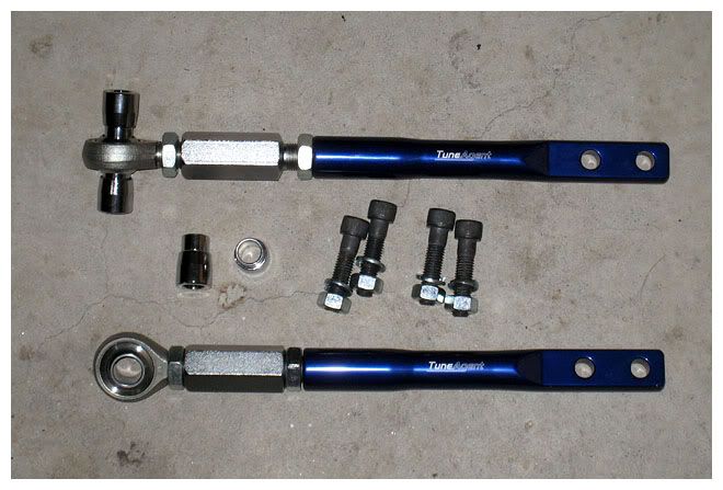

The tension rods I have
The rose joint next to a 17mm socket giving reference to it's size.

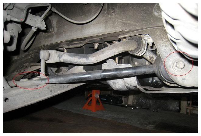

1) jack car up removing both front wheels

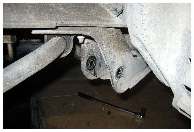

2)The factory caster rod is seen here with the locations of bolts you'd need to undo in red circle
3) Undo the two nuts at the bottom of the rod at the lower control arm's end and undo the nut and bolt at the end with the rubber bush. Pull the bolt out and remove the factory rod.

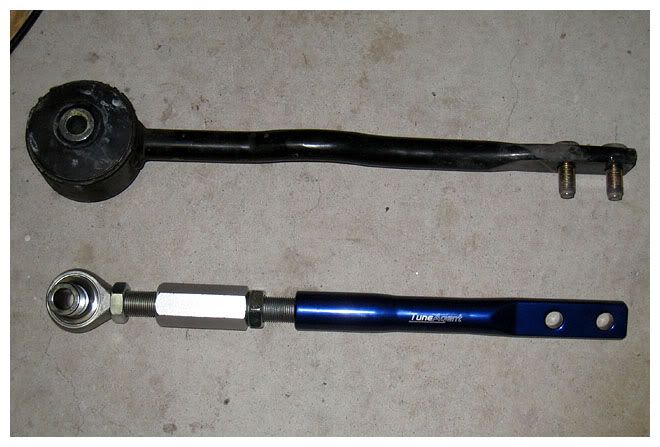

4)The comparison. Measuring the stock rod from the bolt hole at the bush end to the far bolt hole at the other end, I set the new rod to the same length as the stock rod. I did this by setting the rod to the shortest setting and then turning the adjuster to extend to the right length. Tha way the thread on either side would be equal.

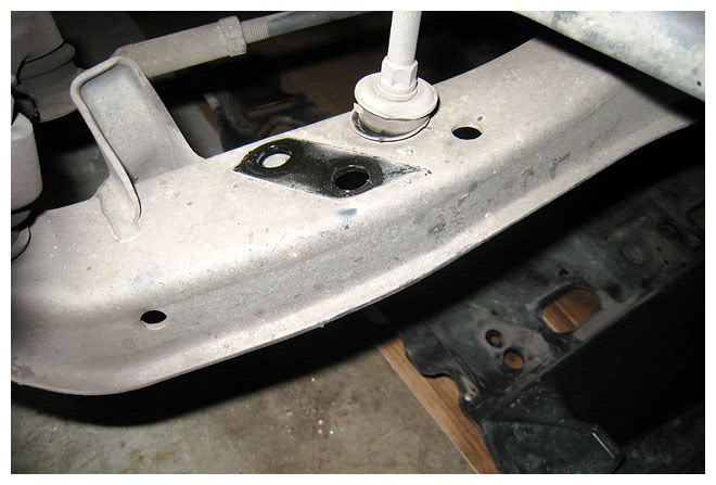

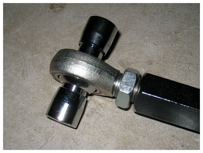

5) Insert the "I have no idea what you'd call this" part that goes in the eyelet of the rose join. This end goes to the tension rod bracket.
6) Fit the rose join end first. Line it up with the holes and put the bolt through and finger tighten the nut.

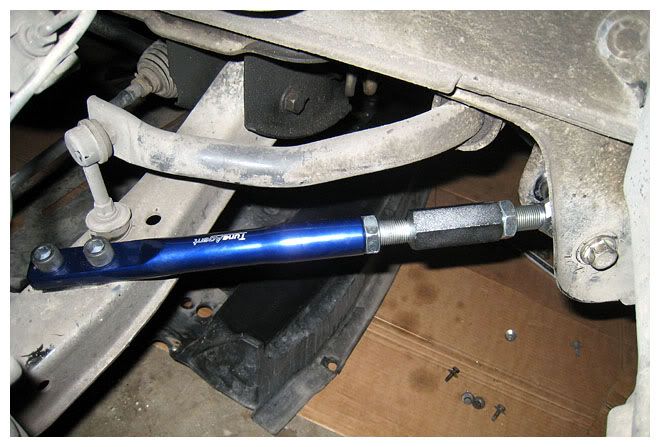

7) Line up the holes with the lower control arm and push one of the bolt through. Maybe require a bit of force pulling the hub towards the front of the car to match the holes on the new rod at the set length.
8) tighten all the nuts and bolts to the specified torque setting as per the workshop manual. And tighten the lock nuts on the rod as well.
