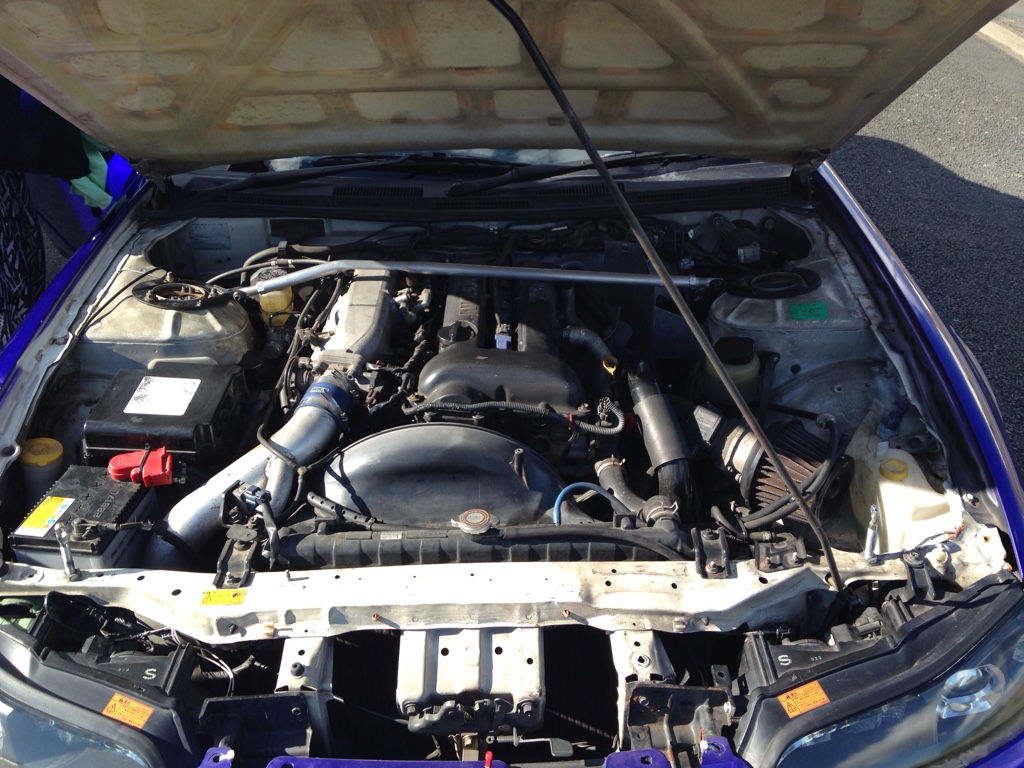

Engine bits:
HKS intercooler
Blitz Nür Spec Exhaust
Spitfire ignition coils
Power Enterprise Air Filter
Tomei Reytec ECU, not fitted just under passenger seat
S14 5 speed gearbox conversion

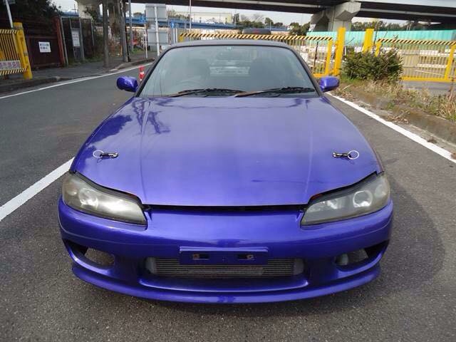

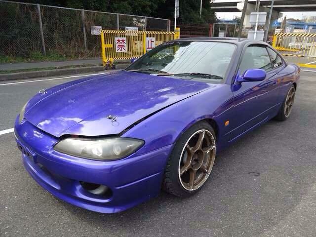

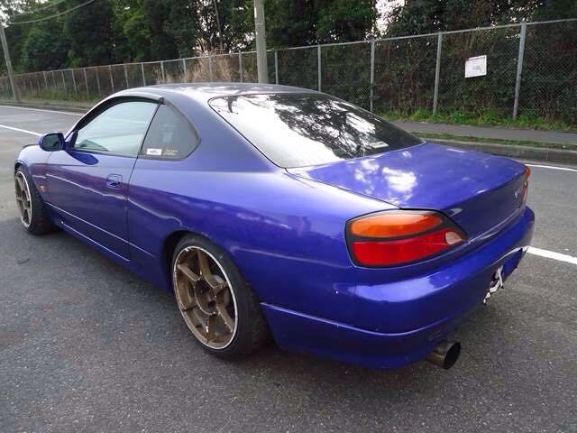

Here she is straight off the boat
And after MOT and registered

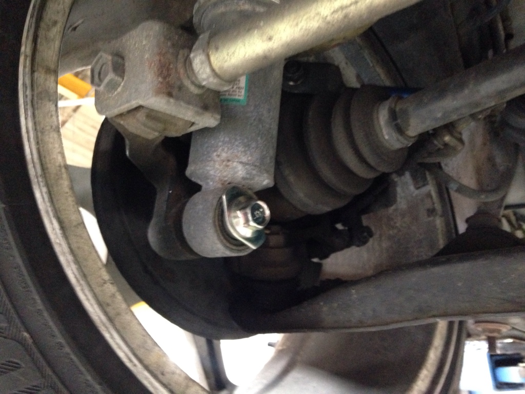

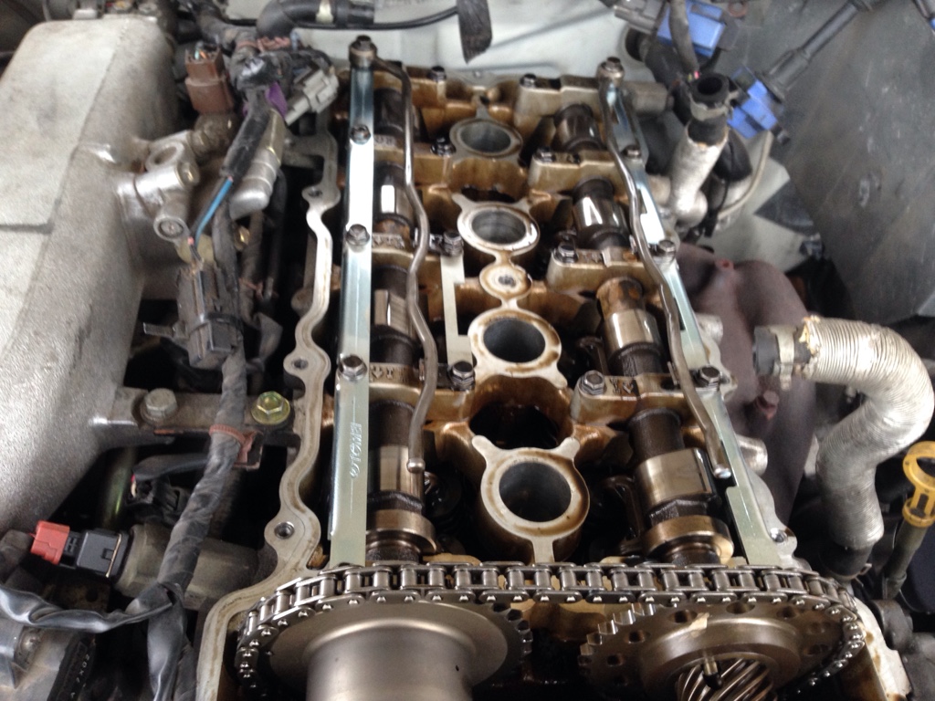

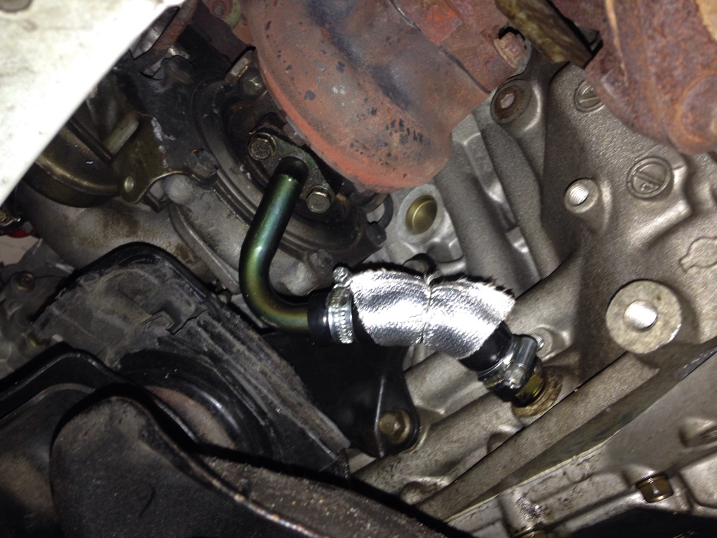

Rear knuckle and Coilover decided to not be friends and go separate ways,
whilst on the side of the road awaiting a flatbed also noticed a heavy oil leak from the turbo return pipe!!
Handily nothing else was broken and it only needed a new Coilover retaining bolt and return pipe, kindly sourced by the friendly people of Cambridge Nissan Parts Department

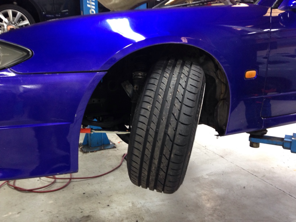

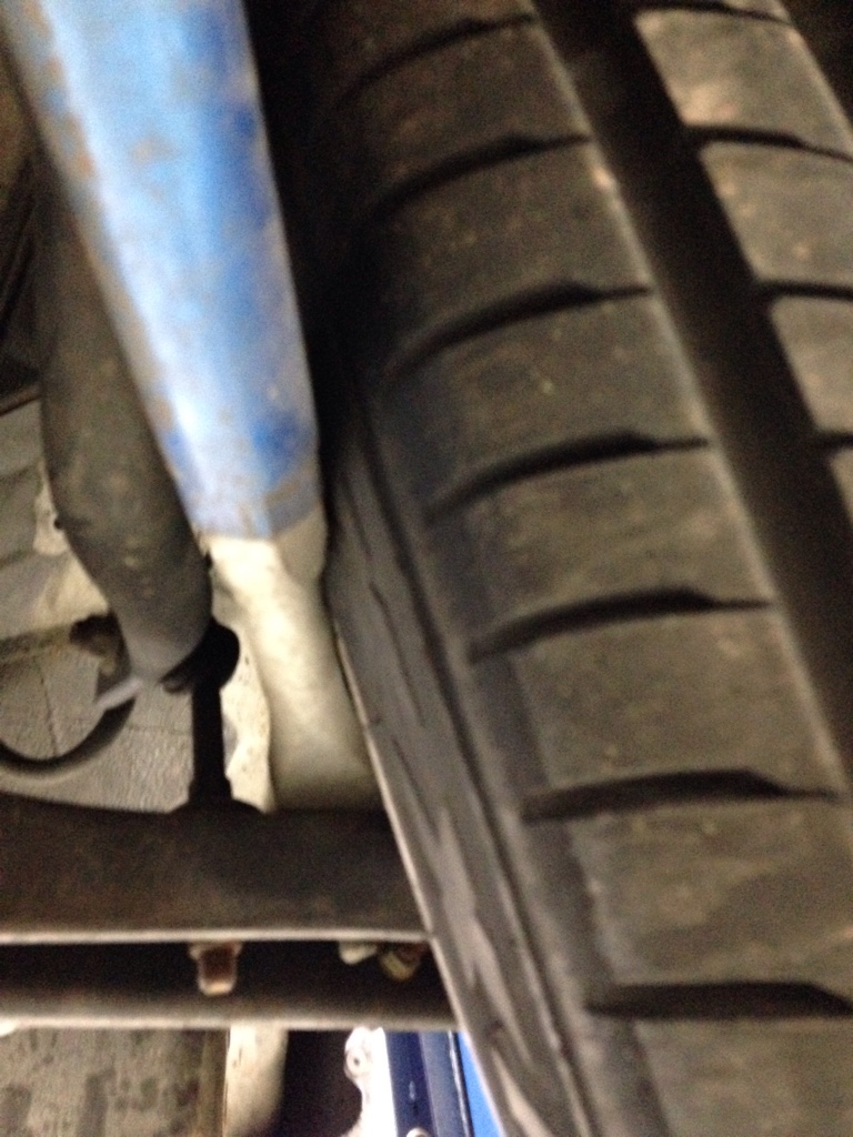

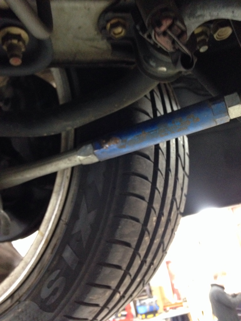

Whilst on the ramp at work also noticed that my wheels were fouling the front tension rods on full lock!!!
Yet another MOT fail haha
So Driftworks to the rescue with some linked Geomaster tension rods
From this
To this:

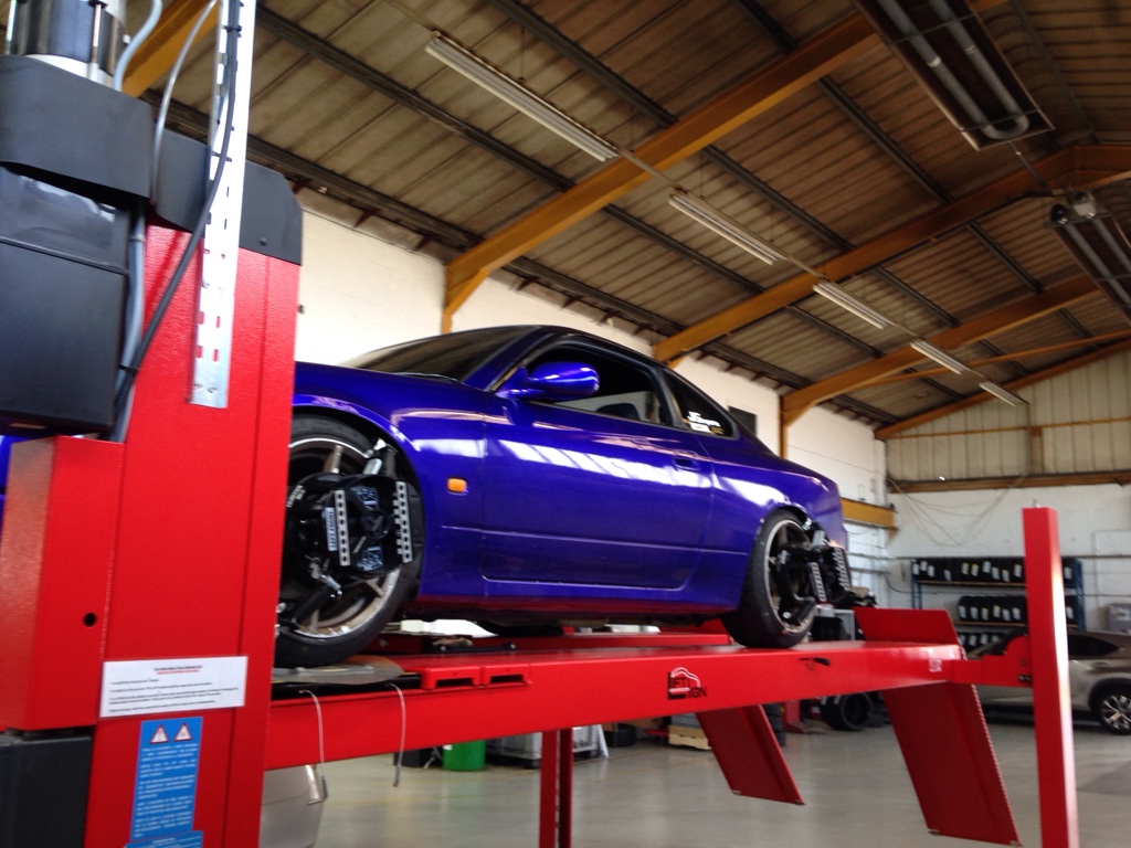

Then I had a play on the new wheel alignment gear at work, this Hunter gear is quite good :)
Forgot to get the obligatory wheel alignment print out shot though haha

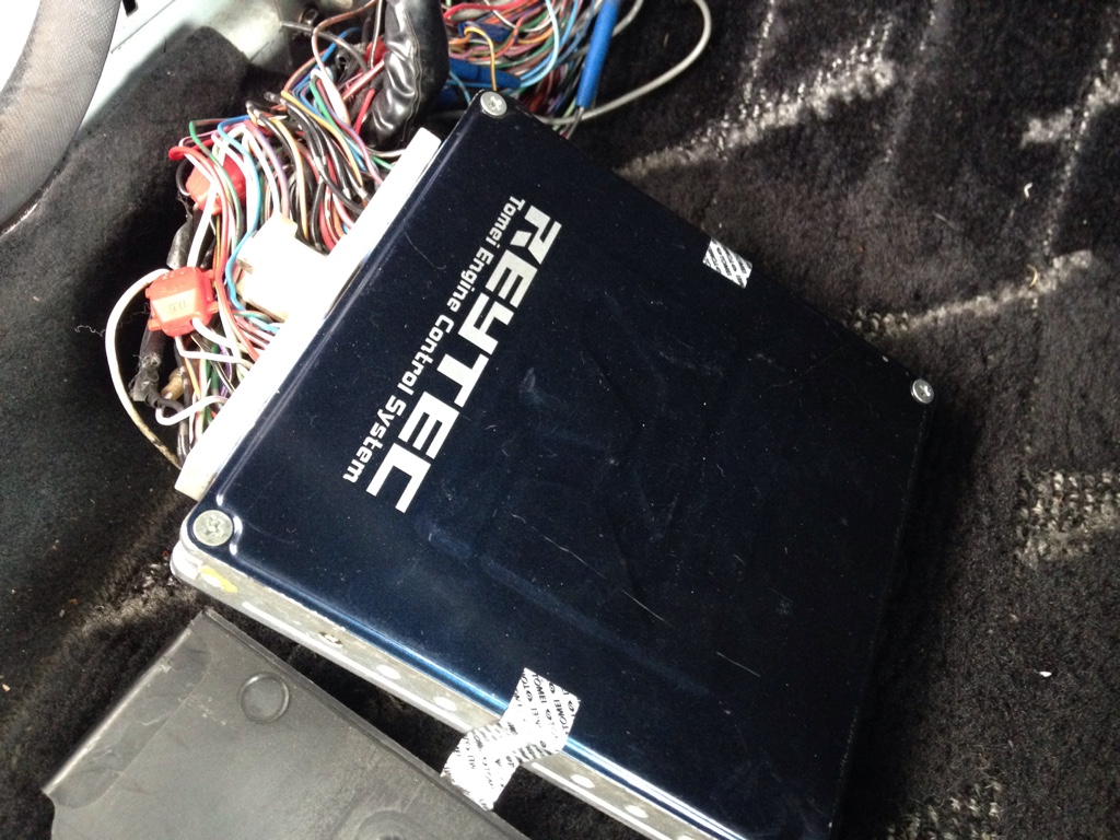

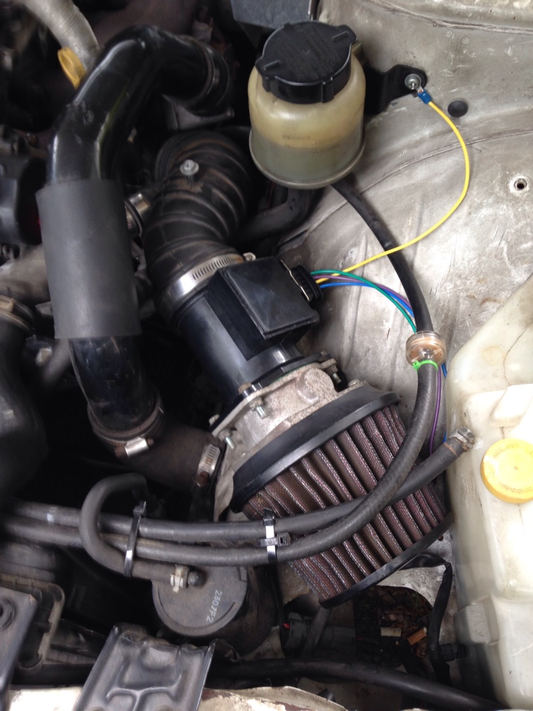

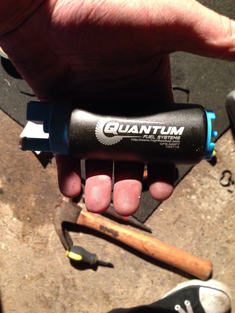

Then it was into making a bit more power so the Tomei ECU got thrown on along with a Z32 AFM, 340lph fuel pump and some Tomei RAS fresh from Japan-land :)
E85 compatible pump, because who knows what the future holds haha

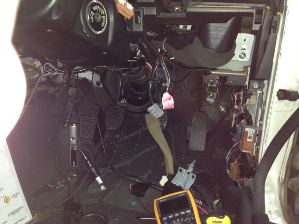

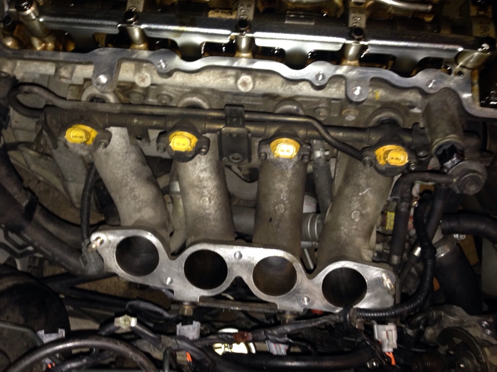

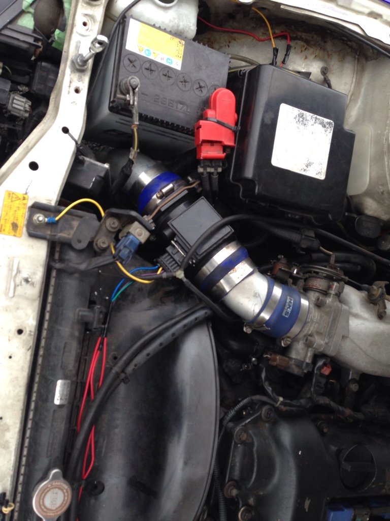

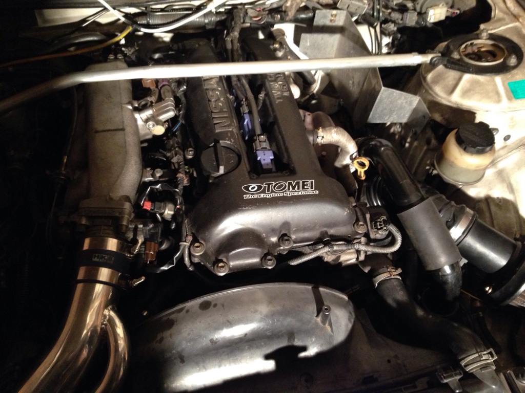

Then thought I'd be really clever and move the Z32 AFM to my intercooler piping and run as a blow through, which didn't really work :(
This seemed to open up all sorts of problems for me, leading me to replace the intercooler piping, fitting a set of 555 injectors, having a replacement fuel pump sent out under warranty and various other bits
However all that was needed was a boost sensor/MAP Signal for the Tomei ECU, which decided one day it just had to have that :(
One evening working out the pin out for the standard boost sensor for the a pillar gauge and wiring it into the Tomei she now runs amazingly!!!!!
Also fitted my old Cusco strut brace off my old S13

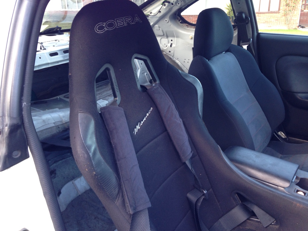

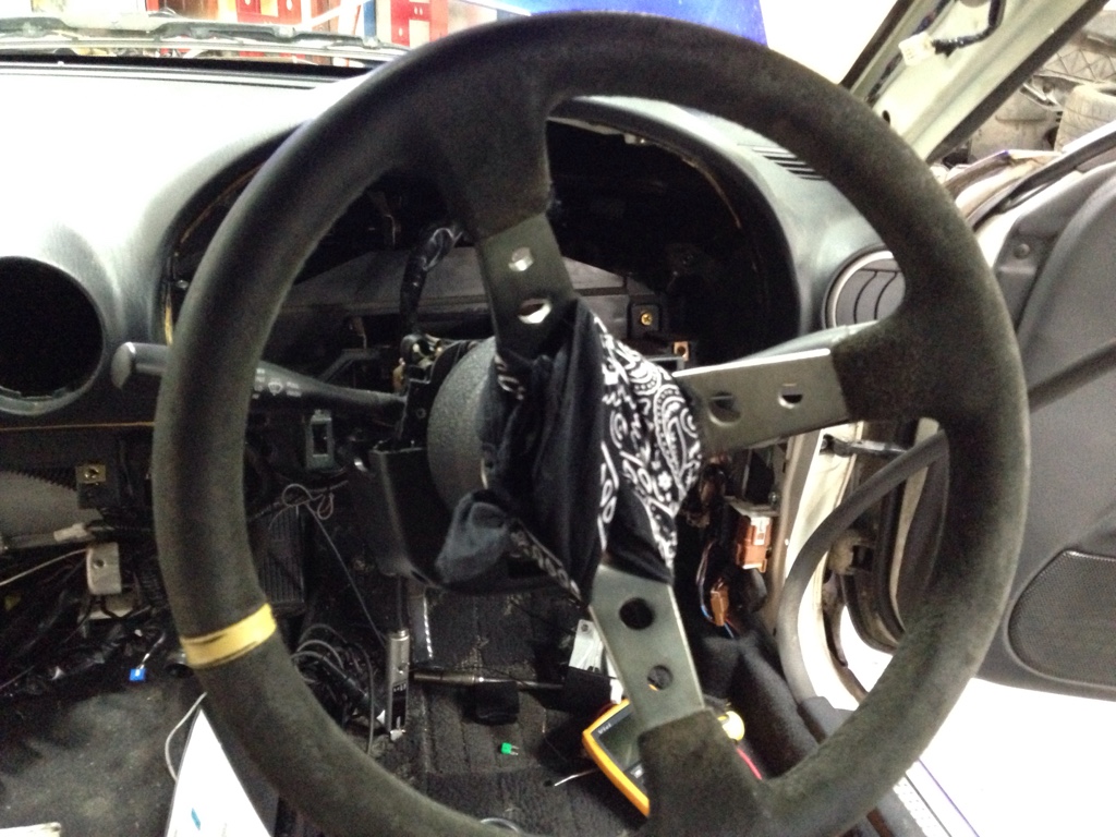

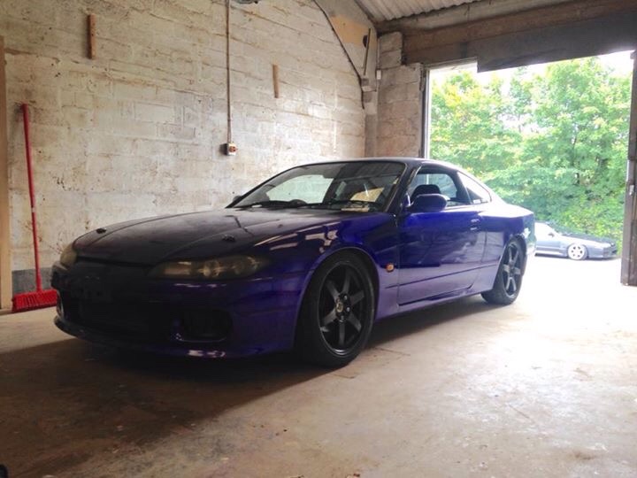

Also got my slightly worn bucket seat fitted and welded in a harness bar and got my steering wheel in :)

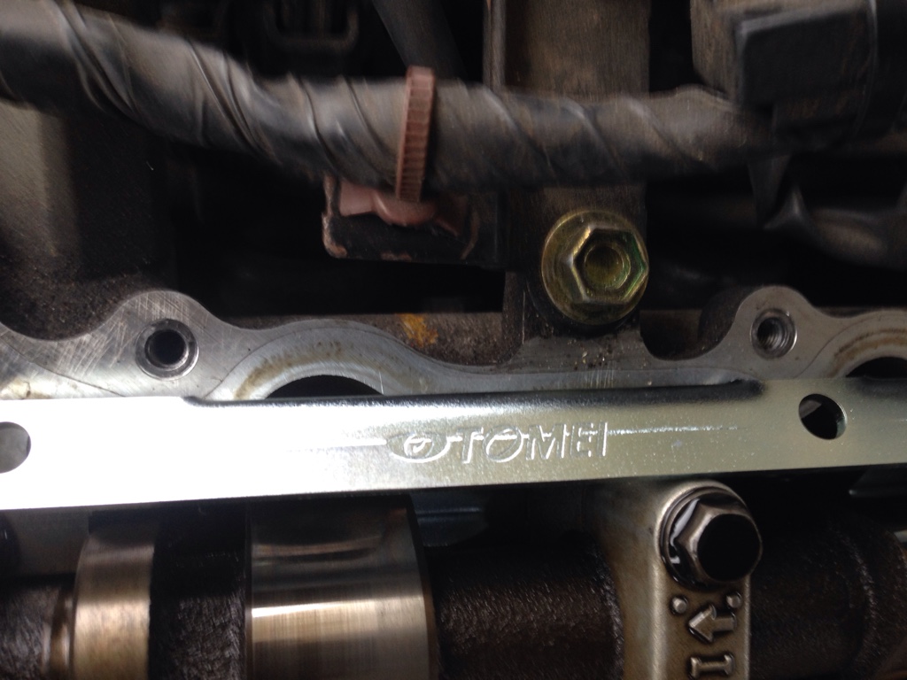

Top mounted T3, japspeed high mount intercooler, Driftworks Radiator, Tomei Cams and springs and possibly upping to 740 injectors, then possibly some exterior bits

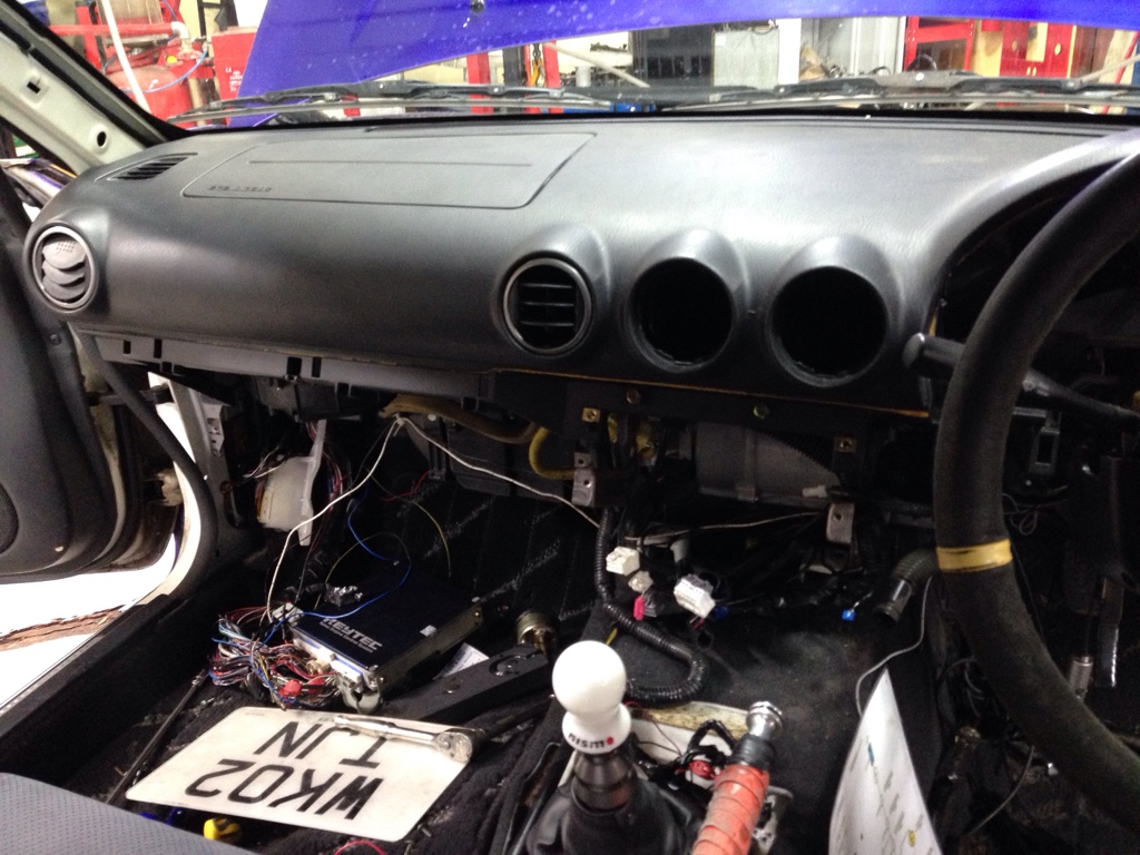

Well this was a fun weekend of finding a wiring short stopping the wipers working :(
All sorted now though :)
Just need to get it mapped and then on with accumulating parts for a top mounted T3

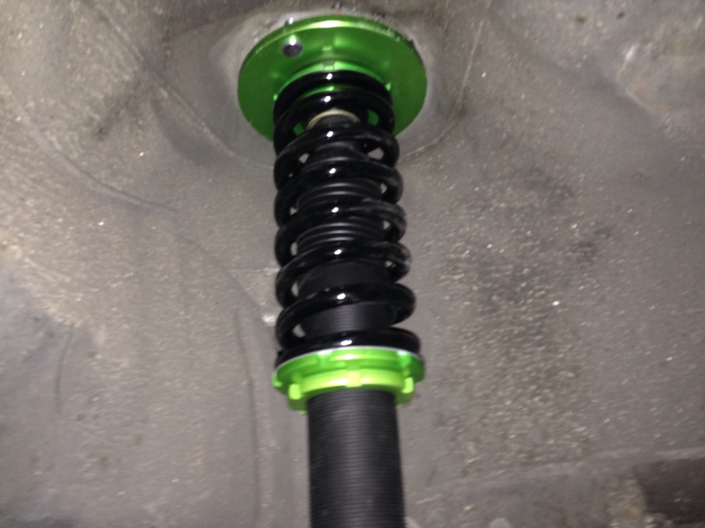

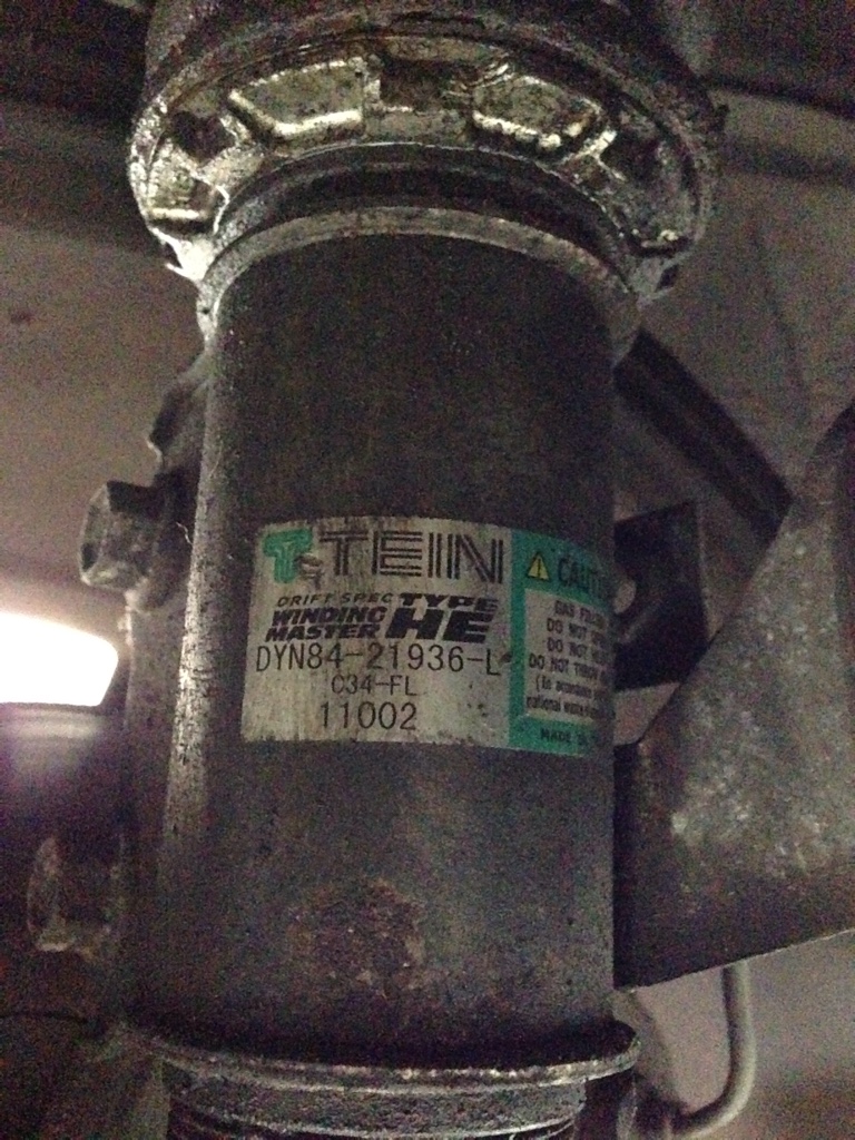

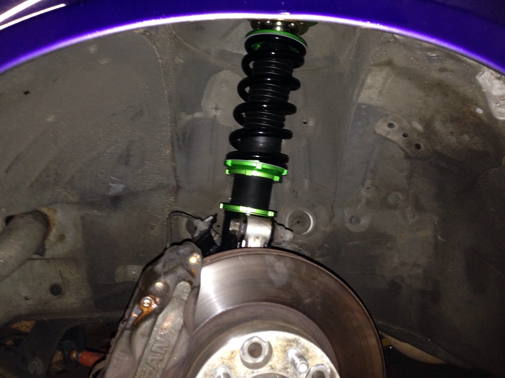

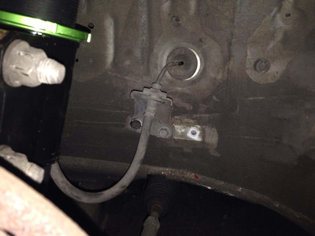

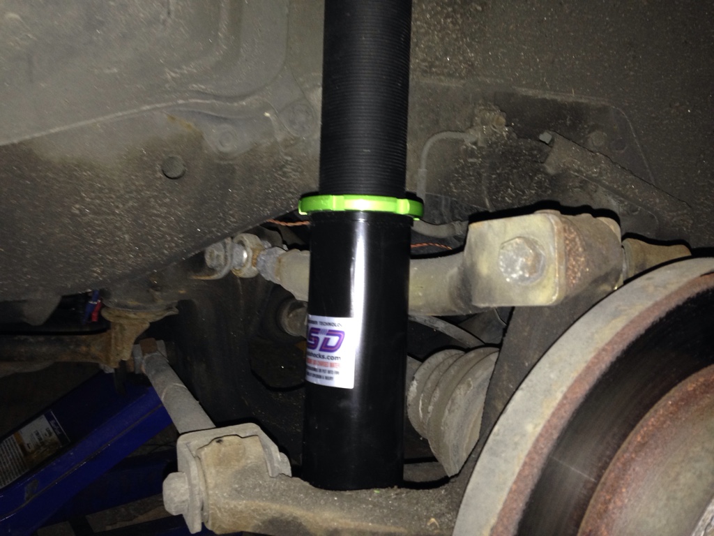

Karma bit me in the Arse and on the way back from fixing my brothers car, my near side front Coilover decided it had done enough work and **** itself :(
You can see all the oil left even after wiping most off, Tein UK wanted £360 a corner to rebuild!!!
So a call into Driftworks and I had some HSD Mono Pro's on the way :)
Couple hours down the unit and...
Also while I had the fronts off I refitted the brake pipe bracket further forward to stop it catching the wheel rim on full lock
Completely transformed the car now, noticeable even on the short drive back from the unit :)
Also put on the freebie sticker, because why not?
May have got a bit carried away with the adjustments though haha

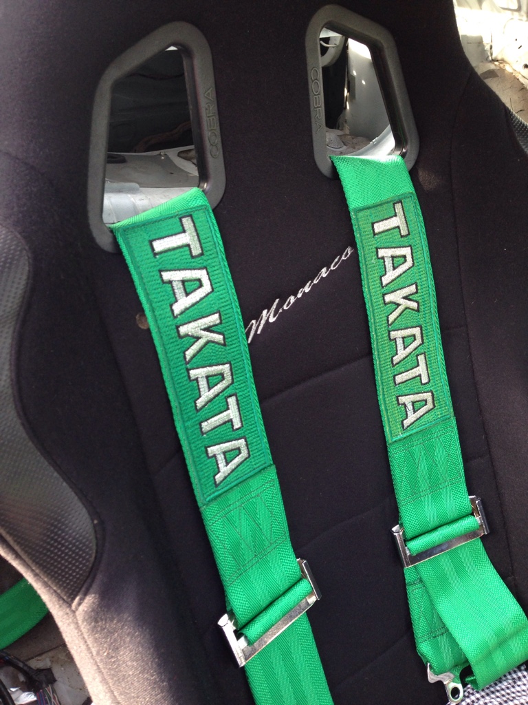

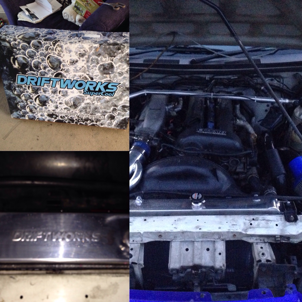

More updates :)
Nice big supercool radiator from Driftworks
And Takata harness, kinda pain in the ass for a daily driver though haha

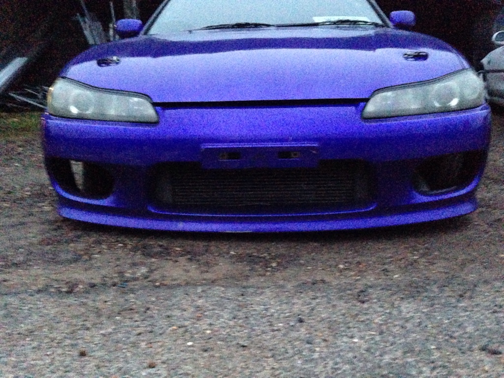

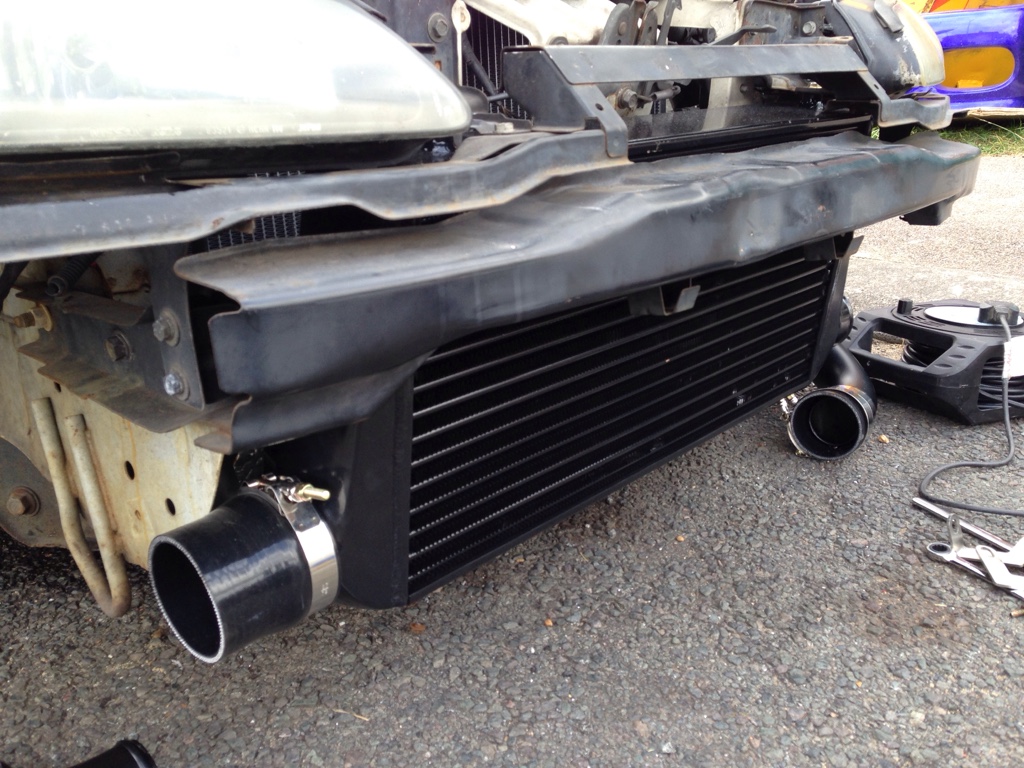

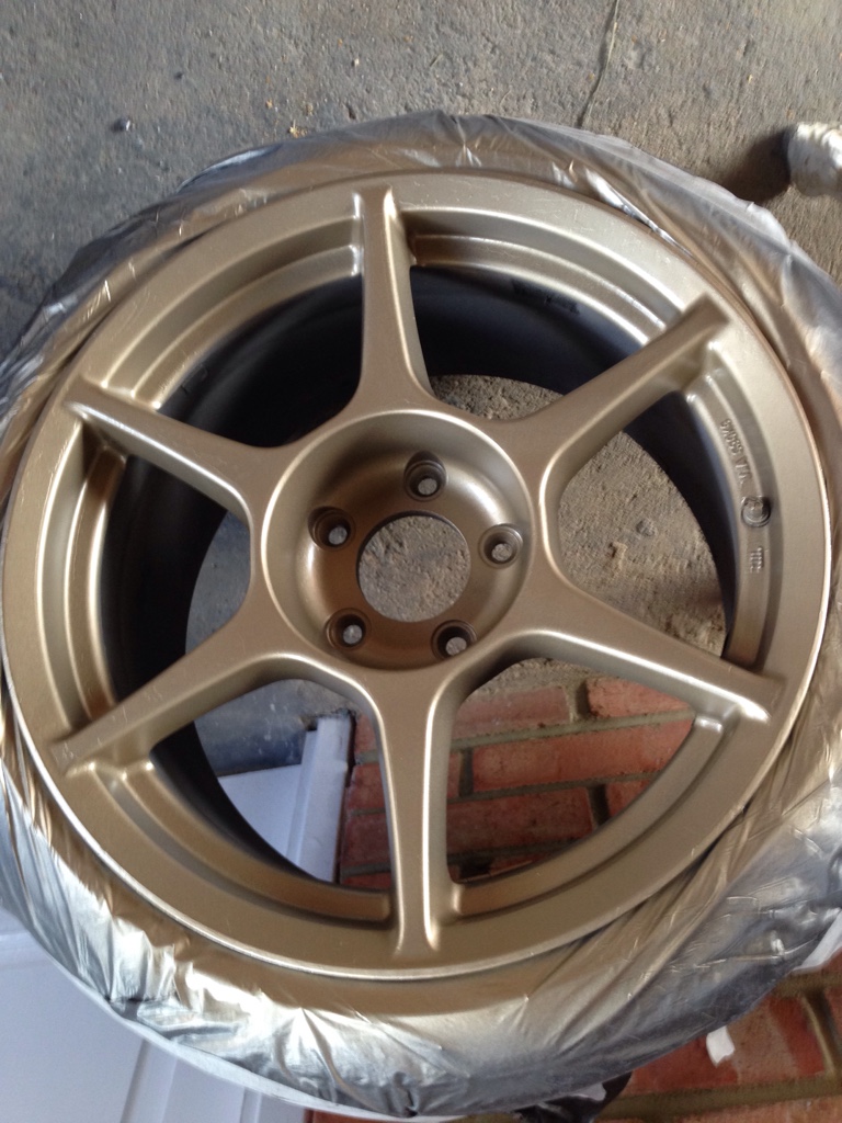

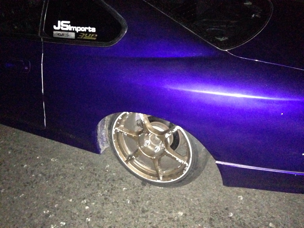

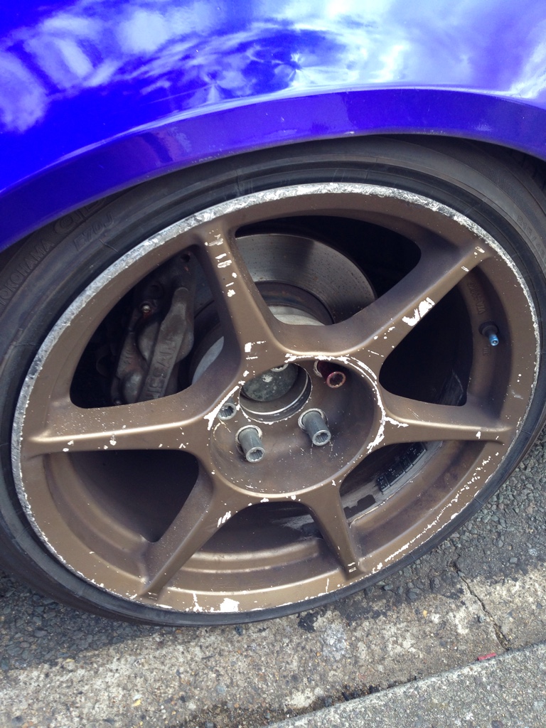

Hey guys time for another small update, some cosmetic changes for a change :)
Finally painted the wheels after nearly s year of ownership haha
And sorted out a gear lever gaitor as couldn't get any standard ones with surrounds to fit due to the 5 speed conversion and modified gear lever!!

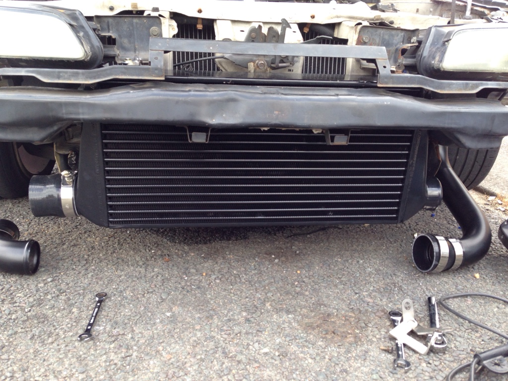

Then on with the new slightly bigger intercooler :)
All black this time so less shiny bits to polish!!!

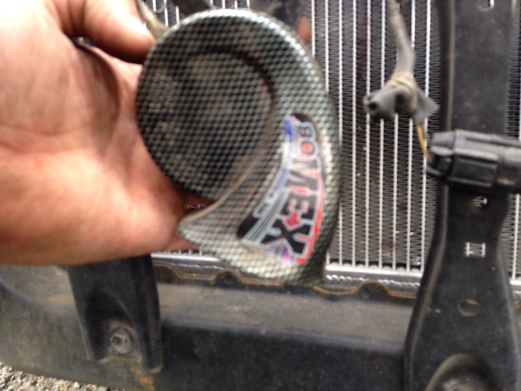

Plus found some JDM tyte horns bro!
Love the fact a year in still finding random bits on the car!!
26 September 2015
46
6
Cambridge
Thanks, colour came out far too light though, supposed to have been bronze not gold haha
