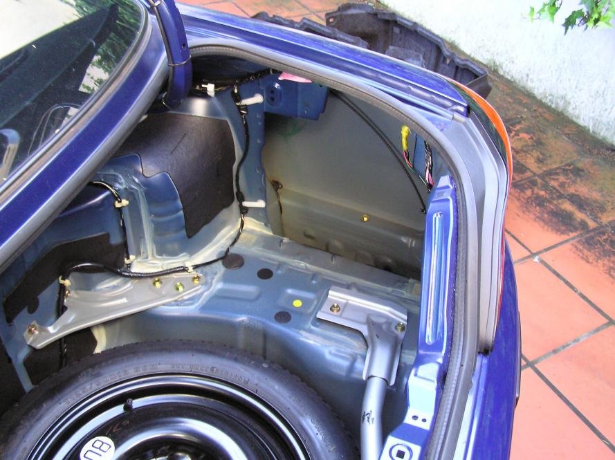

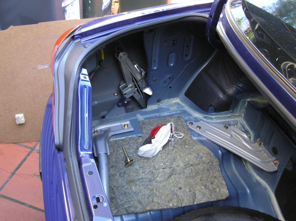

the boot brace goes at the very back of the boot. There are also braces just behind the fuel tank as shown in the pictures.

I don't seem to find the spot where the nuts would bolt onto...
that's weird..maybe they only made for Spec R chassis..
The chassis is the same, maybe they just didn't drill the holes in the spec S.

Yep check for the holes, if it's there then make sure it's threaded too - then it'll be a quick bolt on install :)

went to have a look on my boot, there wasn't any holes or threads for the strut to olt onto...
Nissan probably didnt drill the holes for Spec S body..
40
Is there any black round stickers in the boot floor? You can aften find threaded holes under them. Found a couple extra holes in my boot which I used to fit my battery :)

yep...i found the black plastic thingys on the floor...
will try pull them out and see if theres any thread

I'm also looking to see whether this will work. I lifted a couple of the black stickers (not the black bungs), and there were threaded holes underneath, however, just not had time yet to make sure that they are mirrored on both sides!

If there were a couple of them then I'd imagine they'd all be there. Will have a look later on too
if you cant its a very inexpensive thing to have made i'd imagine, just two pices of drilled flat plate with a bar welded between the two....one thats been made may even be stronger than the nissan item/more rigid....

Look in the boot, if there are 2 m8 (from memory) threaded holes on the tops of the chassis rails each side then you have the mounting points for the brace, there will also be spare holes around the front area of the wheel well for bracing to look for, there's a chance the unused holes will have a circular sticker covering them. Jdm garage uk should have a full set of spec r braces as they are breaking my old car.
