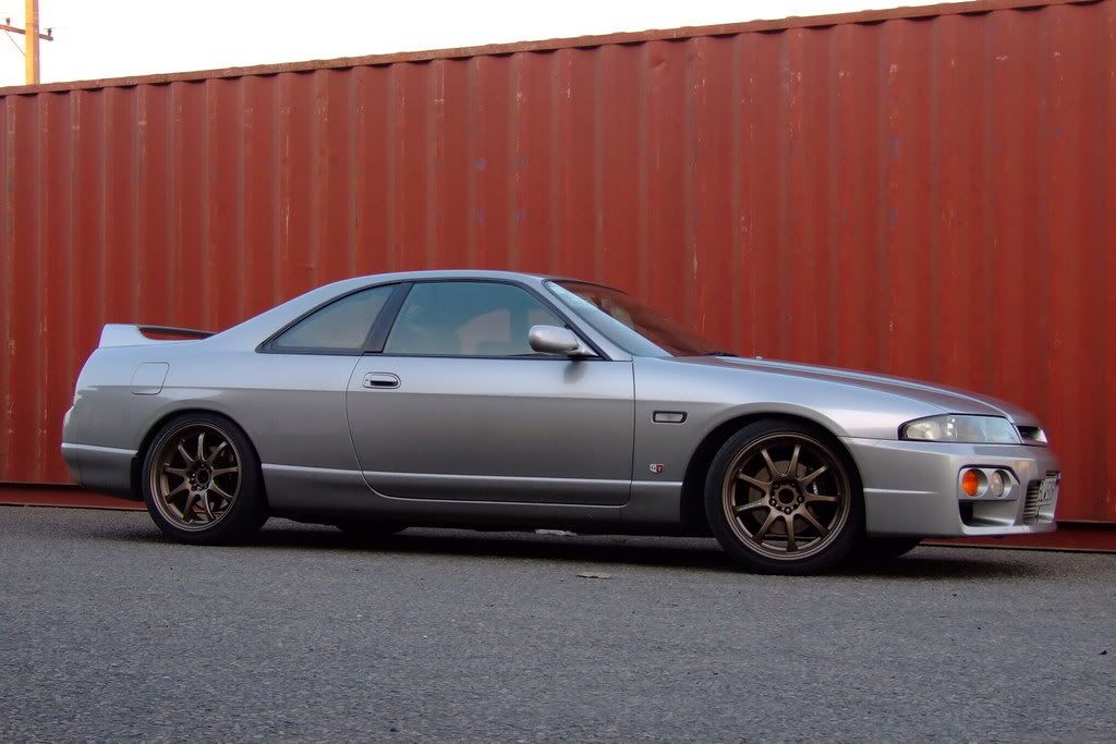

This is what they will look like (very similar offsets on a GTR)

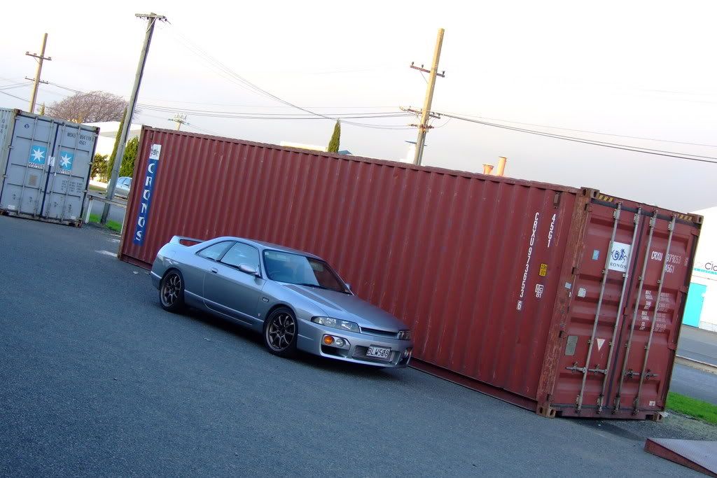

And heres his car.

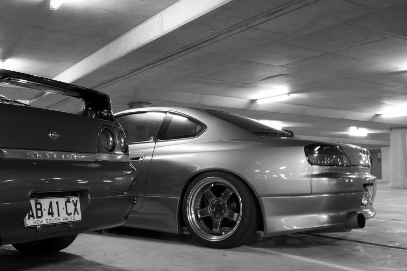

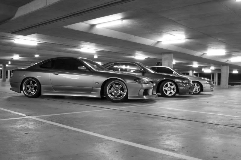

just wanting to know if anyone could please tell me what rims these are on the s15 in the black and white picture.
thanks
