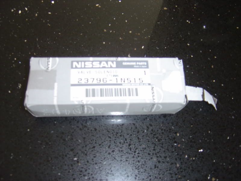

My car used to make the dreaded vvt rattle when it was started up from warm,it was fine when cold but on warm start ups it would rattle until I put it in gear and engaged the clutch it would then stop and not come back until the next warm start.Today I fitted this
A brand new vvt solonoid (?48 from Japan) it is different from the one that came out of the car as it has a ball bearing device in the end of it,somehow this must keep the sprocket pressurised,anyway the end result is a non rattly car :D :D :D :D :D

You were lucky. Its usually down to internal wear in the sprocket, but occasionally a new solenoid will fix it. Just a warning if others are thinking of replacing their solenoid... :)

I think if your car only does it on warm starts it might be worth gambling that the ?49 solenoid cures it or if the noise doesn't bother you, spend the ?49 quid on beer :D
