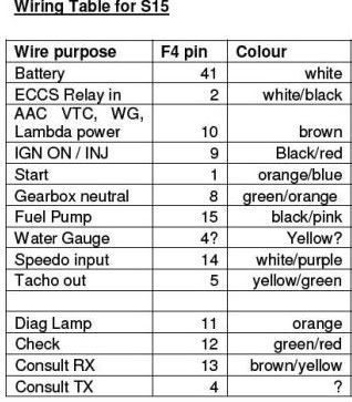

i saw that are would some peoples in austalia who did this swap. did anyone know the wiring diagram for this swap?
what wires i have to connect?
