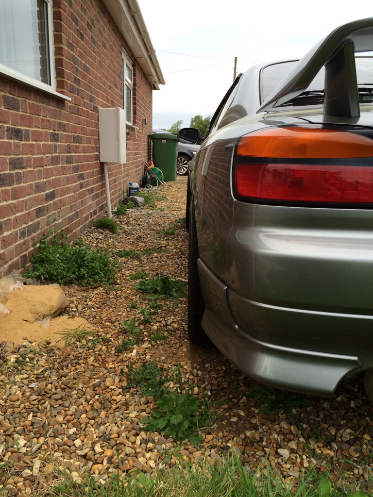

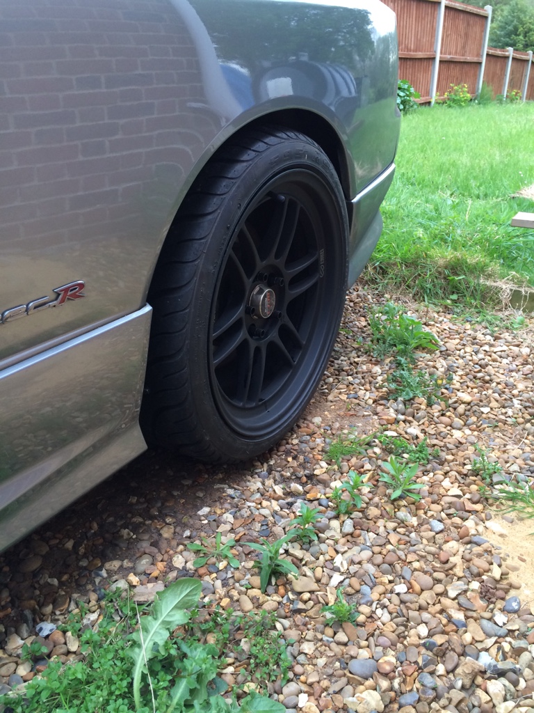

Biggest problem was they won't clear 356mm front brakes. From memory they're 18 x 9.5 et45 on the back with 255/35/18 RSR, very snug with just the arches folded back, no flare.
Fronts are 18 x 9 et35 with 245/35/18 RSR and a 15mm spacer to clear the calipers. Adam ran them with smaller tyres and more camber to get them under stock wings. I wanted a decent size tyre and don't like stretch so fitted 20mm wider origin wings.
I'll get a photo before I leave for work :)

that look amazing thanks dude
