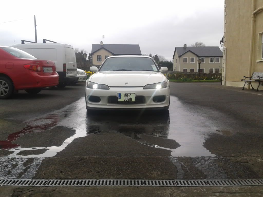

Hi Guys,
Can anyone tell me what lip this is please ?
Ive seen on ebay there is x2 types of similar looking plastic oem style lips.
One is to suit the DC2 type R and tho other is just some soft plastic stripping that you can use on any car ...
This pic looks like the DC2R lip, does anyone know were i can buy or if the DC2R lip fits S15 factory front bar ?
Many Thanks for your tips :)

yeah, looks like DC2R lip. It doesn't fit perfectly, its short about 2cms as you wrap it around each side. It would need some modifying to make it sit perfectly, but the actual curve and its pretty spot on to the S15 front bar. Its like a soft plastic, almost rubber like, well the one I had was. I had one but sold it, can't remember how much for, but I got mine from J-Imports.

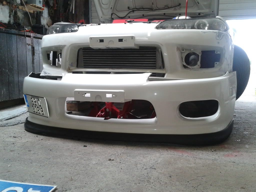

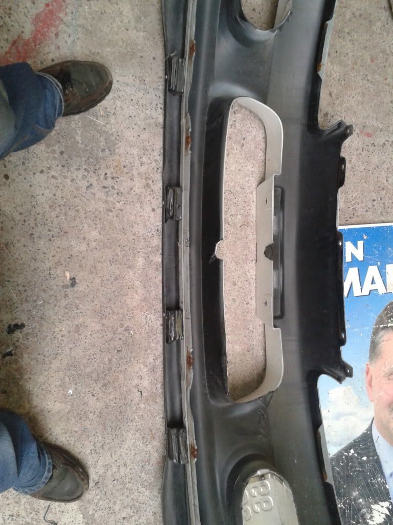

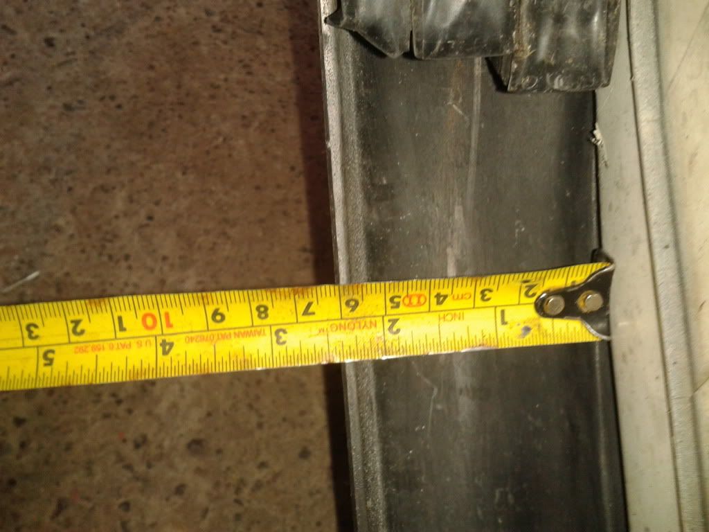

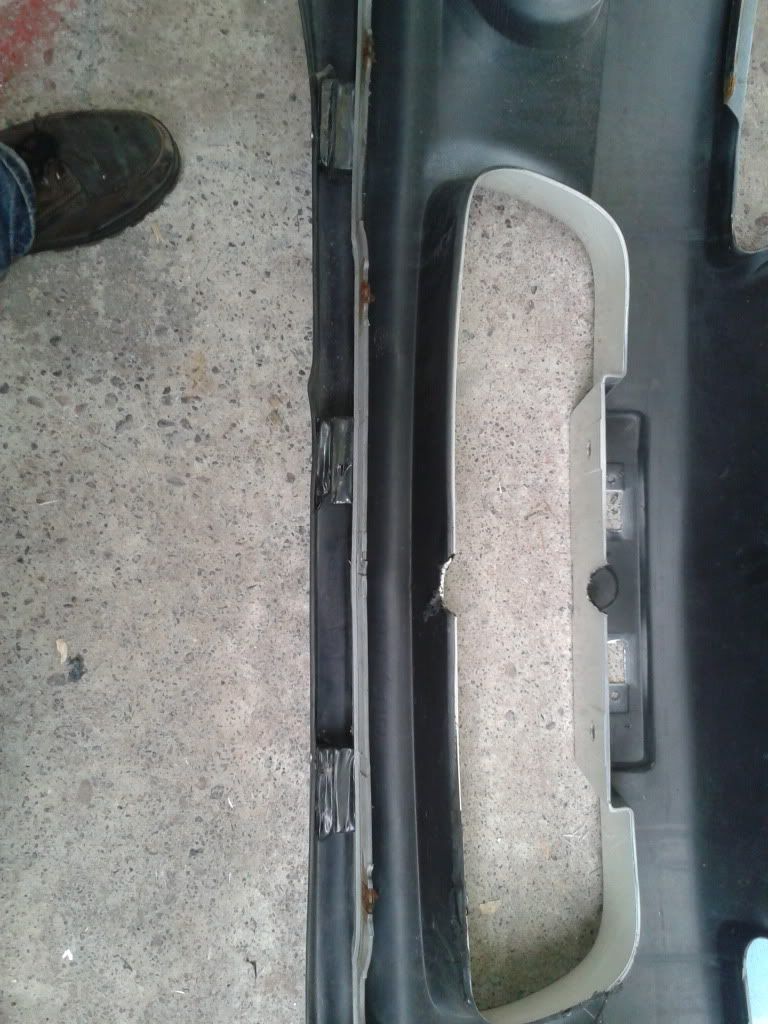

Okay folks, had my front bumper off today , so took a few pics off how i fitted it and how short it is on the sides, the pics will speak for themselves.... mostly.
This is how short the sides are, i painted it black where its short, to give the illusion from a glance that its not short!

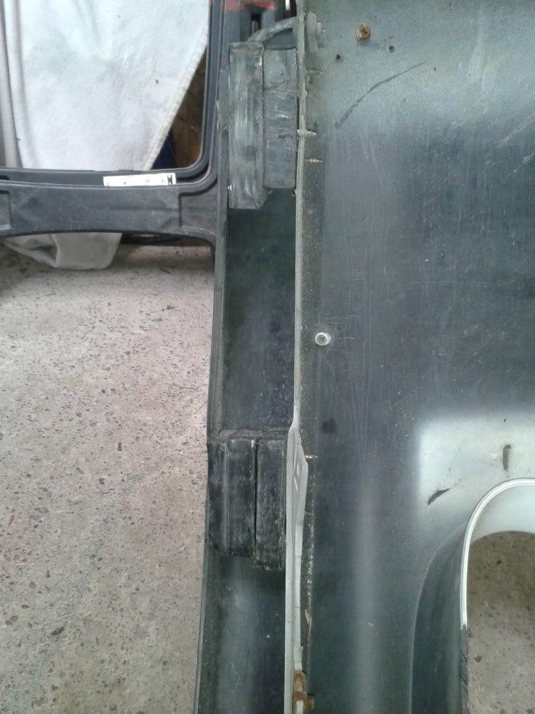

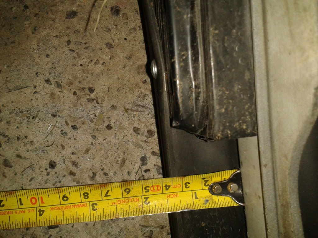

So, this ia the inside off the bumper on each side i have this much off a gap from the bumper to the lip.. The black spacers are just pieces off timber wrapped with plumbers tape, to stop the water rotting them over time,
And this is the rear off the bumper, on the front section..

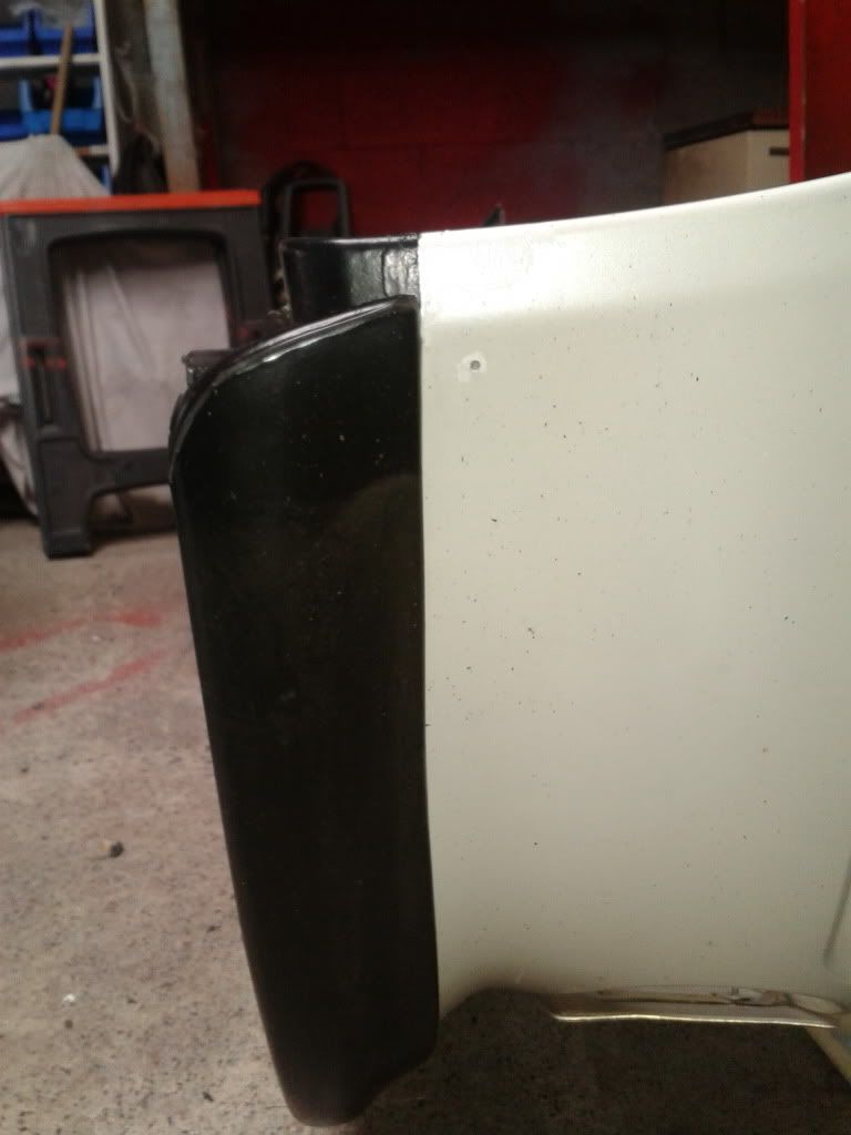

This is the side, and how its spaced.. Also, if your wondering, the lip is screwed up from the bottom off the lip to the bumper, easy!
Hope this helps, feel free to ask more questions... i hope im clear on what ive said above, but in any case if you had the lip and bumper infront off you , it would all become very clear..
