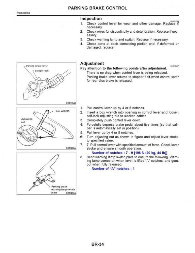

look at the handbrake it's self under the handle there's a hole where ya tighten it i beleive its a 10mm socket needed to tighten it
I think 10mm is correct. Page BR-34 in the manual shows the pics and the adjustment proceedure.
Does that help?

long skinny 10mm deep socket
long exention bar
ratchet
set the handbreak where you and buy holding it with the button in and tighten (as usual) clockwise with your other hand
try not to stretch the cables
