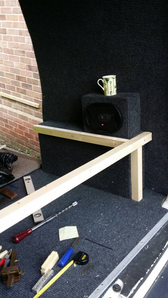

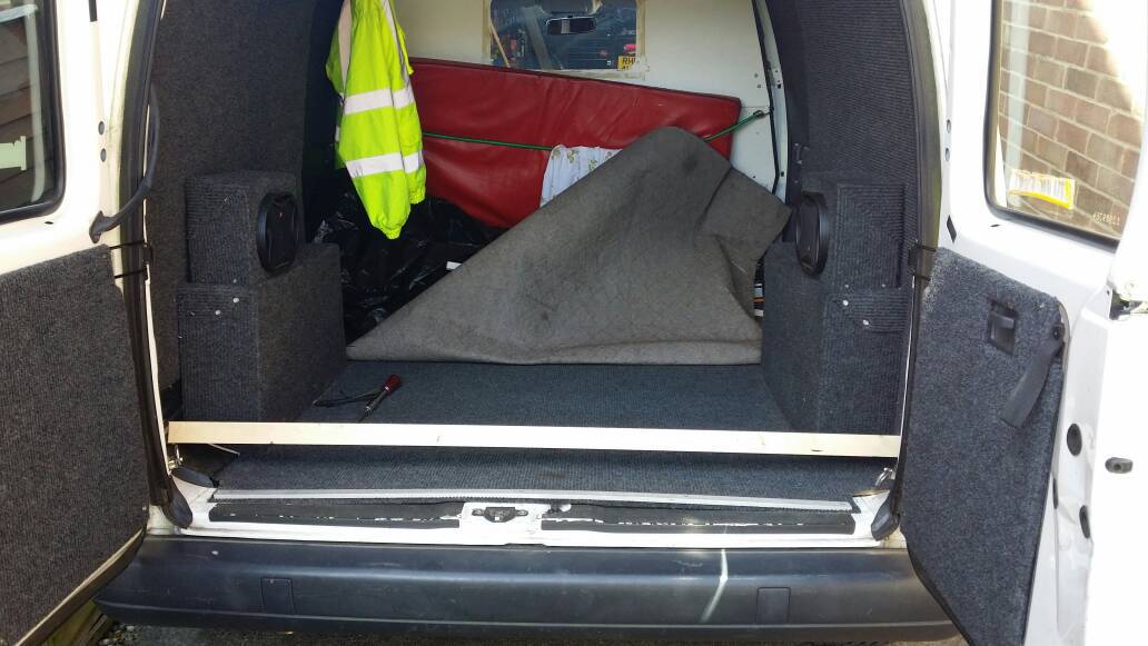

Well it was ply lined when we bought it and I carpeted it and put some speakers in, it's been like this for 3 odd years now and when I've gone camping in it I've just put a air bed down. Decided to make it more official now.

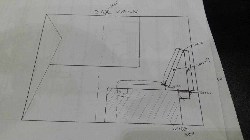

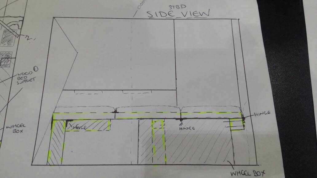

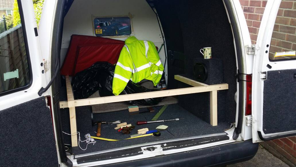

Started off sketching some stuff out and taking some measurements.
This is how it started, carpeted.
It's pretty pic heavy from this point! Ha!

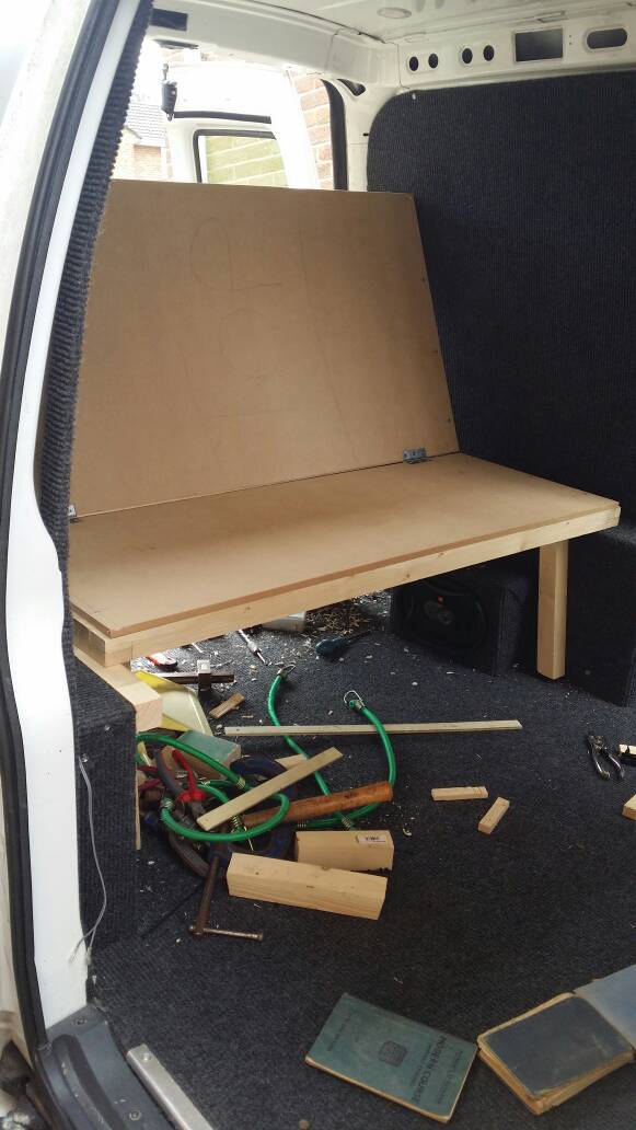

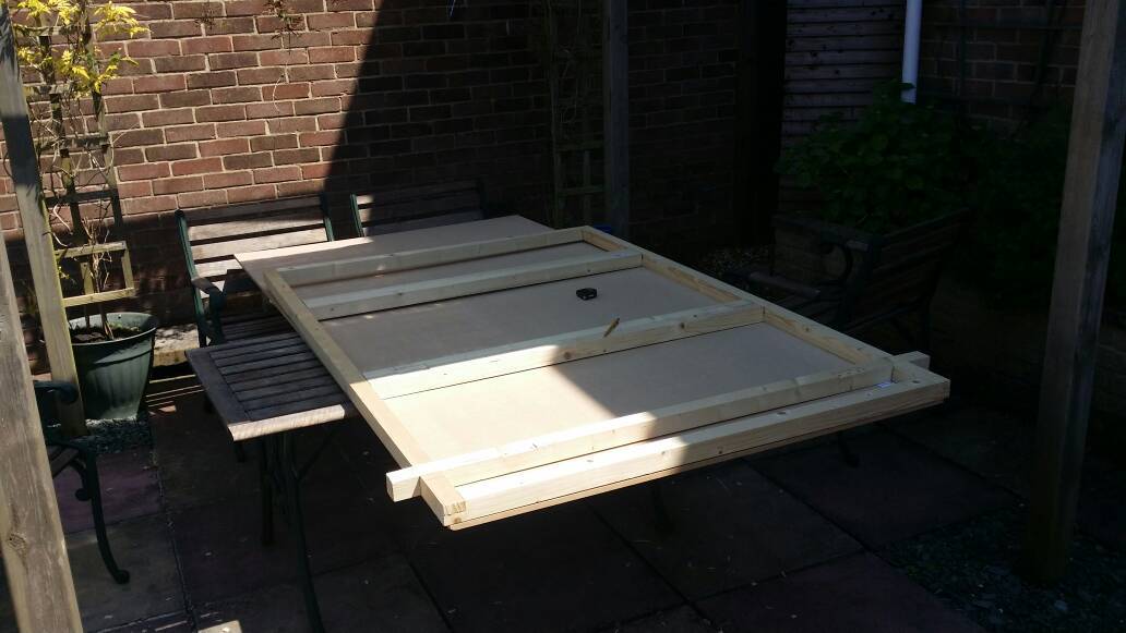

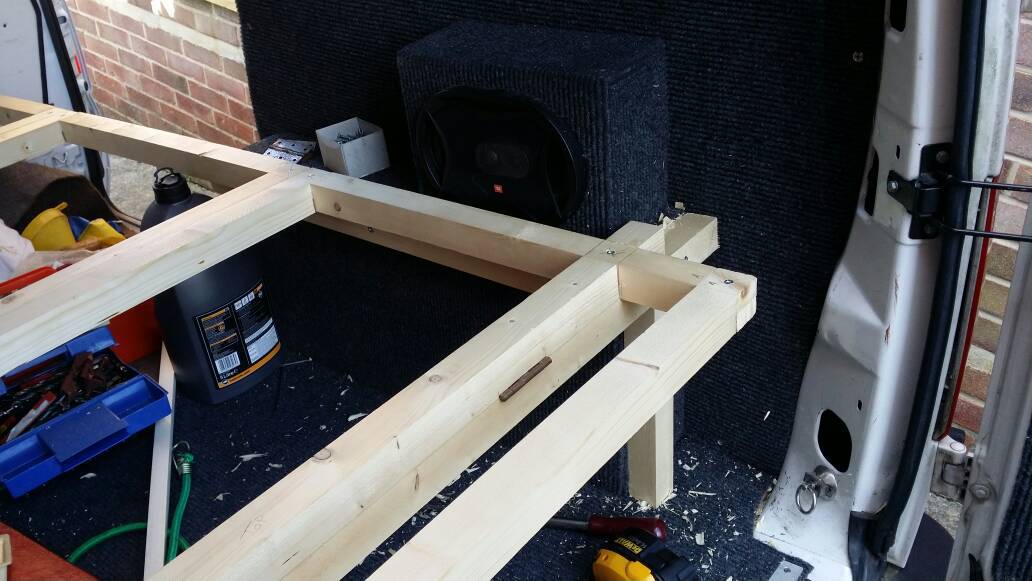

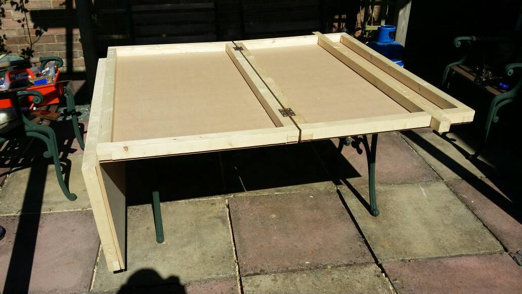

This is all joined in, hinges are hidden under and the top section lifts back.

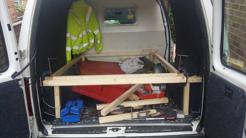

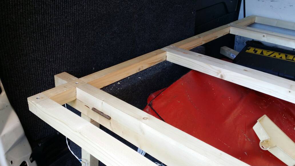

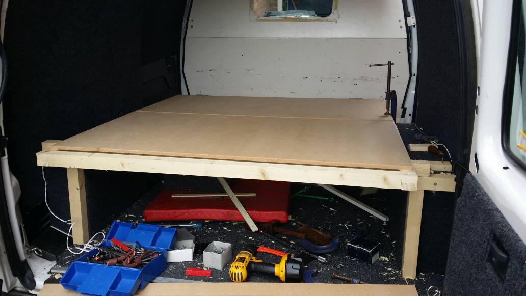

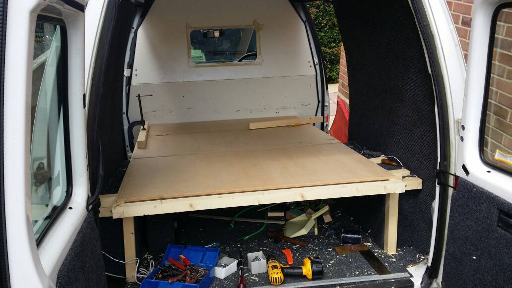

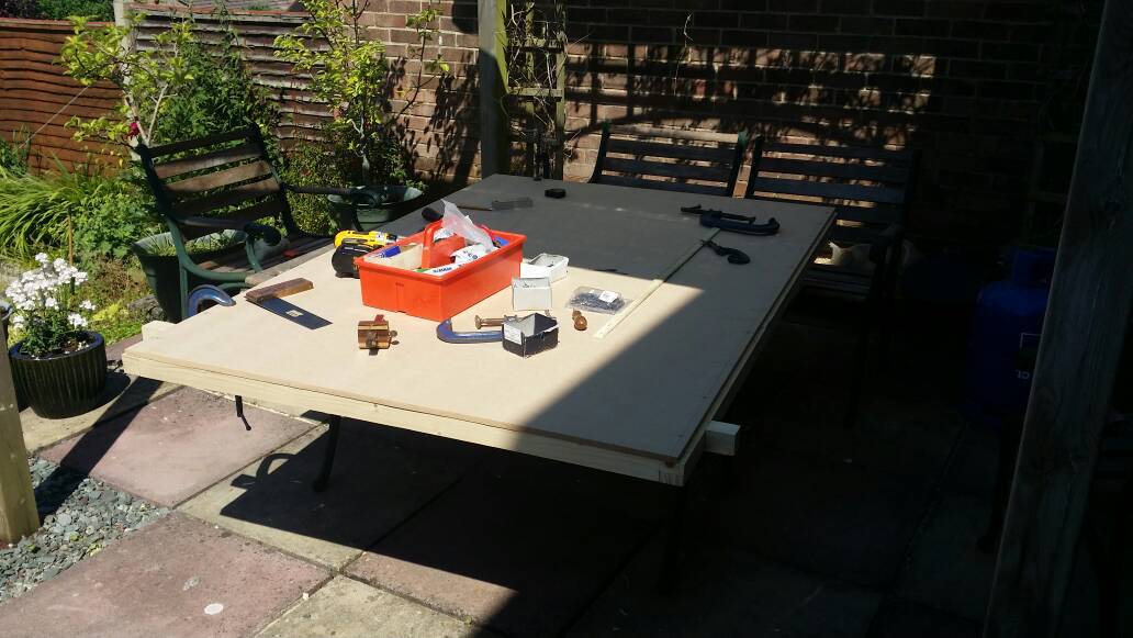

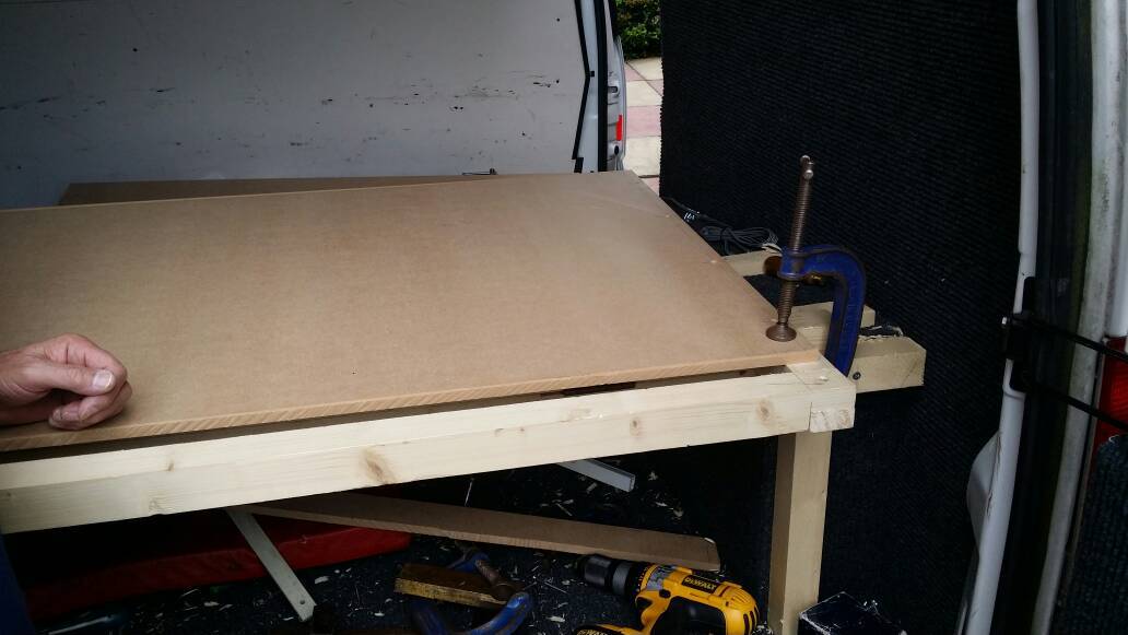

This is the bed section being assemble onto the frame. we then cut all the section in one go. This worked out in some respects but we had to change the height of the back and the middle to correct the seat back height.

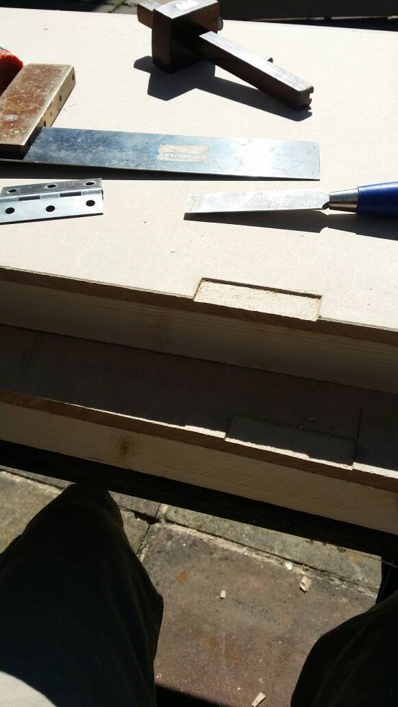

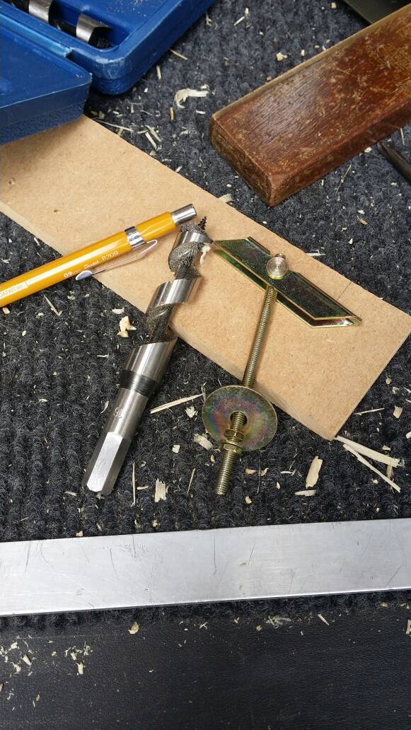

Chiseling the hinges in.
Test fit!

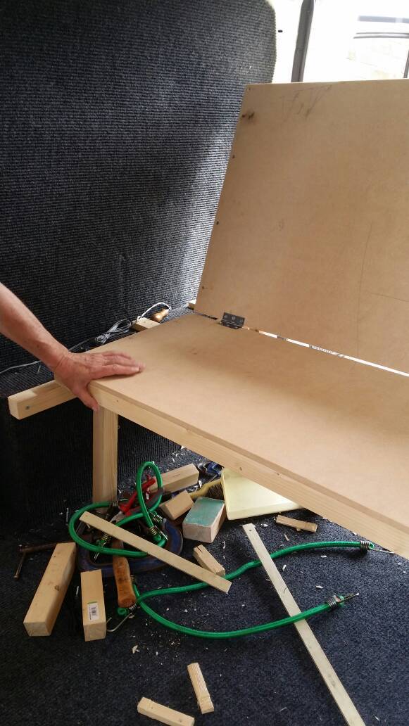

Seat test fold.

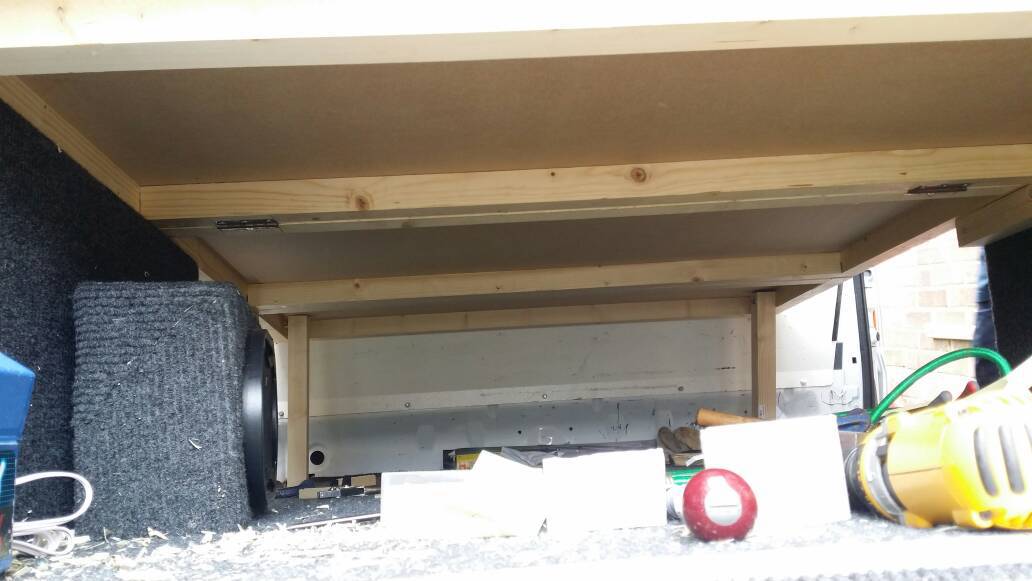

As the wheel box is only thin ply and most of the bed hinges on the rear bay we put two of these in to share the load.

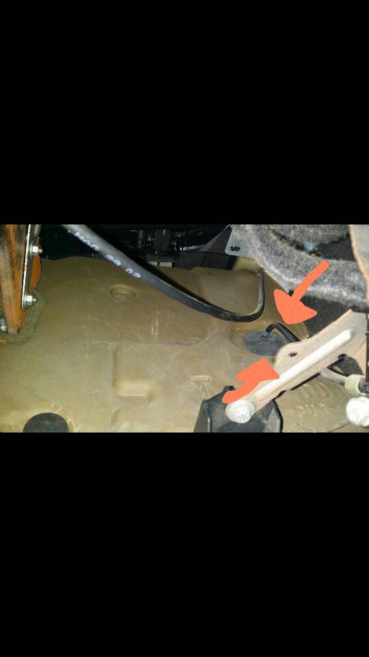

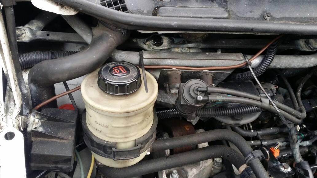

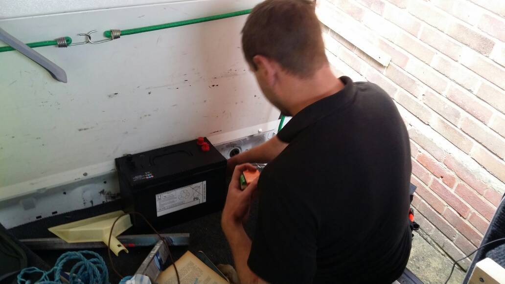

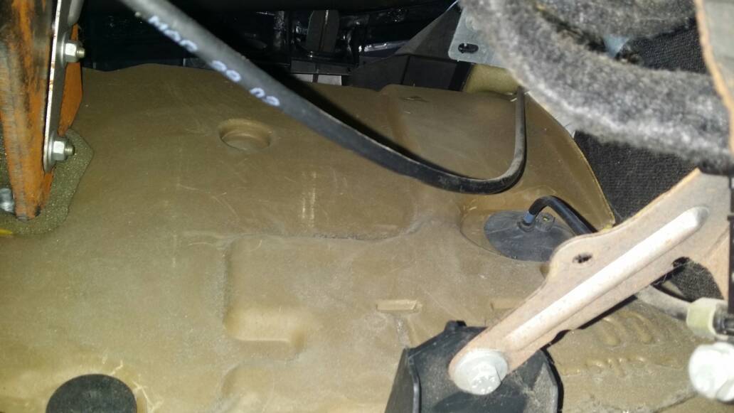

Next up was the leisure battery... this was literally the only place and ironically it was perfect! If anyone want to do this to a scudo, dispatch or a partner this is under the drivers footwell and it is next to the bonnet release!
Mike
16 May 2010
871

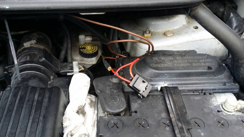

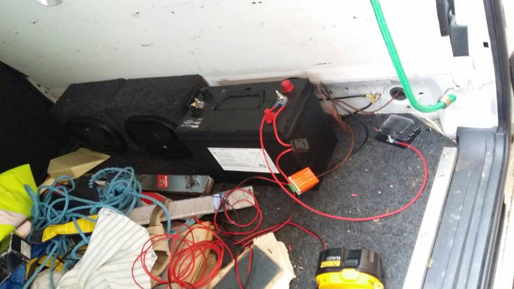

Decided a 110ah leisure battery would be fine as I only want to run a couple of 12v power point and some lights. Put the battery behind the bulkhead, was good for a earth. I got a 15 quid set of ebay which came with the relay to hook into the battery and charge the leisure battery. They are not the same as normal batteries as they release energy lower and charge slower. unsure of how many amps they draw when charging we made sure to put in 20amp fuses to be sure.

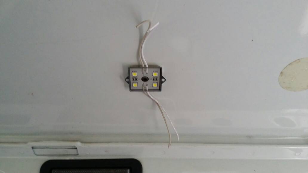

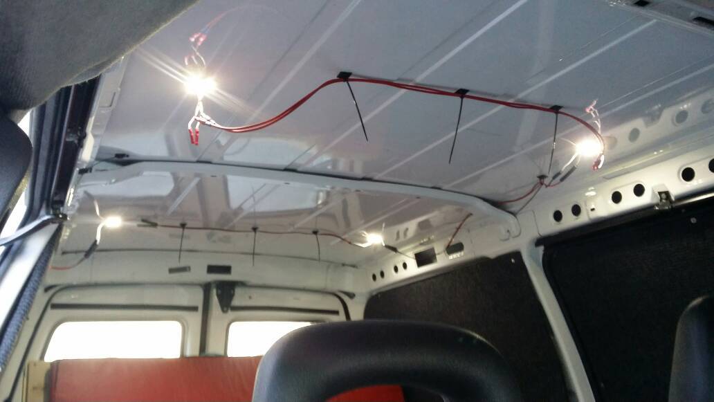

4 point LED van light kit off ebay, superb kit fro 30 sheets! and super bright!
As a aircraft sparky by trade this will all get tidied up i promise!
Ebay fuse box attached.

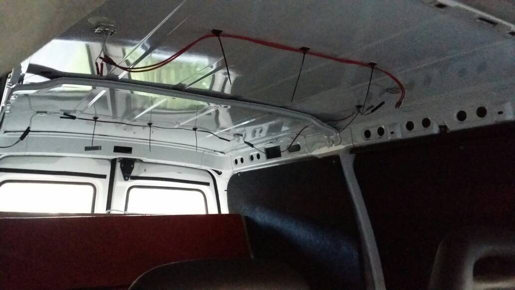

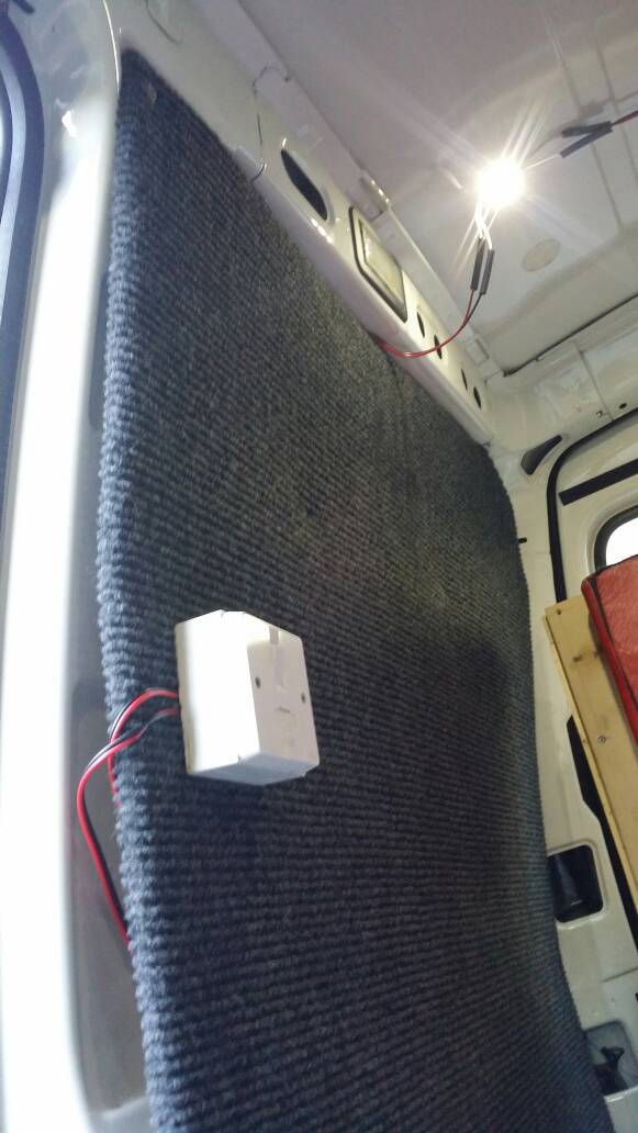

This will all be trimmed with veltrim or whatever its called but heres the lighting.

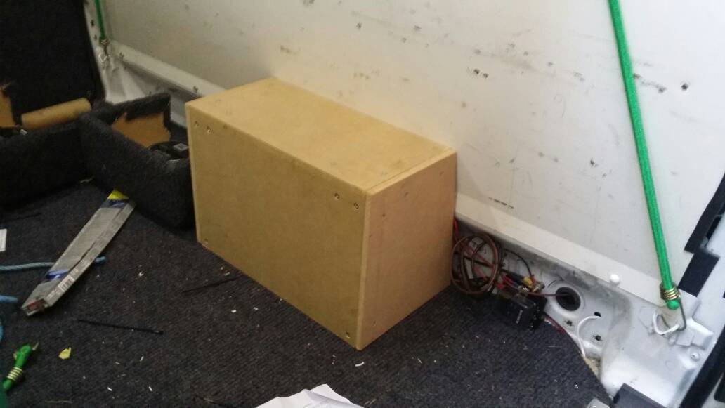

There is noway this box is staying as it looks dump but for now it makes light!
The bulkhead will be carpeted and the box knocked up to cover the battery to!
