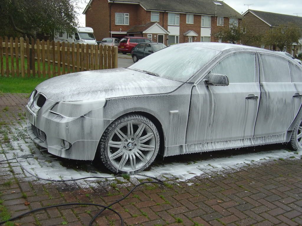

PRE-WASH (SNOW FOAM – POWER WASHER)
  • Open fuel filler flap, spray car bottom to top and leave for 5 mins (Once you have the first snow foam applied, using a small brush and run it along all windows gaps and panel gaps and filled cap area) - Snow Foam (e.g. Meguiars Hyper Wash)
RINSE
  • This Snow Foam (pre-wash) stage is designed to remove all major contamination from the car and paintwork, the concept is to do as much actual cleaning without you having to touch the car – the more you touch the more your likely to actually create swirls and damage to the finish)
REPEAT
  • If I’m going to Snow Foam in the first place I will usually perform 2 Foams and 1 Rinse (foam-rinse-foam) leave the foam on the car as initial lubrication for the first contact wash. I sometimes do the wheels after the first snow foam and rinse and then once the wheels are finished do the second snow foam in readiness for the contact wash.

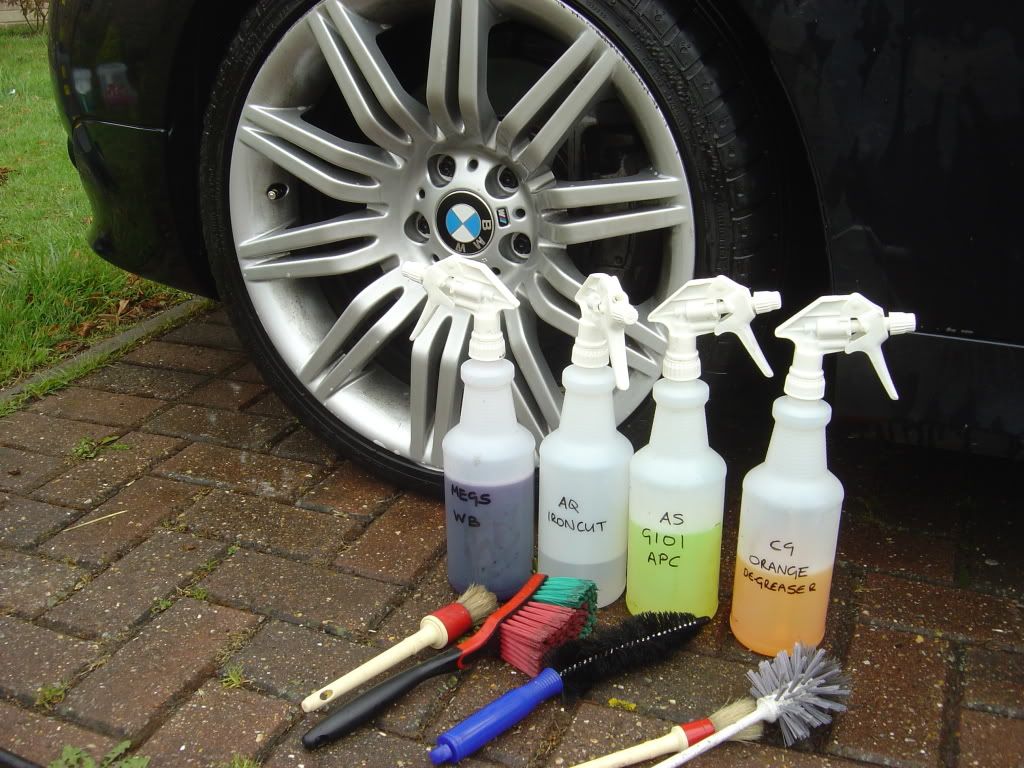

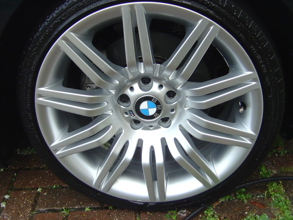

WHEELS
  • Tires first – Use APC (All purpose cleaner) – e.g. Autosmart G101 (best all purpose cleaner I’ve used) spray tires and scrub.
  • Rinse Wheels
  • Clean Wheels – Use Wheel cleaner - e.g. Meguiars Wheel Brightener - leave 30secs to soak (do one at a time, don’t spray all and leave, ever!!)
  • Attack wheels with assorted brushes until done. (use small brush for nuts)
  • Rinse

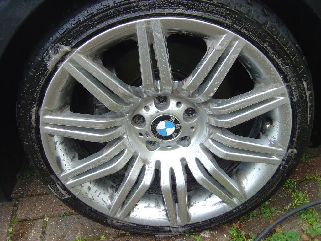

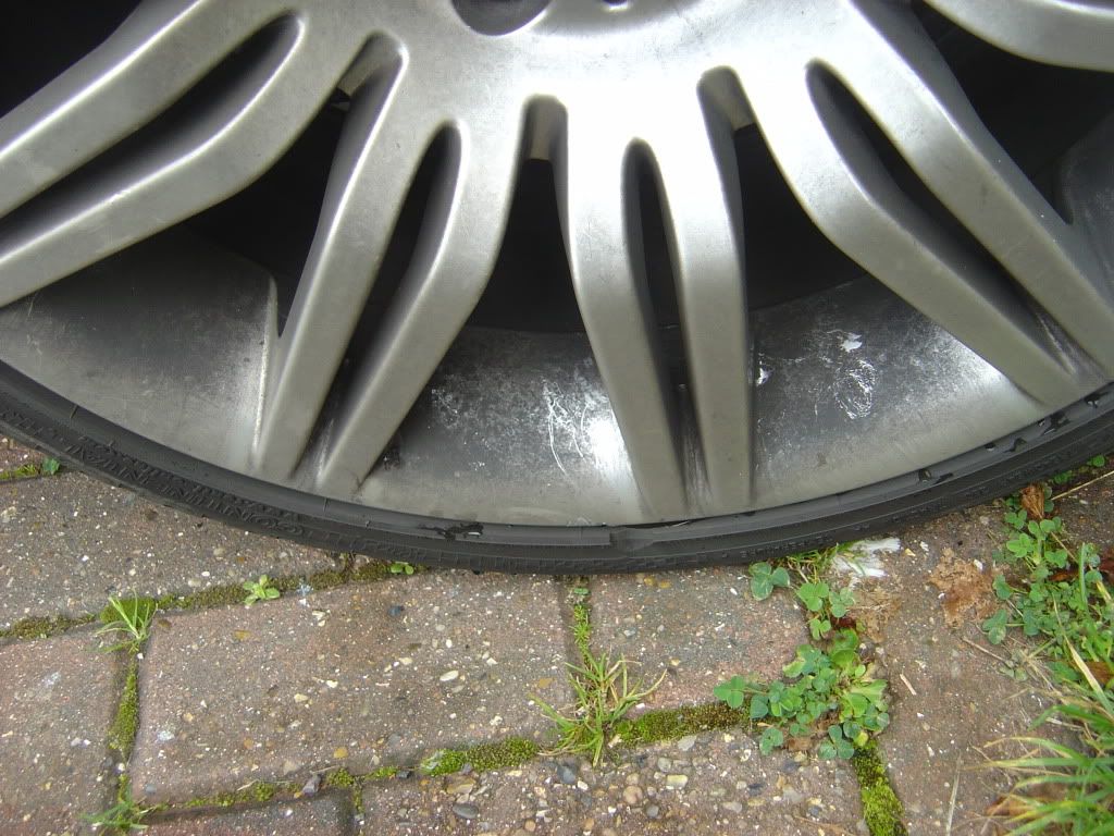

WHEELS (TAR SPOTS AND OTHER CONTAMINATION YOU CAN’T SHIFT)
  • If you have tar deposits these won’t come off with regular cleaning, use Autosmart Tardis, safely melts of the tar, honeydew, bugs, rinse. (I use Tardis on the paint as well as the wheels)

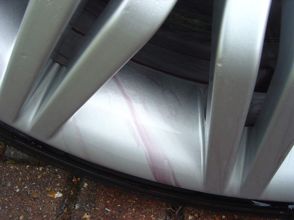

  • For a super wheel clean use Iron-X, this removes Iron contamination (turn red in contact with Iron – you will be amazed at how much contamination you have) - rinse (i've used this stuff on the paint work as well, just be careful). If you have a chrome finish only use ph netural products.

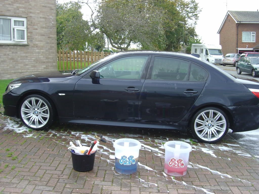

CONTACT WASH (TWO BUCKET METHOD)
  • This is the first physical wash stage on the car and is done using two buckets (with grit guards ideally), one is the wash bucket (with shampoo in) and one is the rinse bucket (just clean water).
  • Load your wash mitt with Shampoo (wash bucket) and wash one area of the car at a time, rinse and clean mitt using rinse bucket and grit guard, now re-load mitt with wash bucket shampoo, repeat
  • The idea is not to use a dirty (grit/contaminated) mitt back onto your car without cleaning it first and to limit the contamination from the rinse bucket and the wash bucket) IT WORKS.
  • I usually have a third bucket for the wheels as well (be prepared)

PREPPING FOR THE WHEEL STAGE
Iron X Product
