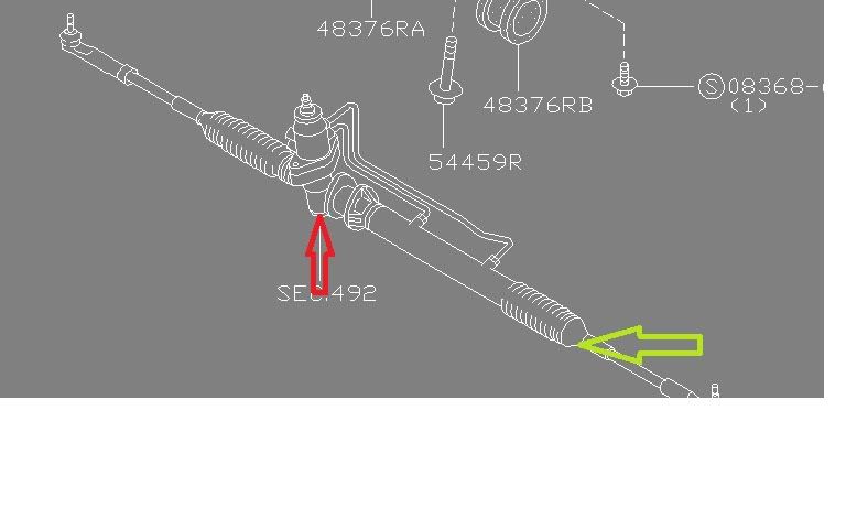

A bit off topic - will s14 steering rack fit s15 ??? (Question to mechanical experts)
I can't see it not fitting mate but don't quote me. It's a really strange problem you've had with it. If it wasn't full of oil you could probably lay a small weld over where the oil is coming from to stop it leaking. Is that part alloy or steel?

It started to leak where the red arrow is
And so I placed a M12 very short bolt on thread lock permanent glue. It worked for 10 miles or so, and then again power steering went bad again. So I went underneath to see if the bolt is still there. But I noticed a new leak - where the green arrow is. So I assume that some kind of inside PAS rack whashers / sealants may be old or I damaged them during long drifting session - like I said before - on snow with lots of steering involved and PAS fluid was overheating.
Anyway - I have an offer to get a full power steering rack for good money, so I will grab it, and leave the old one to get it reconditioned.
Ahh, ok. It sounds pretty shot if the base of it has actually cracked. Are you fitting a S14 one?
