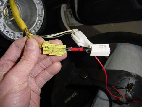

Dean - I've got two connections (basically prong like things!!) which sticks into the airbag harness from the steering column side.
So the two prongs plug into the OEM harness and after that it's just a small rectangular white plastic unit so I can't see inside of it. I don't have a meter to measure the resistance :wack: will try and borrow one lol... or buy one cos it's about time!! :D
Ooh just found someone else's pic for another car but the cancellation unit (white plastic thing with tiny black numbers on it) is identical to the one I'm using ;)
JapanS15
You install the 2 ohm resistor to keep the SRS light from illuminating. Horn is just just a two wire connection. BOSS steering wheel adaptor kit.
i think japan must be right - thats blatantly just a 1p resistor in a plastic box that they add to the kit to cancel the light haha. be good to confirm it though :)

I've swapped mine. If you don't have a two ohm resistor, you can make one out of basic supplies. Google it! :thumbs:

ok will go to maplins and try and get one, btw i think it's a 2.2ohm resistor. What wattage am i getting though?? Also tried to ghetto it and it appears there is no bulb to take out lol
well not unless i wnna stat breaking stuff to get at at ;)
19 January 2009
488
UK
ok i tried a 2.2 ohm resistor connecting both of the yellow wires and nothing happened.
When i used a live current tester, neither of the wires are live is this supposed to be the case??
