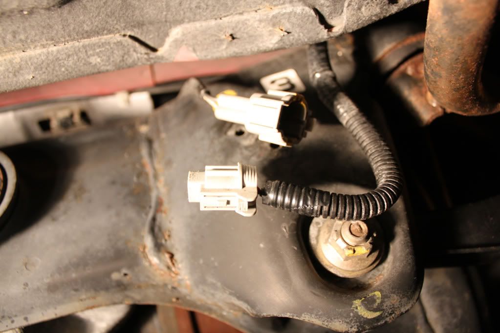

Are you still using the S15 diff? They run a speed sensor which is where the speedometer gets its readings from...
Have a crawl under the back and see if it is plugged in?

After speaking to an old high school friend of my wife's (who just so happens to work at RHDJapan), it made me think about the diff in my car, and if it is stock or not. I went back to the sale listing for my car (thankfully it's still up) and I found that he had an HKS Diff installed. Seeing as how the S15 speed sensor is located in the diff, this could be the cause of why my speedo isn't working. But since I have the 5 speed manual tranny from an S14, I should be able to hook up the speed sensor from the tranny. Now I still haven't had time to open up the dash and since I'm still waiting on my jack and stands to arrive, I haven't been able to look under the car. Hopefully everything is still intact and I'll be able to hook my speedo up to the tranny.
Does anyone know if an S15 speedo will hook up to an S14 speed sensor?

I met up with the previous owner today because my road tax disc went to his box today. Yay! I can finally drive legally, lol. I was talking to him and apparently he had the ABS disconnected. That must be the reason why the speedo is not working. Now I just gotta figure out how to reconnect it. I'm assuming everything is still there setup, but not sure what was "disconnected". Hopefully it's just a fuse or a connection that needs to be made.
