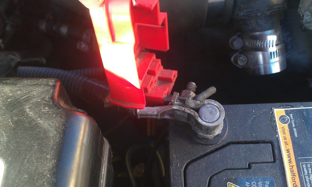

I have a small but well matched amp (the DSL mentioned earlier) and I would like to install this under the drivers seat. There is no danger of anyone kicking it and damaging it as one is ever going to sit behind my seat, and if they do they must physically have no legs. I know this amp doesn't suffer from over heating placed here as I had it mounted under the seat in my old Cooper. I was looking at the battery terminal though in the engine bay and couldn't really see any way that I could easily connect one of the huge thick cables that everyone powers their amps with, how have people got around this issue?

No your spot on with what im talking about, let me use a photo to explain.
The existing cables in the loom have moulded plugs which clip in to the red thing which is connected to the terminal and part of the loom is also crimped in, and where i would normally just replace the terminal as you suggested, it becomes rather difficult with this premoulded connector, and there isnt enough space on the pre-existing terminal to connect an (for example) 4awg cable.
4,636
44
Yeah I see what your saying mate,if there Is enough slack you can just cut the connectors off the wire and clamp the wire into the new terminal block?if not then use a screwdriver to prise openthe clamp holding onto the wire andcrimp ring connectors onto it and buy a terminal with the screw mounting points instead?

Thats definately an option, i'll try messing about with trying to get a connector over that bolt and nut first, if i have no joy with that i will take the suggested route.
