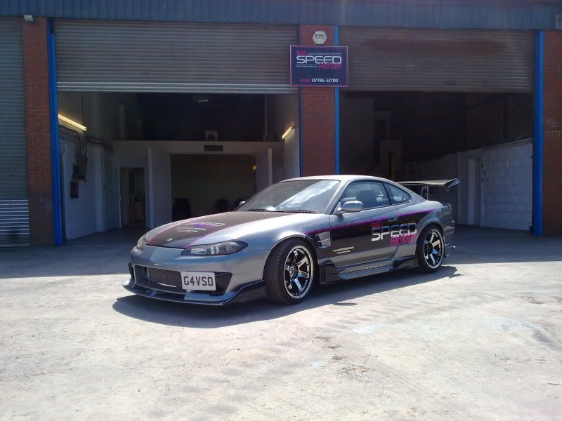

Here you go bud, this will give you an idea of what they look like on an S15:
Best wheels I have ever purchased.

That is sexy, cheers think that has my mind made up.
Where did ya buy? did you get them from driftworks and what size and offset are they please.
I see you have a wide arch kit on her, dont think ill be going down that road, rolling the archs be enough to get them wheels underneath or will they still stick out to much with that offset. Im guessing its about 18x10
