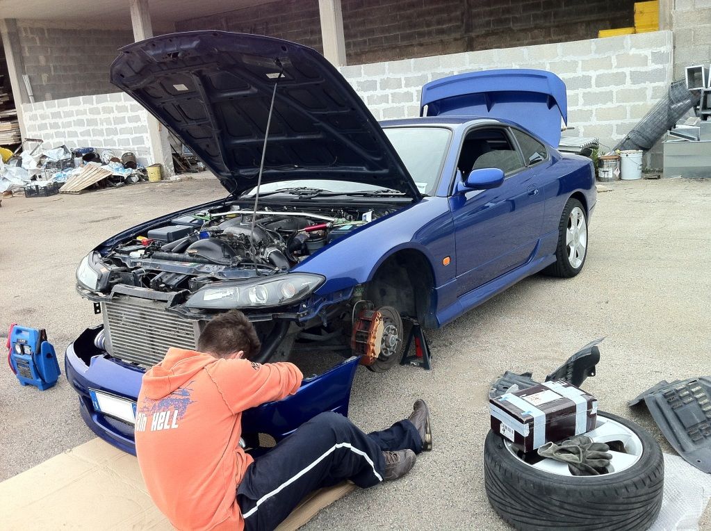

Hi everybody,
I've been on here for a while now (since 2009 or so), never started a build thread for my 15 as it was proceeding very slow due to lack of funds and university duties.
Now I thought it was well time I started my own build thread, so here we go :)
Car's specs as I got it:
ps13 t25g turbo
6speed specR gearbox
tein ss coilovers
xspower fmic/pipes
aftermarket head gasket
Stainless manifold
one piece turbo elbow and downpipe
ksport front 8pot/330 mm brakes, rear stock
ebc redstuff brake pads up front, ferodo ds2500 rear
hks fcd and apexi afc neo 3 fuel controller
"IncredibleCrapPowa" rims
everything else stock apart from some jasma exhaust and arc gauges, and I think it might have uprated pistons (at least the prev owner said so :D )
So firstly a magnaflow road legal (only homologated exhaust allowed here) complete exhaust system with a magnaflow catalyzer went on.

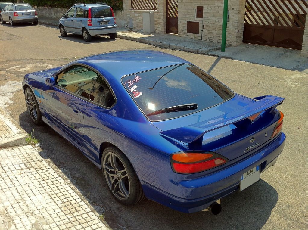

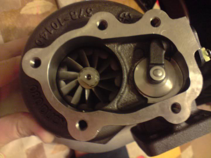

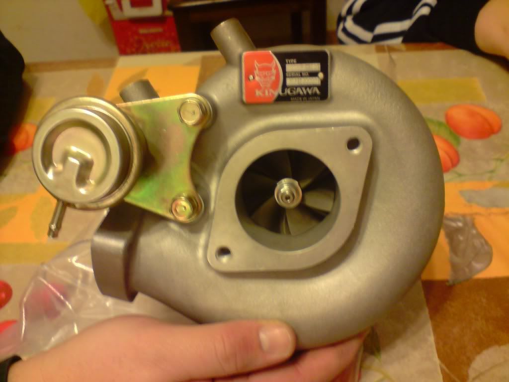

...then the t25g was replaced with a td06sl2/18g from kando dynamics
at first I was skeptical about this turbocharger, but after seeing it in the flesh I was completely fond
the quality is superb, from the v-bands to the wheels, and the overall assembling is finely done.

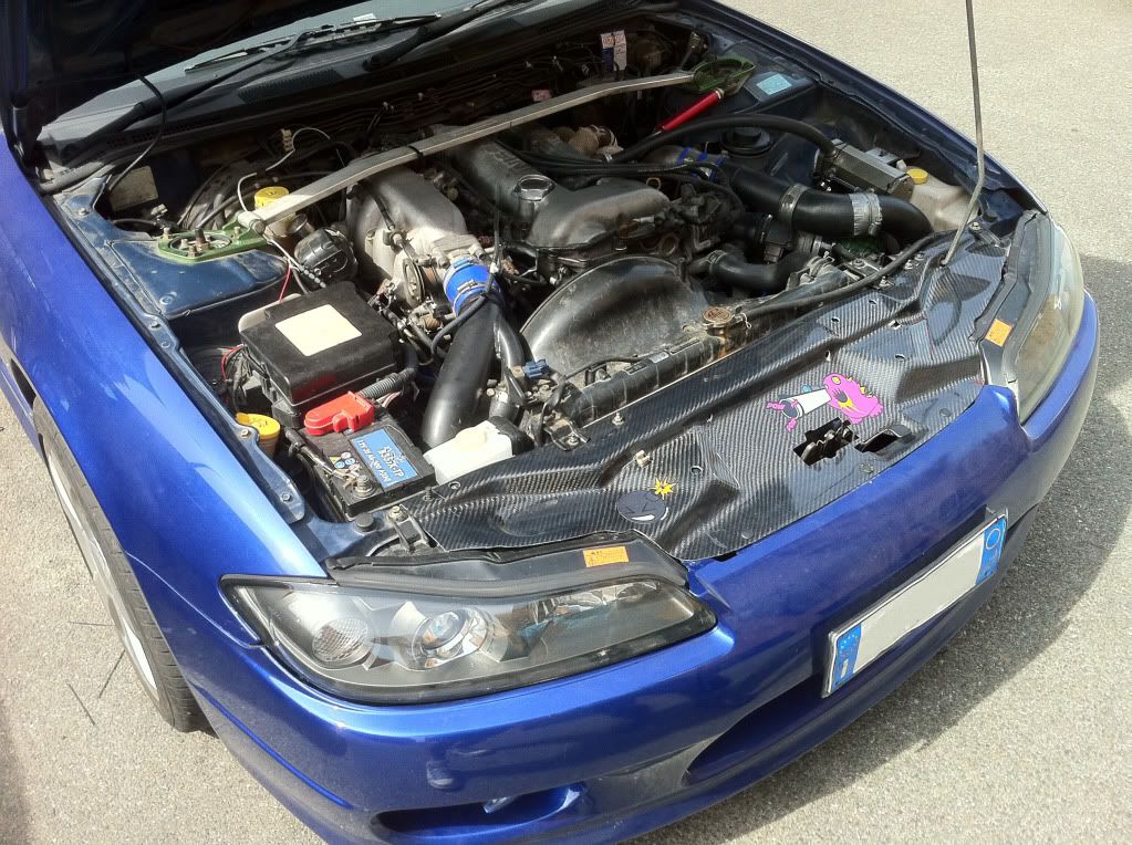

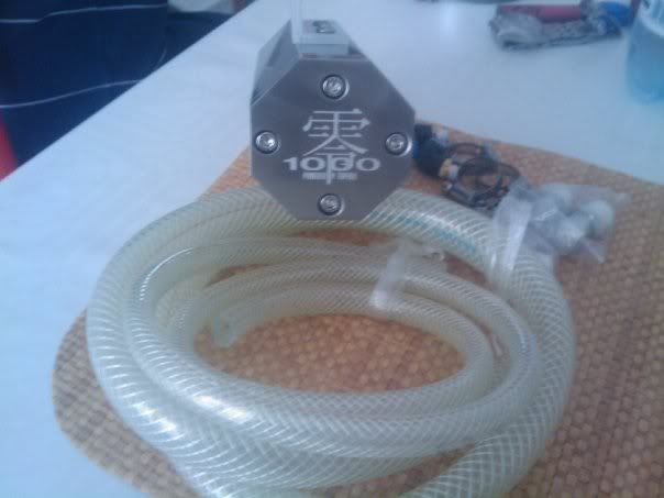

Got a Zero1000 top fuel billet oil catch tank, which in my opinion looks awesome
After some minor boost leak i found my hks ssqv was vell worn out, so I replaced it with an hks sqvII black limited (mostly for the looks of it :D ) and in the same time I fitted the garage defend replica CF cooling panel from s15oc group buy (thanks craig :thumbs:) and painted ic pipes satin black as i just don't like the chrome :D
sorry about turbozilla being too awesome to even look at, but I didn't have any other picture to show :D :D :D

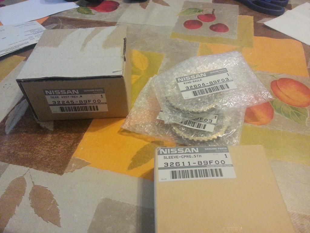

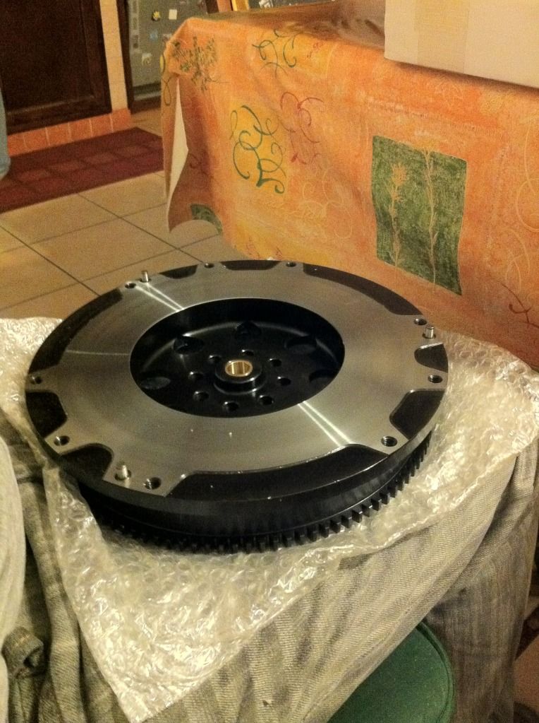

Last summer the XTD clutch that was fitted as soon as i got the car decided to die and kill the gearbox, so i got another one from craig8585 on here, and bought a replacement disk for the os giken super single that came with the car.
Too bad the guy that fitted everything back in, which claims to be a maximum expert in tuning imports, didn't fit the central bushing on the flywheel, so after a few months I ended up with a broken 5th gear and synchro coupler.
I actually felt something was completely wrong with the box, and before it broke, thinking it was the clutch again, i had already bought a Driftworks 6speed specific flywheel and an exedy organic clutch kit, so I just had to order a new 5th gear, synchro coupler and synchro rings...
the Dw fly looks awesome, plus is just as thick as the dual mass one
you can actually see it's made out of a billet unit then machined out and not simply cast and balanced like some other ebay crap... thumbs up for the DW team :thumbs:
genuine nissan goodies straight from Japan :cool:
So with the gearbox rebuilt, fresh motul gear300 oil and fly/clutch ready to go in, I found (with my new mechanic) that the os giken flywheel bolts are 5/10mm shorter than stock ones, so only 2 or 3 bolt threads are coming out from the flywheel. After a bit of research i ended up ordering new genuine nissan flywheel bolts for dual mass fly straight from nissan japan, as here in Italy it appears nobody is selling 10.9 grade M10x30/35 pitch 1.00 bolts (you can only get them in quantities like 1000+)

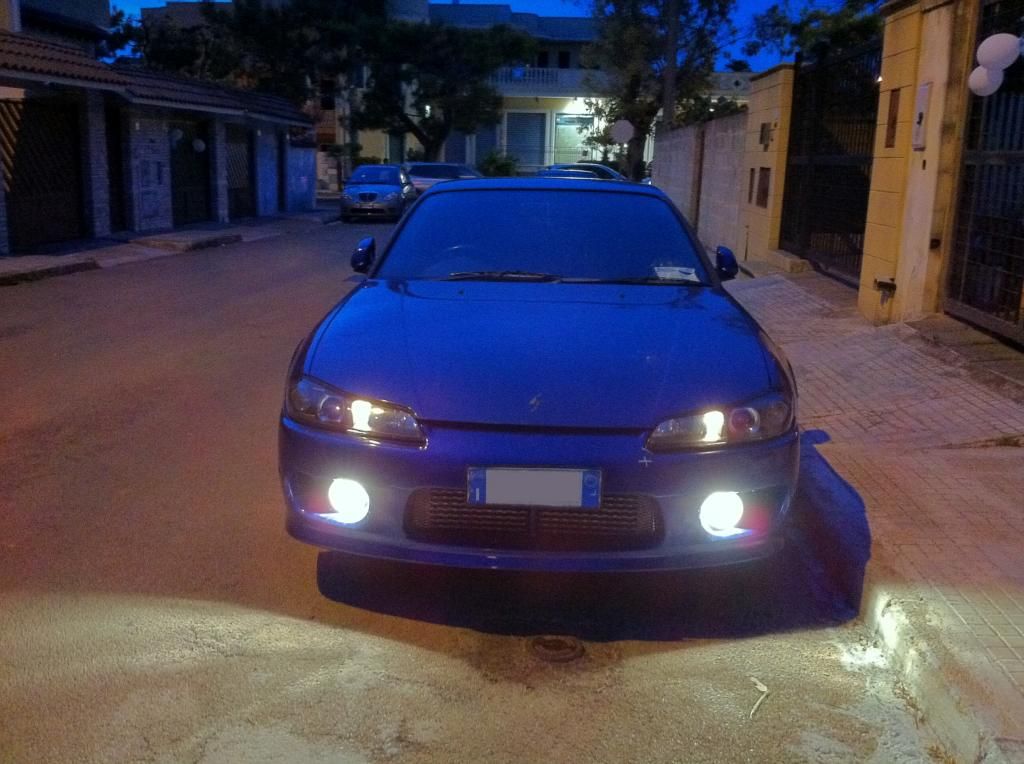

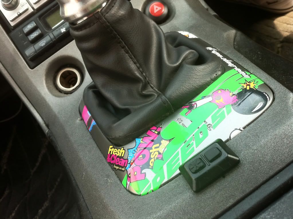

Got a set of oem foglights which went on along with some black grilles ...and yes, that super-handsome guy dealing with electrical wires behind the bumper is me
I love the OEM look :smitten:

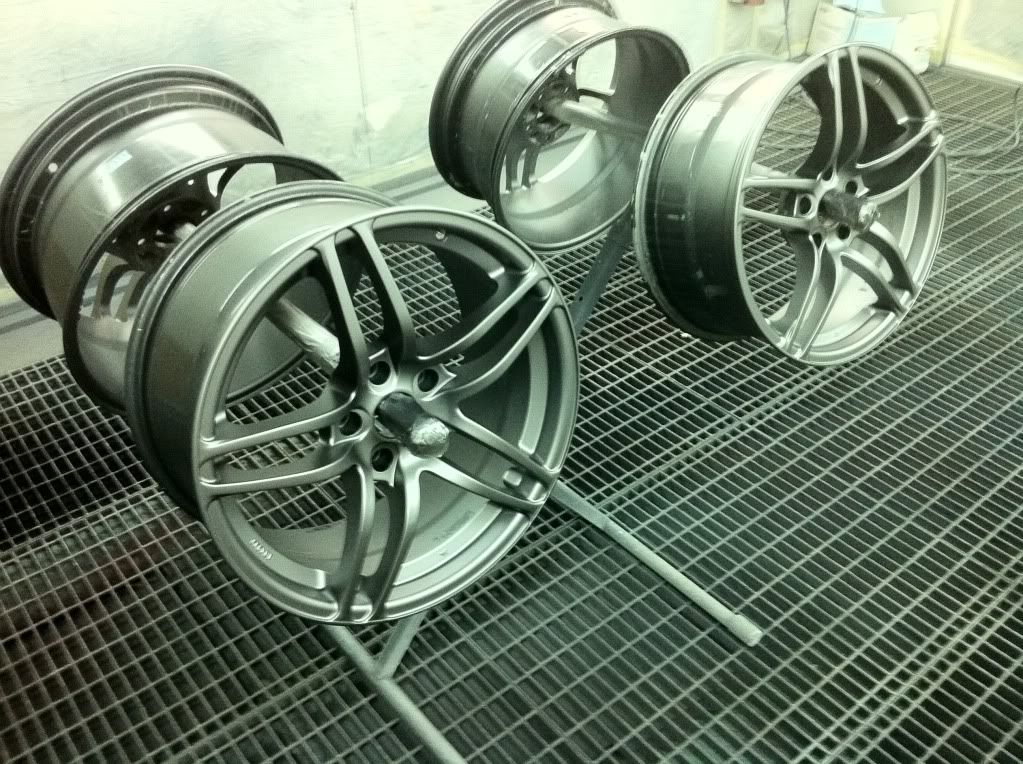

As everybody knows, at some point in our life Rims happen... you just can't help :D
So I got myself a set of advan model 5 replicas for a complete bargain, got them powdercoated in gunmetal and slapped them on right away
And some bonus sticker loving...
It's good for you

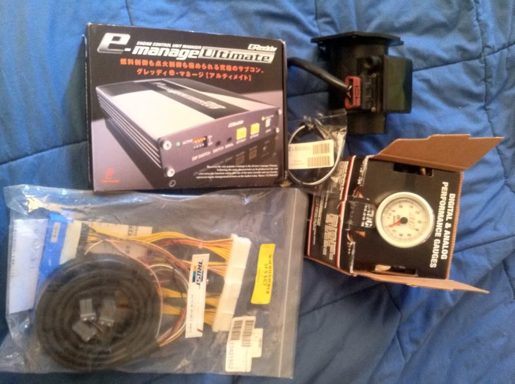

Got an uego wideband with the analog face (the one with fancy lights just doesn't fit me) along with a greddy e-manage ultimate ecu.
Of course the z32 maf was needed :D
Now regarding this particular ECU choice I actually bought it since it was the only one which I could have tuned by myself (I didn't have access to a tuner at the time) using the a/f target map and a couple other very helpful features such as injectors size and lag time auto trimming. Also despite being a piggyback ecu it has the same fetures of some of the most known standalones like the power fc, and after seeing it shining in the D1GP trust s15 dashboard, I decided to give it a go.
When I finally found a very good tuner that's worth the name I decided to trash the distributor and convert the car electronics to full specR including cas, coilpacks, ecu and engine loom, so he could be more confident in tuning the car to a good level, instead of just trying to make it work :wack:

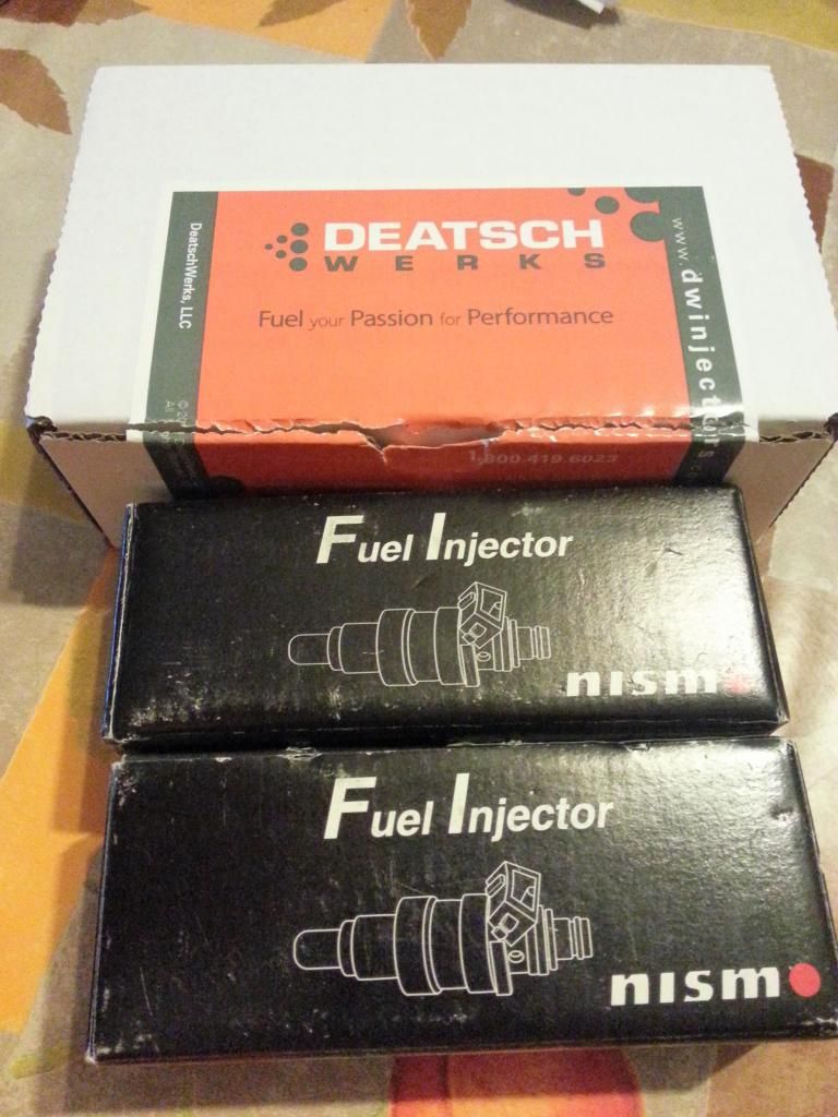

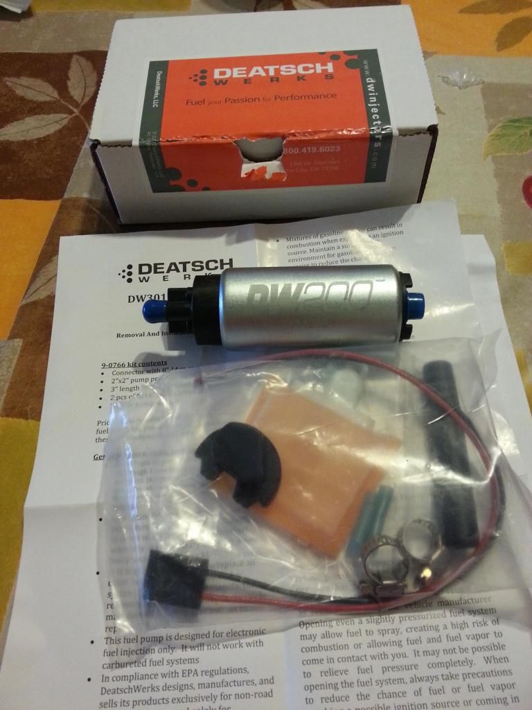

Late this summer I managed to get a used set of nismo 555's in mint condition off a buddy on sxoc , which assured me the injectors were used just for tuning and a track day before his s14 was broken for parts.
...Deatschwerks DW200 Fuel pump.
so once I'll find a replacement suel sock (the one included in the fitting kit is way too short) my fuel setup will be finally ready for tuning

The alloys in gun metal grey are stunning. Great choice.
and a thumbs up for the OEM Fogs.:thumbs:
I'm not a fan of the sticker bombing though, Seen it to many times in my VW Ownership.
But otherwise I love the car, Blue is of the best colours for the silvia.
Look forward to seeing more :D
eiden88
7 May 2009
302
Lecce ,Italy
Thanks mate, I'm glad you like it ;)

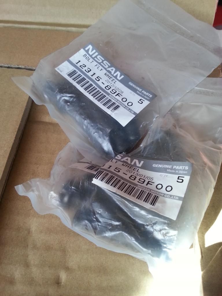

Flywheel bolts arrived
I'm away from home for university duties and won't be back until end of Feb. Then I'll be probably have a chat with the tuner to get fuel setup+ecu+ loom+ vvt on and to book the dyno for tuning...
