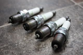

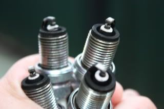

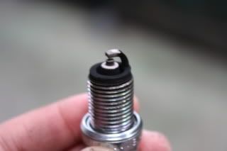

BTW, here are some pics of my sparkplugs a day after the symptoms appeared. These were brand new plugs 2 weeks ago. NGK-R BKR7E (comes pregapped to .8 i think)

I would say coilpacks as well, but carefully check each spark plug, as I had a hairline crack in one of mine and it missed it. This only effected the car on high boost though, but I'd still double check each plug if I was you.

Your plugs also look fairly black, I wouldnt know how to go bout loookin into that but mine arent that black after a month :\..

Your plugs look to be in a too rich environment unless there is a misfire caused by a weak spark.. It looks to be all plugs so I would check earths on the back of the head for the coils first before expecting it to be coils themselves.
But the map could be too rich causing the plugs to foul.. I would get another cheap set of plugs and if it cures it then you need the car mapped to correct afr's..
