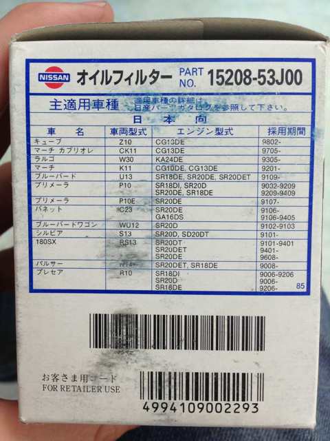

I can't see vq35. Does this look ok
Although I'm unsure it's the right one as its for this apparently

I personally think its the wrong one, it doesn't list any of the relevant engines on the box, and only the s13 sr20det which uses the wrong thread.
Sparky listed the Nissan part number in post 5 I think.
Also s13 share the same filter as skyline hence why opie oils may sell it.
7 January 2007
699
Perth, Wait Awhile
Yep - if it says S13 SR20DET, then that's the wrong filter
The S13 filter is also slightly bigger than the S14/S15 filter so you will notice it's the wrong filter straightaway, used to have the pic to show the size difference but lost the pic now

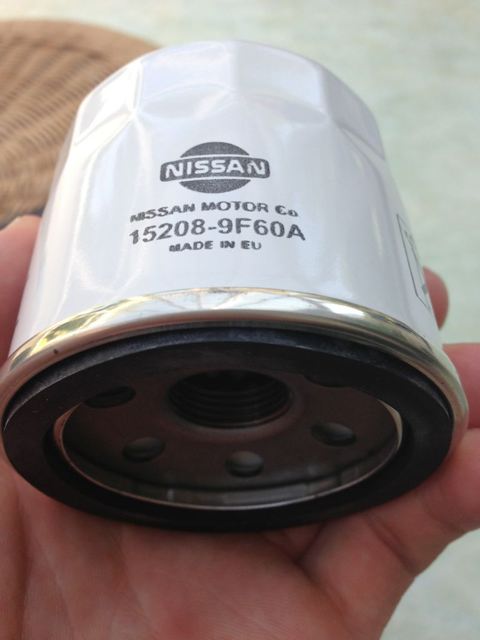

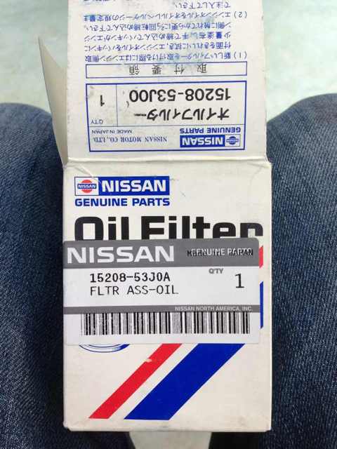

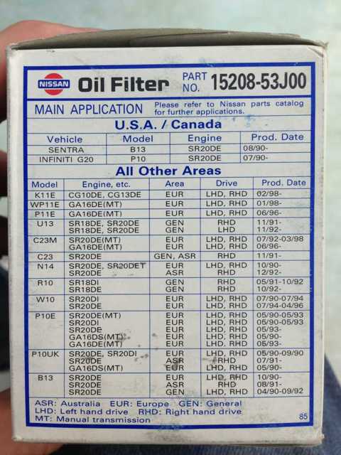

Turns out there is a new Nissan dealership close to me!
So I got this:
I'll be sending the other one back, and telling Tegiwa that they're not used for s14/15's
