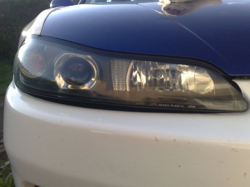

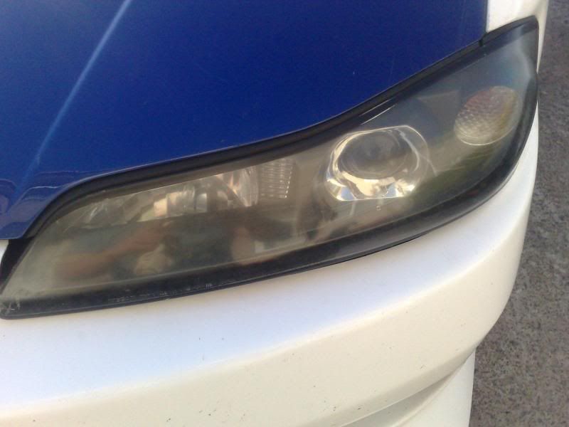

Hi guys have any of you wondered if you could somehow seperate the glue on the front lights to clean behind them because they are looking very tired?
my mate told me the other day to go out and buy some autosol metal polish and polish the lights, i was like what? metal polish what the hell is that going to do. Out of curiosity i tried it and couldn't believe it.
Here is before and after guys, what a difference i am shocked. Just thought anyone else with the same problem as me could do this :thumbs:
Before:
After

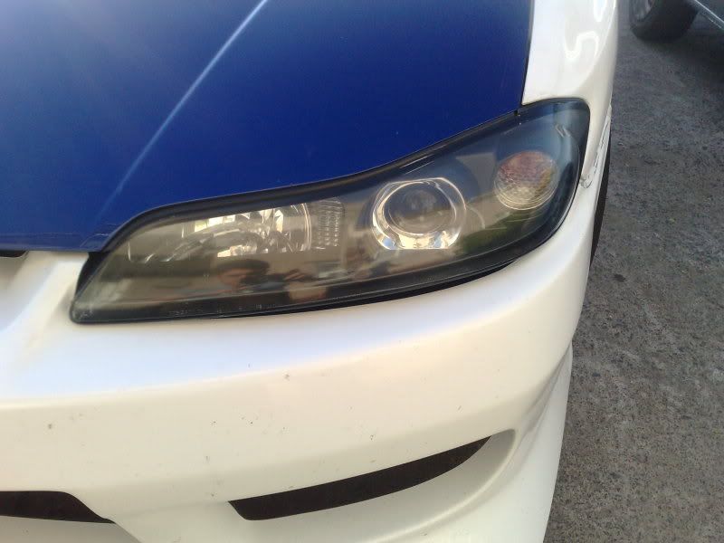

here is the left side (don't have a before and after as pic didn't save)
