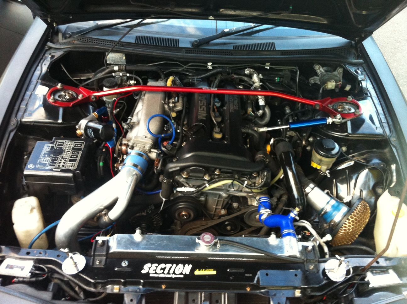

How it looked in NA config.

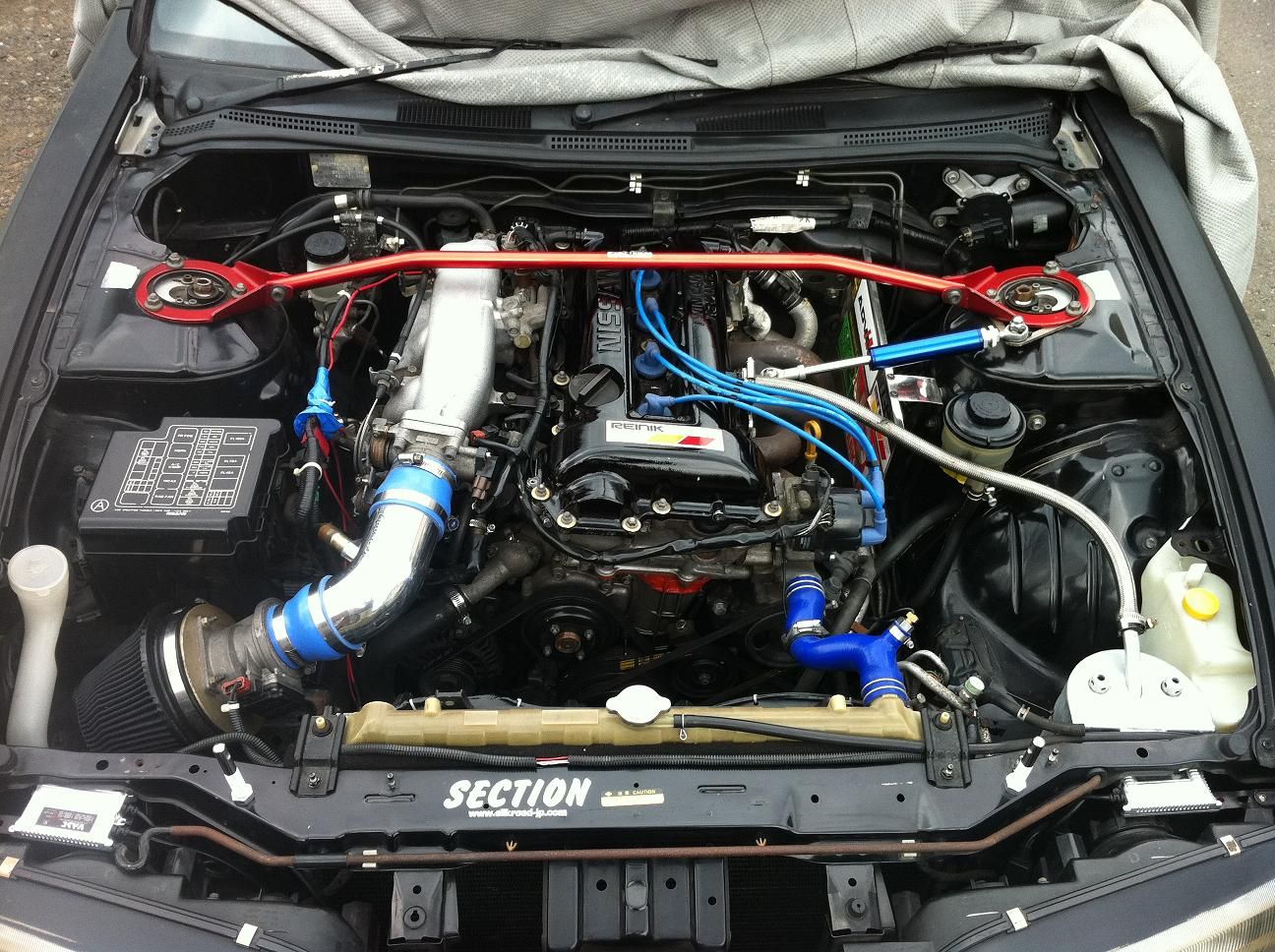

So in she sat, manual DIY boost con and all lol

With the S15 motor fitted and running like a champ. Really good this motor and pleased to say it has great comp and oil pressure.
Bit of housing keeping on the mani, replacing injector insulator seals.
And routing Nismo FPR. Have it set at 3K as of now.
