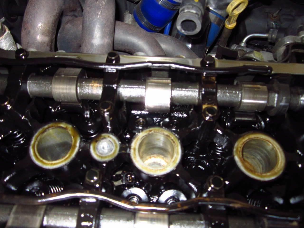

Bee-r on there?? or just a rev limiter whore?? lol
9 September 2009
1,864
oops..... RAS aren't full proof are they, now comes the bit where you have to try and find all the broken bits, and martin's point freakin black in there.
That's nasty. It's not often rocker arms break.

excellent!!! i had the exact same problem with my spec r, and like you it wrecked my head for a full day (today actually) of testing wires in the loom, swapping plugs and coil packs and ended up getting sick of it, couldn't get #2 to fire.
so i had a look on here after i gave up on it and saw this thread, went striaght back out to the shed and RIPPED off the rocker cover to find the exhaust rocker arm sitting out of place under the cam shaft:D, not broken but out of place, just the........i'm not a mechanic so just the little thing that sits on top of the valve and keeps the rocker in place is broken so i'll have fun finding the missing piece of it in the engine somewhere.:(
thanks for posting this up man, saved me alot of time and head scratching:thumbs:
