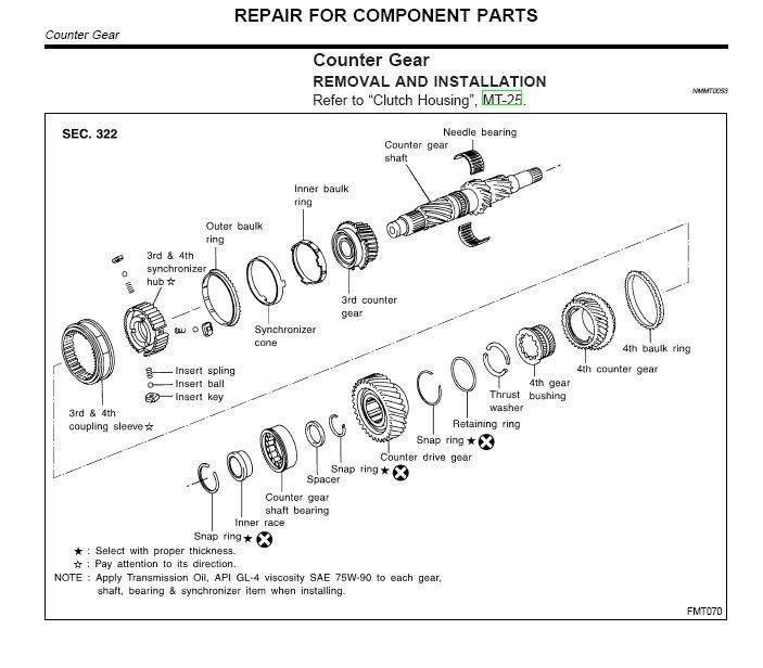

i stripped the box earlier tonight, and everything seemed in order, but found one suspect bearing on the front of the layshaft. (in diagram labeled "counter gear shaft bearing")
Going to order one of these tomorrow.

As you suspect the layshaft bearing is gone, it may explain the noise in 3rd and 4th.

I dont see any bearing for the imput shaft to locate. however there is a bush there that 'may' do the same job. P/N 32202-b9500
Also, that counter shaft bearing that yoou suspect. i think i found the P/N for it too. 32219-89f01

The small bearing/Bush, also known as a pilot bearing, i have one on order from the Local dealer,
And the Counter shaft bearing is a standard size bearing, which the local bearing supplier had on the shelf:thumbs:
Turns out the bearing supplier couldnt come up with the goods, so i have both bearings on order from nissan, but been snowed under with other work since. I have the box stripped, just waiting on the bits to arrive..:mad:
