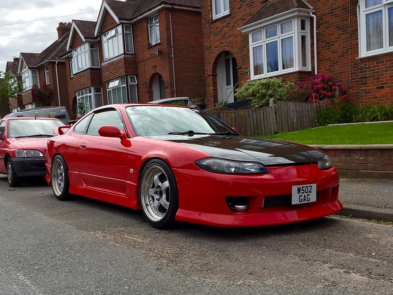

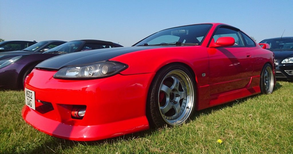

So after many years of Japanese car ownership I’ve finally saved up enough for an S15!
After many months searching I finally found one I really liked with a massive spec list! After viewing the car a deal was made and a couple weeks later I collected the car with my friend Jamie.
IMG_0252 by Josh Jennings, on Flickr
I was extremely happy with it however after driving it home something didn’t feel quite right with the suspension and it needed to be raised as the roads on the Isle of Wight are shocking. During adjusting the suspension all the pre loads on each corner were different and the camber adjustment on the front left was completely loose and the right side wasn’t done up that tight either! With the suspension sorted it was now looking like this!
IMG_0265 by Josh Jennings, on Flickr

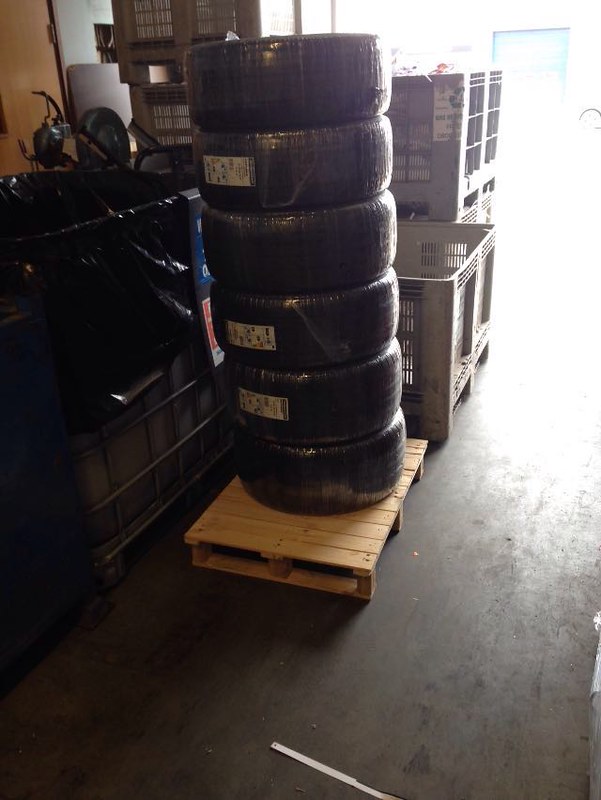

I’m not a fan of stretched tyres so while the suspension was being adjusted my friend and I worked out the tyre size and spacing that would allow them to fit correctly. I noticed the rear wheel studs had been cut in order to fit 20mm spacers so I decided to order ARP extended wheel studs to allow correct fitment of the wheels.
IMG_0327 by Josh Jennings, on Flickr
The 235 front tyres and 255 rear tyres were ordered as well.

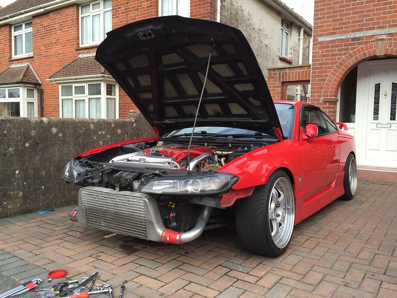

So what turned from wet sanding the headlights turned into this… haha! All the headlight wiring was shortened and re-routed.
IMG_0604 by Josh Jennings, on Flickr
The intercooler piping was removed and checked over and given a quick polish. Also worked out what silicone hoses were needed, I’m not a fan of the red ones and some were pretty bodged together so a whole set of black samco ones have been ordered. When putting it back together I made sure to tighten the hose clamps down properly as they certainly weren’t done up much when I was pulling it apart!

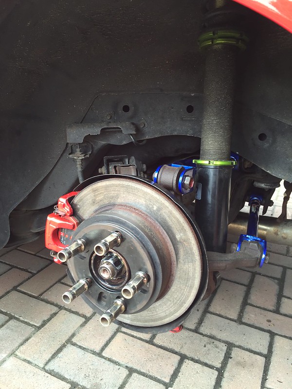

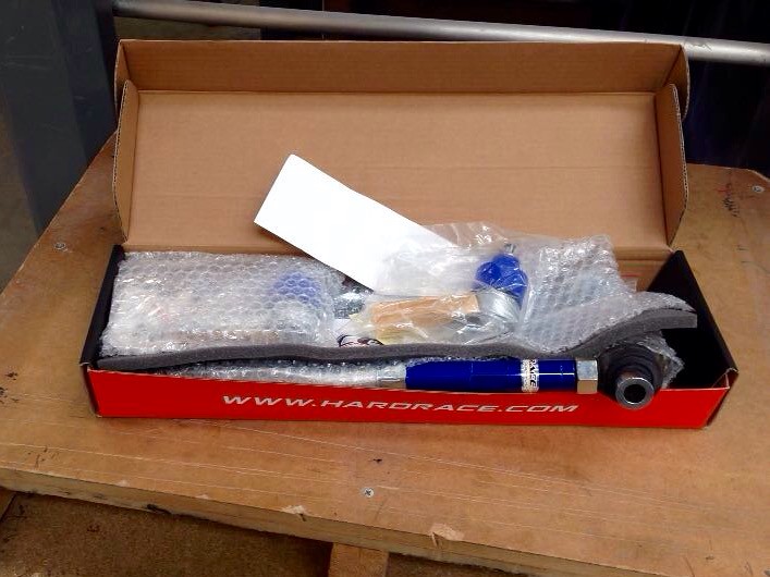

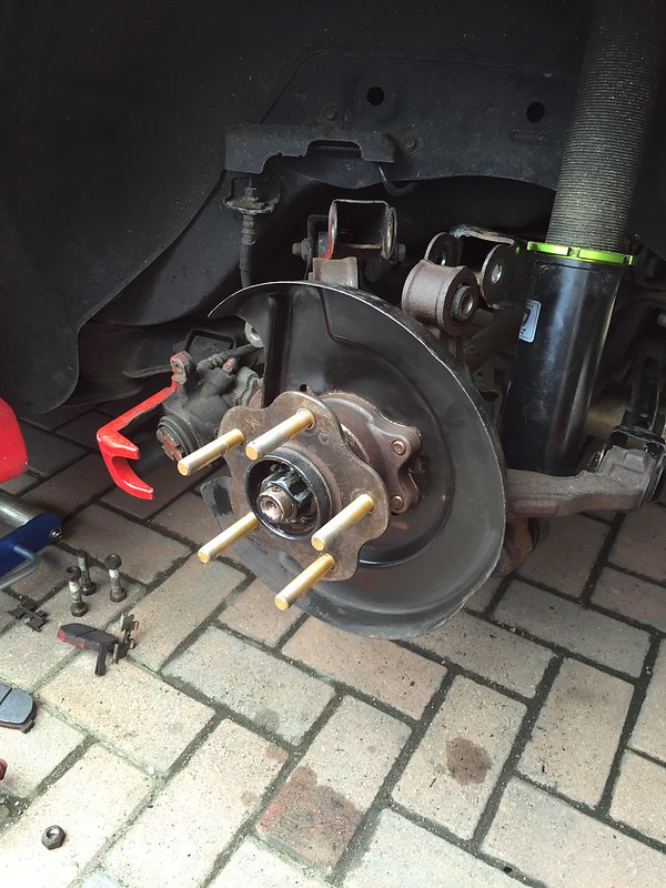

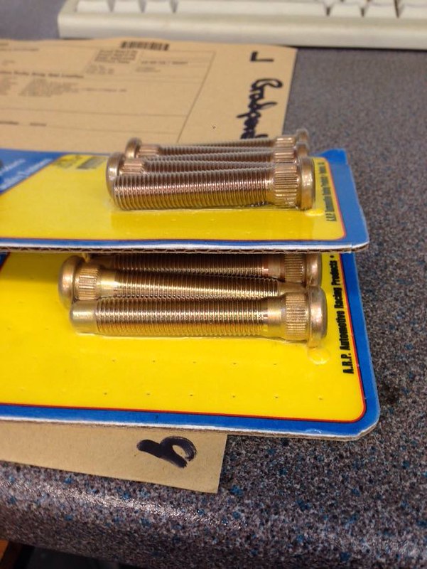

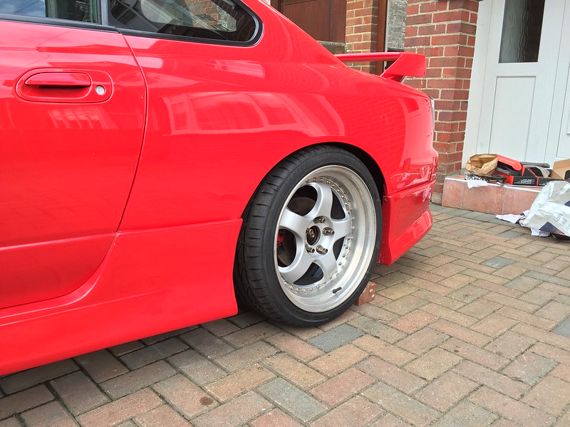

I then set about fitting the extended studs on all 4 corners. When fitting these I also got the Hardrace rear camber and toe arms fitted.
IMG_0859 by Josh Jennings, on Flickr
IMG_0860 by Josh Jennings, on Flickr

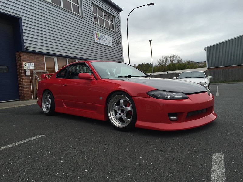

The tyres were then put onto the wheels. Safe to say I’m a lot happier with the spacing and look of the wheels now!
IMG_0865 by Josh Jennings, on Flickr

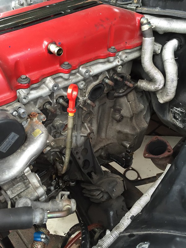

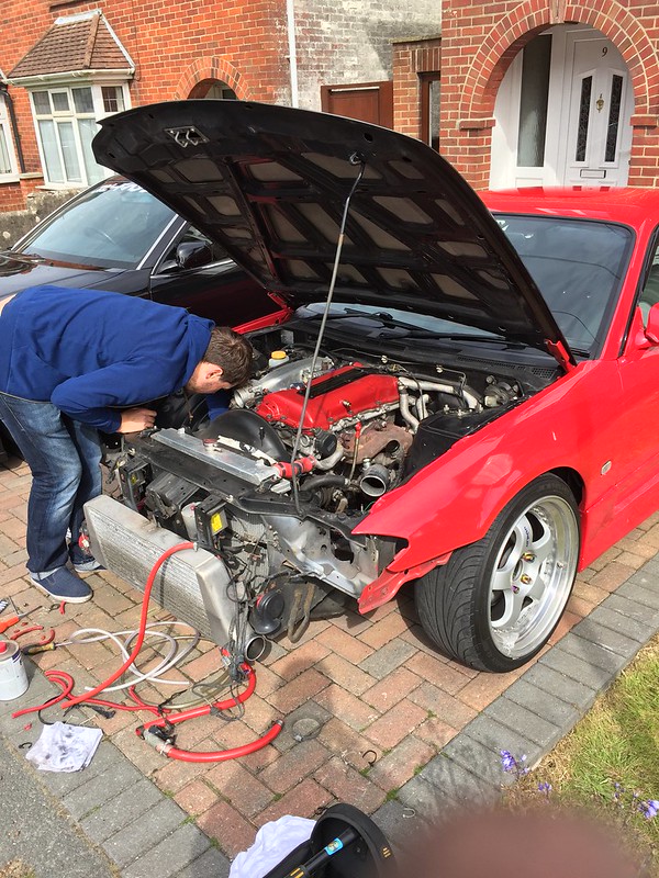

When I was driving back to the Isle from the meet I noticed a slight exhaust leak. After driving for a couple of more short journeys to see the misses it soon turned into a major exhaust leak from the mani to the turbo!
I set about stripping it down. When undoing the bolts to the mani etc. I found that all of them weren’t done up nearly tight enough! My friend came round to help me pull the mani and turbo out while I was undoing the final bolts underneath, he pulled the mani expecting the turbo to come with it… just the manifold came away! The nuts had worked themselves loose and weren’t even present anymore!
With it all out I was left with this!

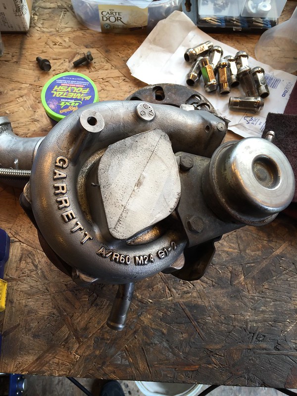

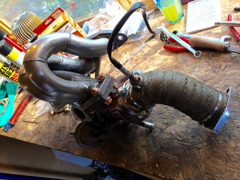

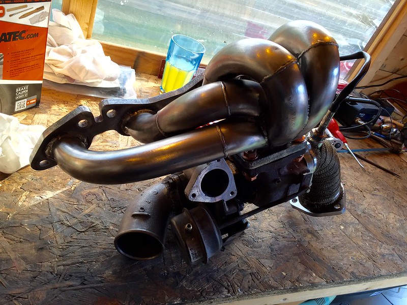

I decided to give the turbo a good looking over and clean up while it was off, would be rude not to haha!
IMG_1012 by Josh Jennings, on Flickr

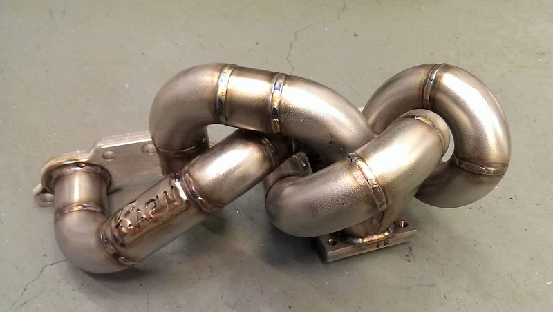

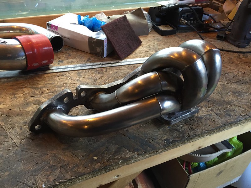

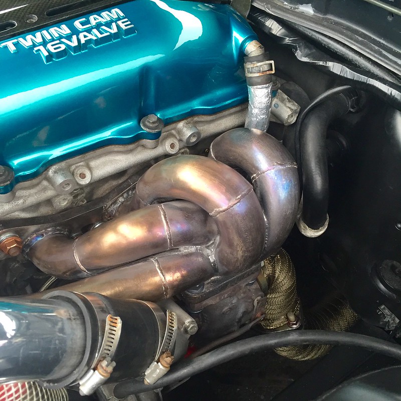

The previous owner had included a tubular manifold that had cracked. I went round to my good friend Joes and he welded up making sure to beef all the welds up significantly. We also added some bracing from each flange to try and help prevent cracking again. Hopefully this will sort the problem, if not I will just go back to the standard mani. I gave it a quick clean up, not perfect but so much better than it was!
IMG_1029 by Josh Jennings, on Flickr
I’ve got a stainless turbo elbow on order and the downpipe has been taken off the car ready for a clean-up and heat wrapping.

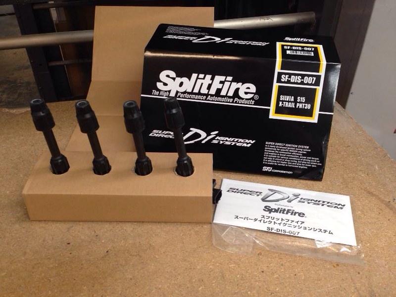

Today my Splitfire coil packs have turned up so they’ll be fitted this eve!

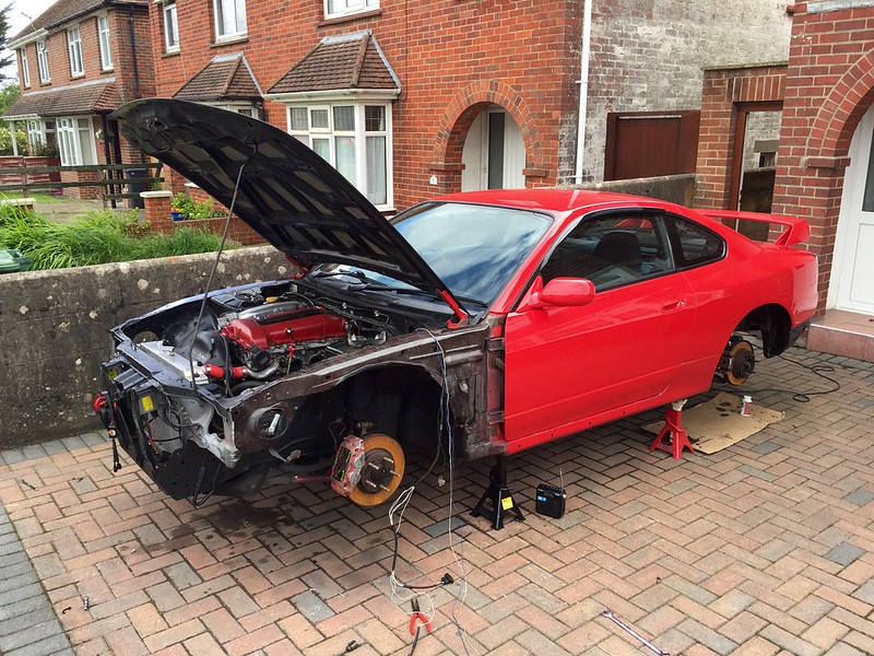

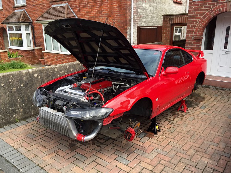

So last week I had a week off work and may have got a bit carried away with doing some jobs on the S15 haha!
Untitled by Josh Jennings, on Flickr

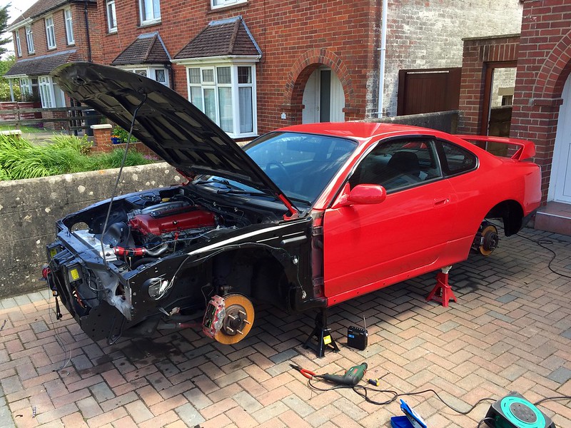

So with the coilovers off, body kit off and exhaust off the chassis was then prepared for protection. All the arches were wire brushed back to bare metal, any rust treated, zinc primer applied and then a nice thick layer of stone chip applied. I then got a bit more carried away and decided to do a wire tuck on the passenger side for now. I will do one on the other side but I want to drive it again soon haha!

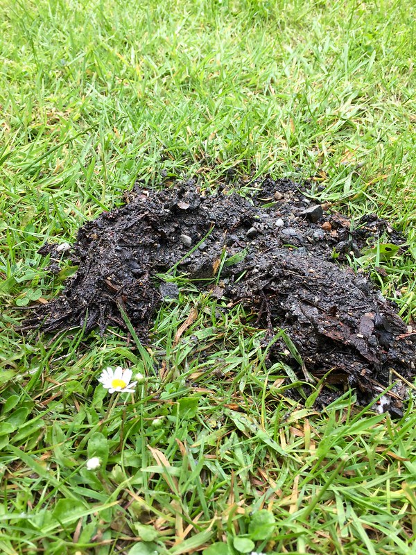

This was the dirt that came out the bottom of the front fenders, it had just been sitting there! It won’t ever be like that again haha!

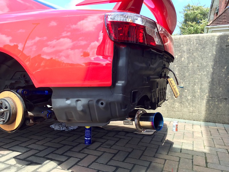

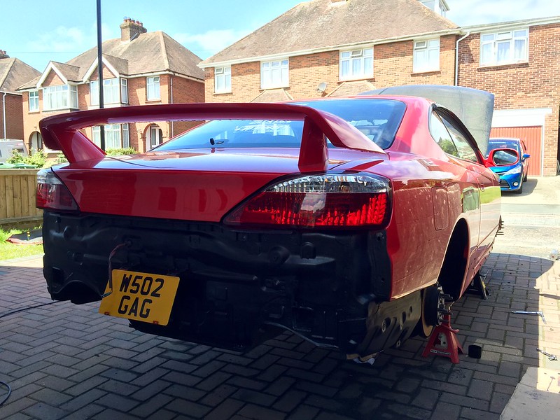

The same was carried out behind the rear bumper.

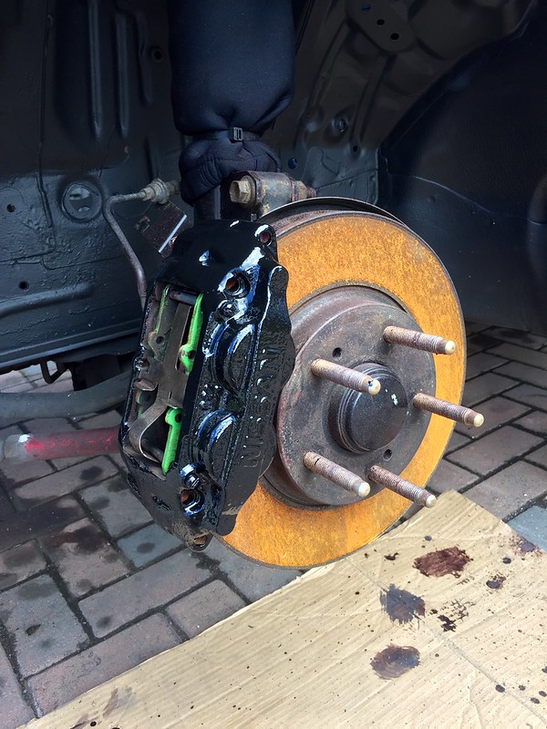

I then painted the brakes black, I hate red calipers with a passion! I will sand the Nissan back to bare metal once the paint has hardened enough. You can also see the coilover covers I fitted to keep them in mint condition.

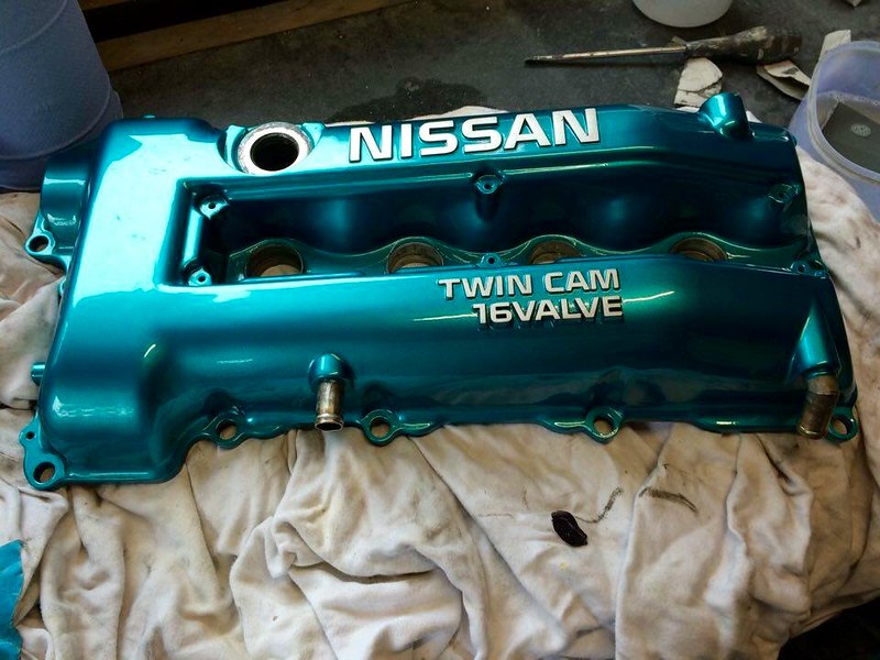

I got sent a picture of my replacement cam cover after being sprayed the other day. So pleased with this compared to the horrible one that’s on there. Think it will transform the engine bay.

I also re-assembled the turbo setup, I might have over engineered a few bits, but I don’t want the gasket leaking again haha!

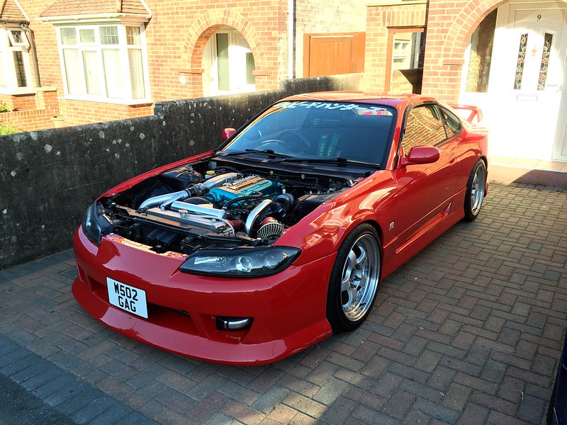

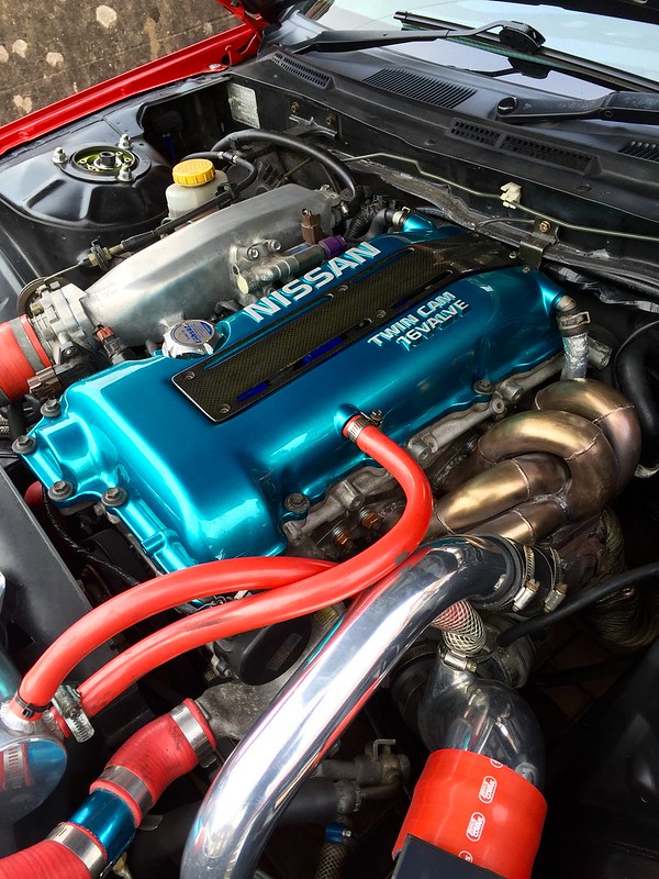

It’s all back together now, I couldn’t wait for these blaady black silicone hoses any longer so the red ones went back on for now! The engine feels so much stronger now, don’t know if it’s the manifold, the Splitfire coil packs, or just the fact it’s all tight now ahaha! But it feels smoother, pulls better and there is definitely more power up top now!
Still need to get the alignment done but it’s all booked in for next Friday.
Got the cam cover fitted last night, looks so much better, can’t wait to sack these red hoses off!
The manifold is going nice colours now as well haha!

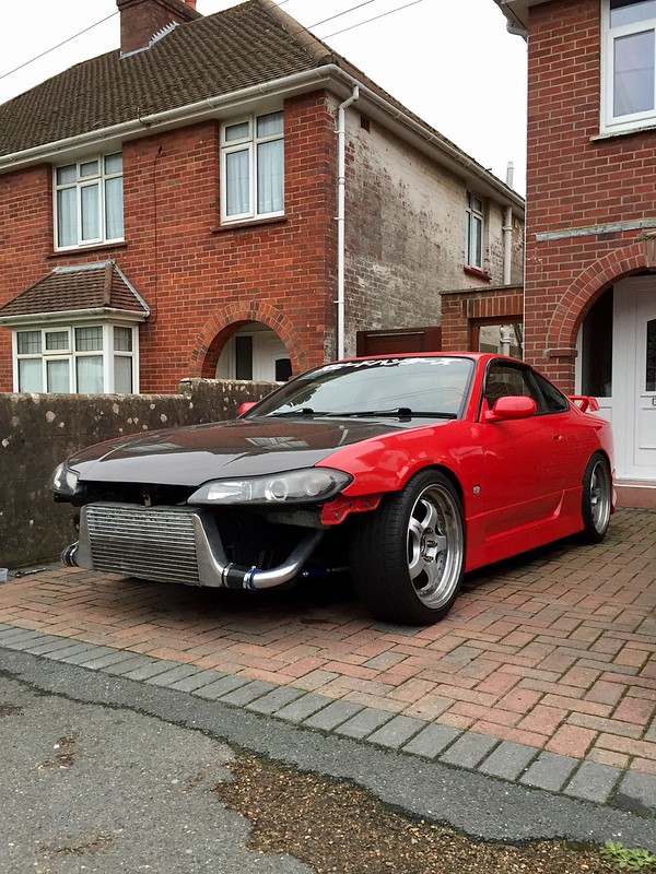

Finally got my alignment done, drives so much nicer! It’s got just under 3 degrees negative on the front and 1 and a half degrees on the rear. It still spins the rear wheels up even with 255s haha!

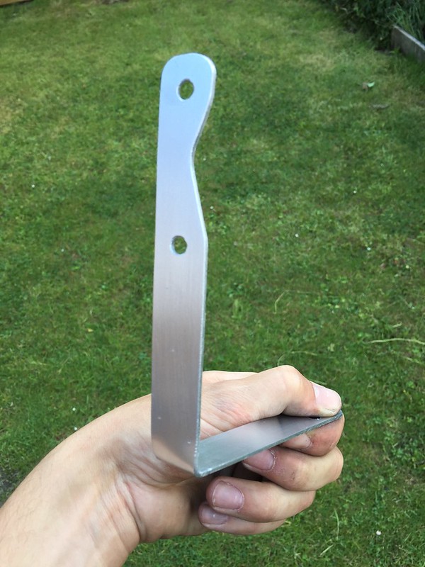

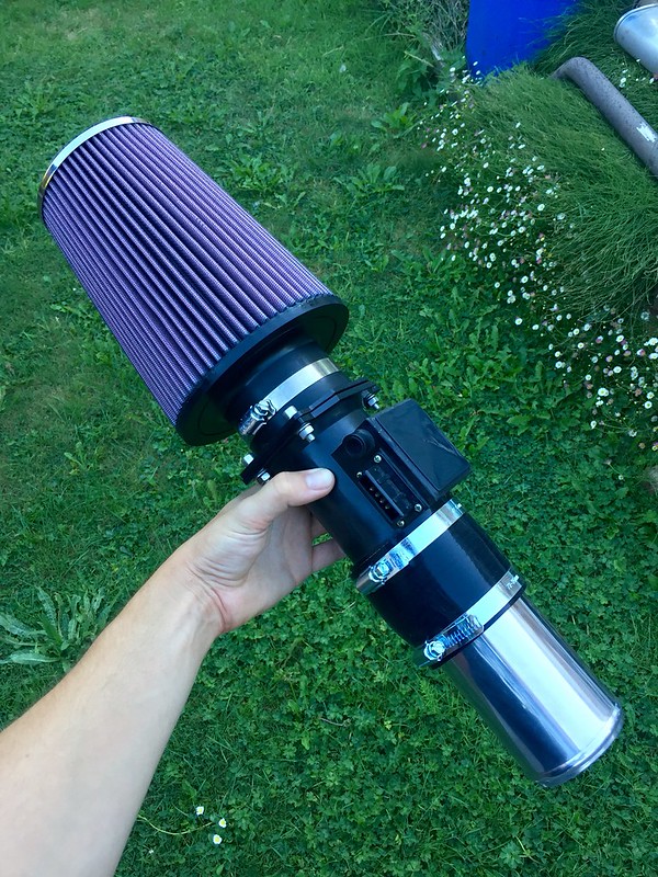

Made up a bracket to hold my air filter in place… Not that interesting but I was pretty happy with it haha!

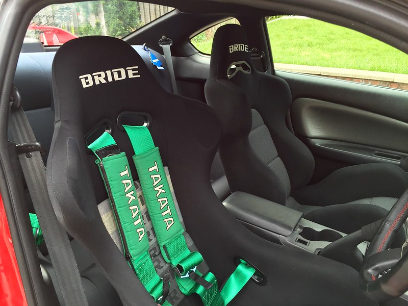

After winning a passenger seat rail off eBay the other day, I moved the driver’s Bride to the passenger side and put my Zeta bucket in the driver’s side with a Driftworks rail. Love the driving position even more now!

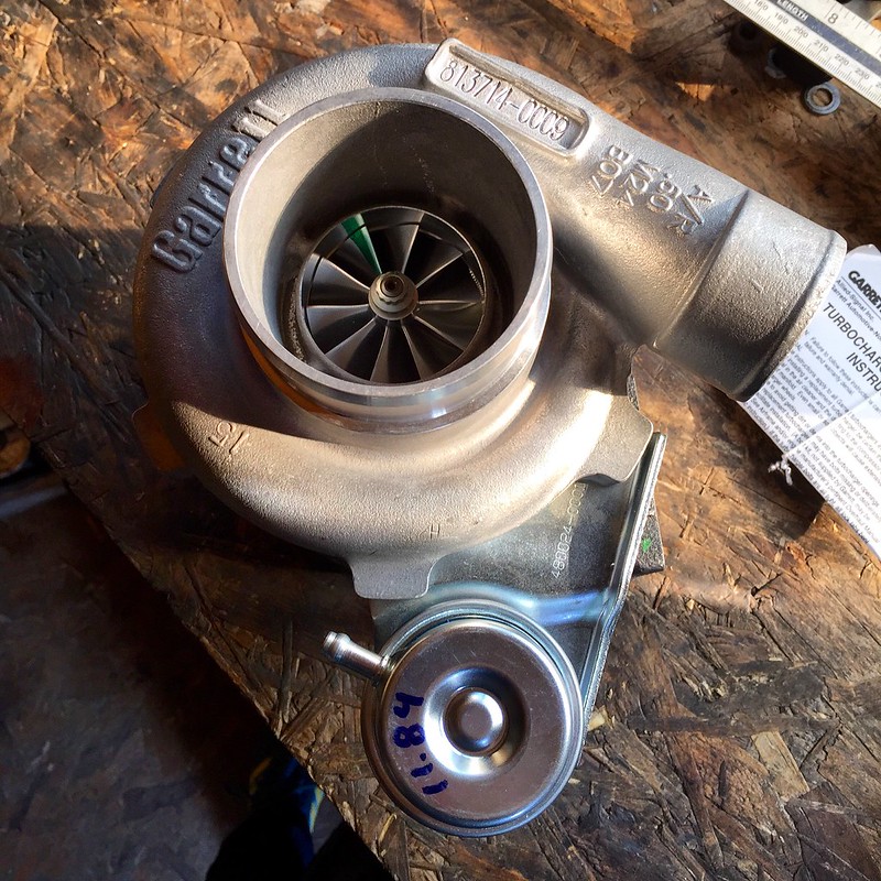

It’s a Garrett GTX 2867.64 turbo, much newer technology so should spoil quicker and give more power! Teamed that with an APW manifold and a new air filter & MAF set up.

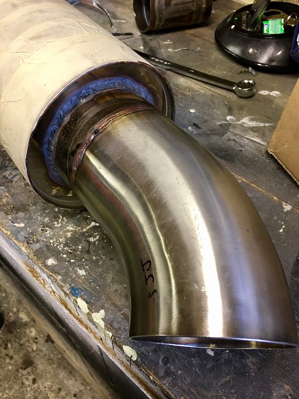

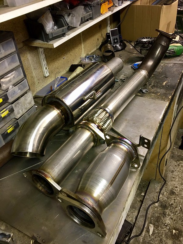

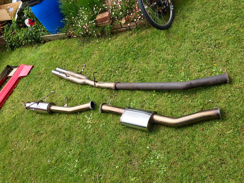

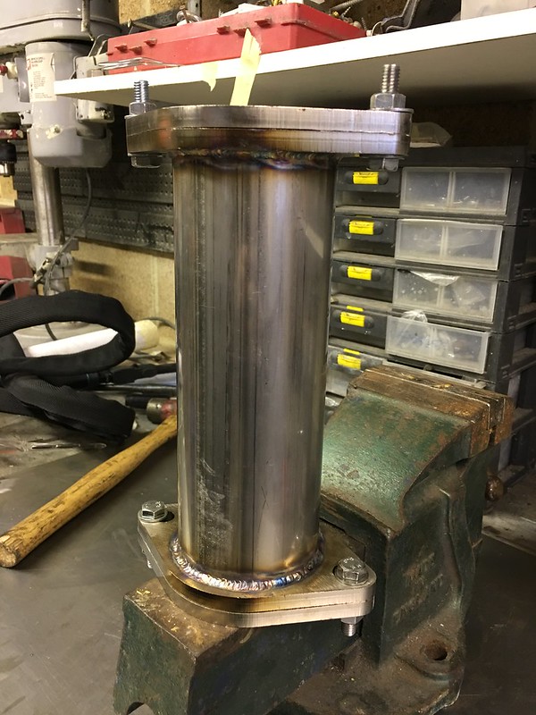

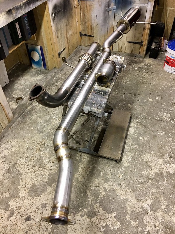

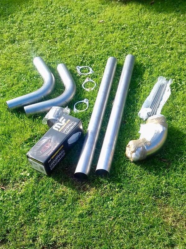

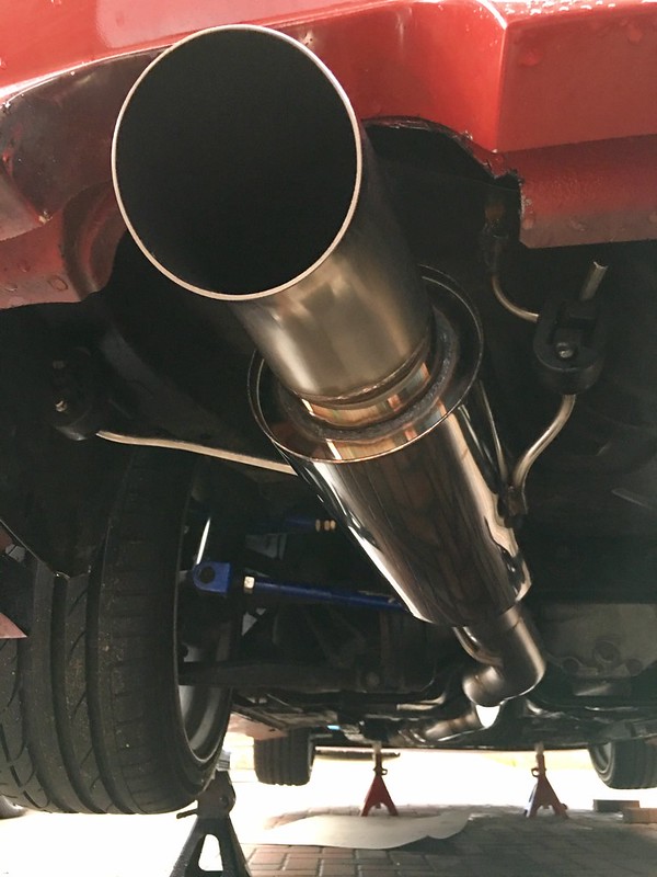

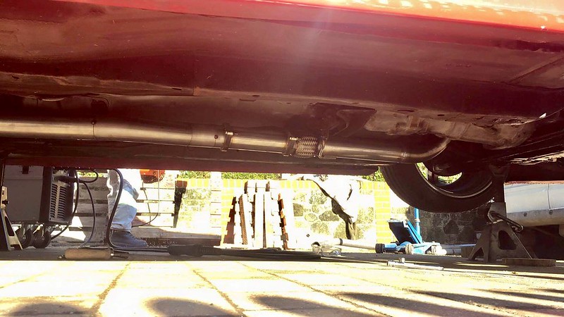

Me and my good friend Joe decided to then make a new exhaust, the shotgun one was far too loud, the Kakimoto sat far too low and was too quiet for my liking. The parts were purchased.
Decided to get a sports cat as well, this should hopefully help me pass an MOT, pretty sure for the past 2 years it has been in the country it’s had dodgy MOTs which isn’t good!
Was a horrible day, but we needed to crack on and get it done as it is booked in for mapping on the 22[SUP]nd[/SUP] of this month!
Sports cat done.
De-cat done.

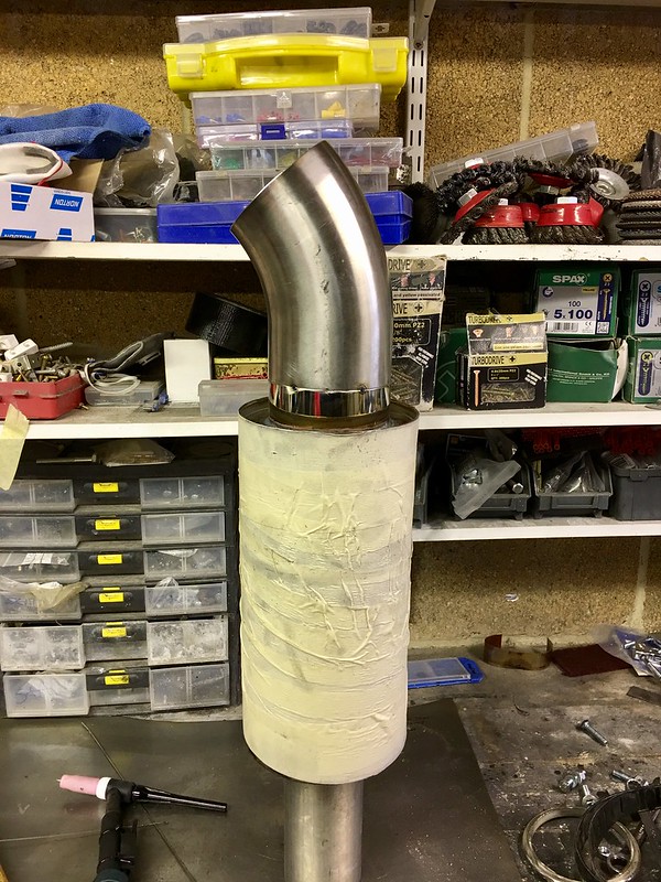

As some of you may know I like having a droooop on my exhaust, we cut the rolled tip off and tacked the 90 degree bend we had cut on.
Lovely welding by Joe.

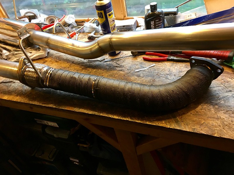

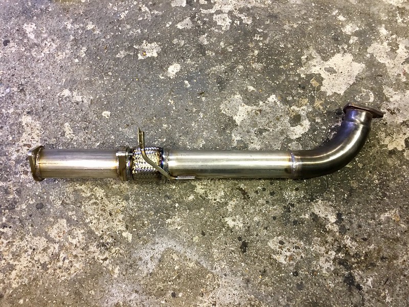

New downpipe section with a flexi was made, I will heat wrap it again this weekend.
Here’s how the droop sat… I personally love it, but I doubt anyone else will haha!
That completed day one.
Day 2 continued, as you can see it is all tucked up under the chassis rail.
Just needs final welding now and heat wrap applying before mapping next week. Can’t wait to get it back now!

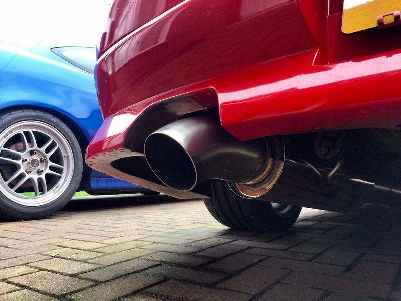

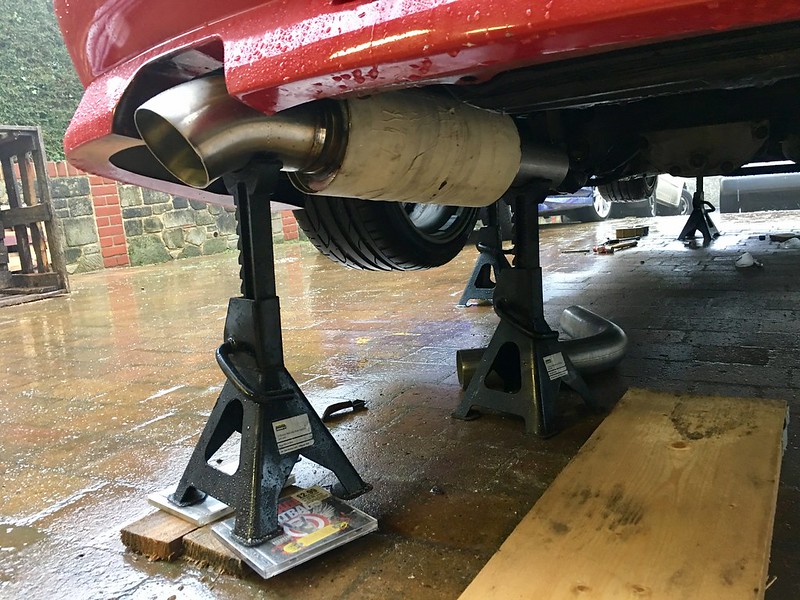

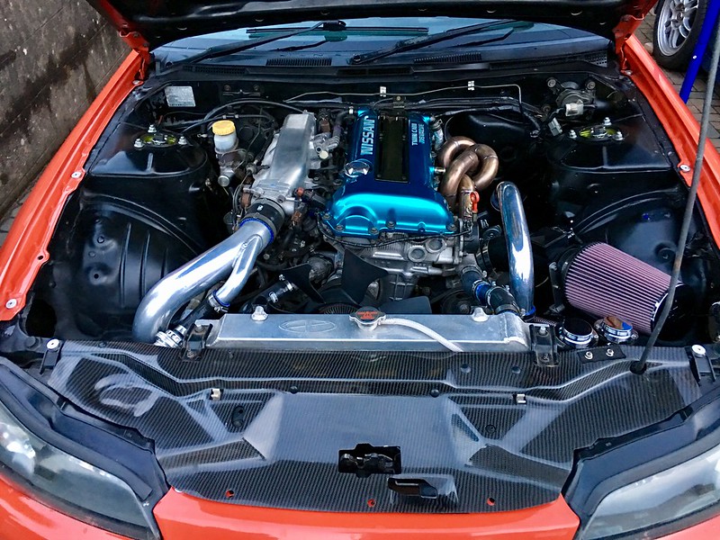

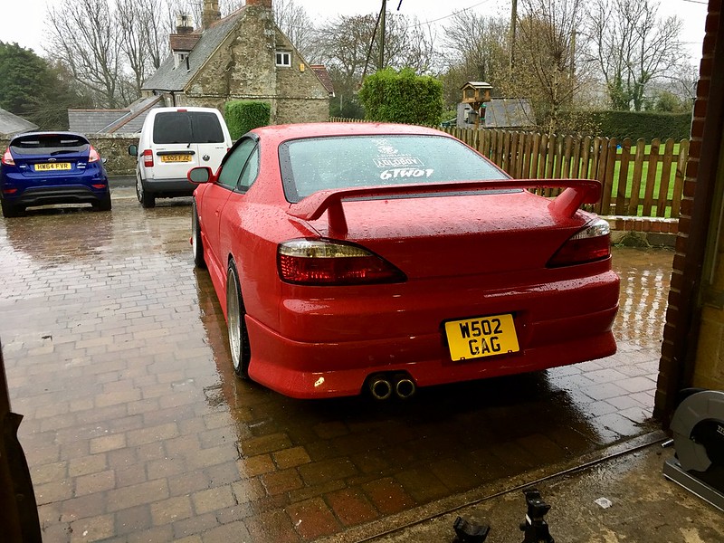

So here is the final product, to say I'm happy is an understatement. Just the right level of loud now haha! Tucks up nice and close now and gives me loads of room to go lower!

Put heat wrap back onto my downpipe.

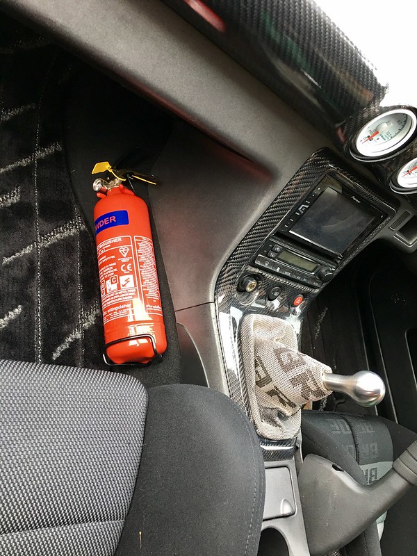

As I have great faith in my car I fitted a fire extinguisher ahaha! After seeing a car set alight at a show this year I’ve been contemplating getting one, I don’t actually mind how it looks really haha!
