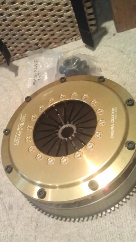

Disk and pressure plate

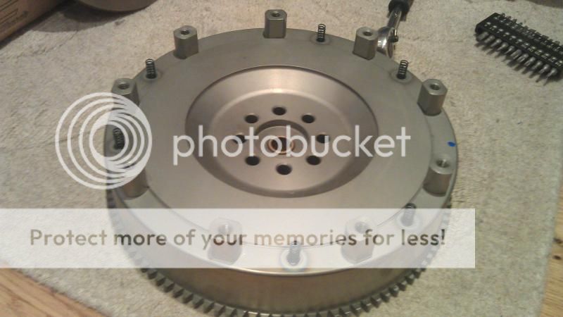

Flywheel with the return springs to keep things quite..

My initial thoughts were to be honest, WOW!! It really is an awesome bit of engineering for a single plate clutch system plus my worries about fly bolts etc were also set to rest with some simple measuring up. It DOES use the standard Dual Mass fly bolts :thumbs: All looked promising for a simple swap out :D
