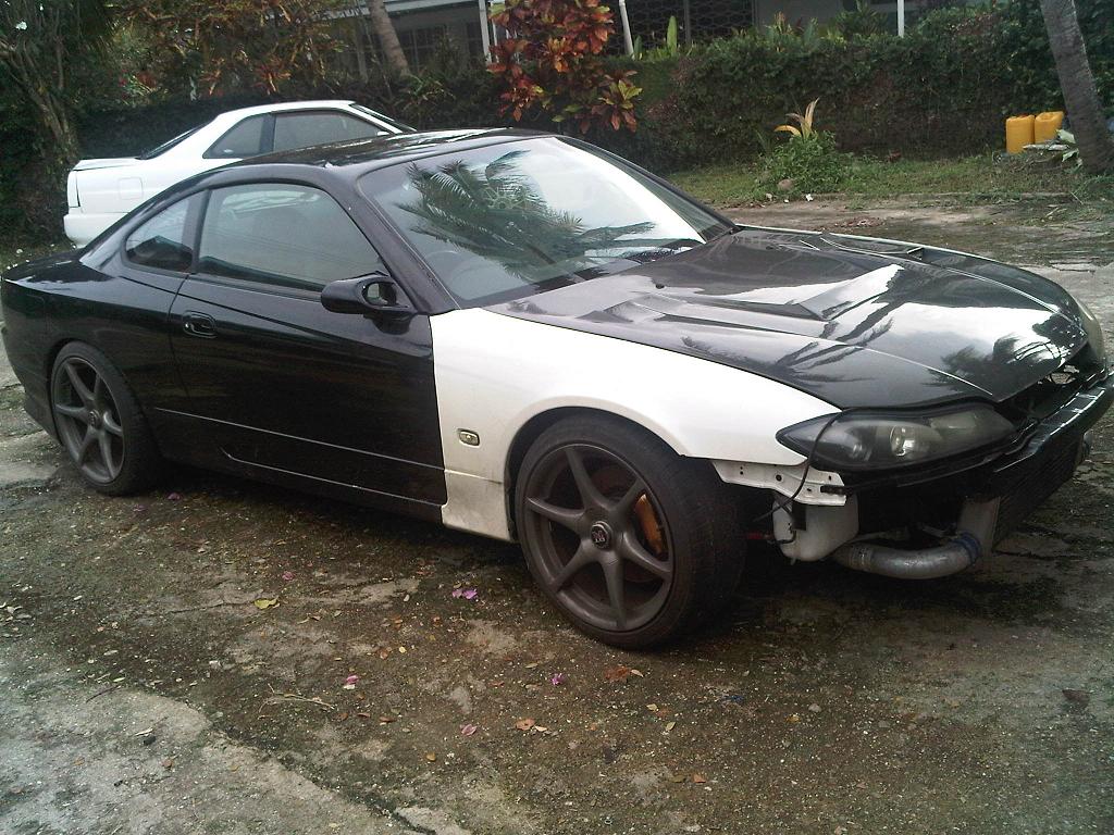

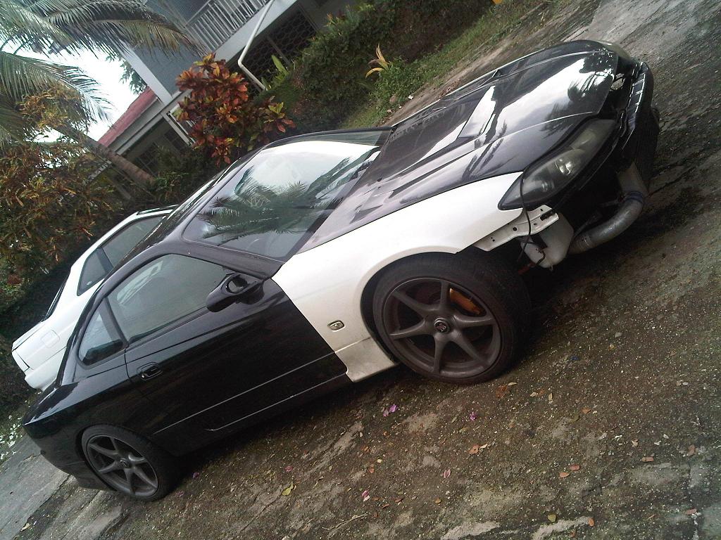

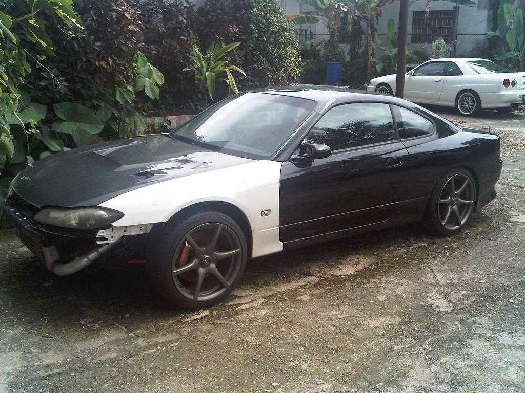

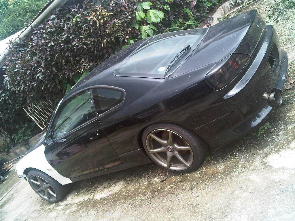

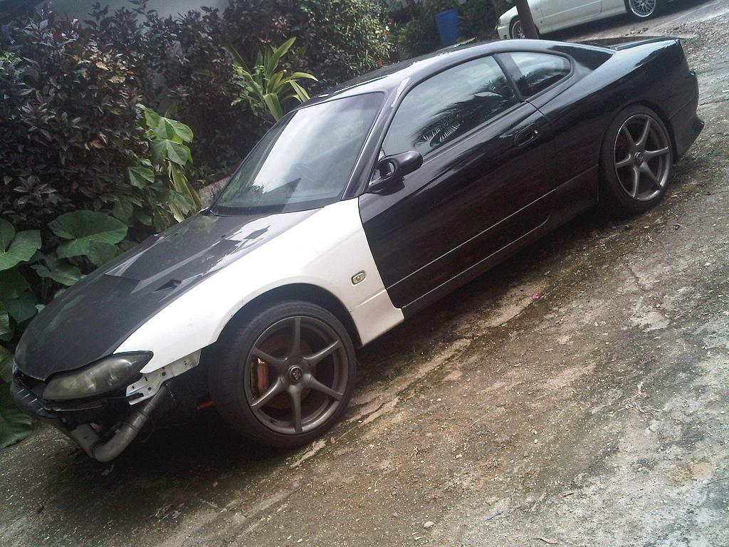

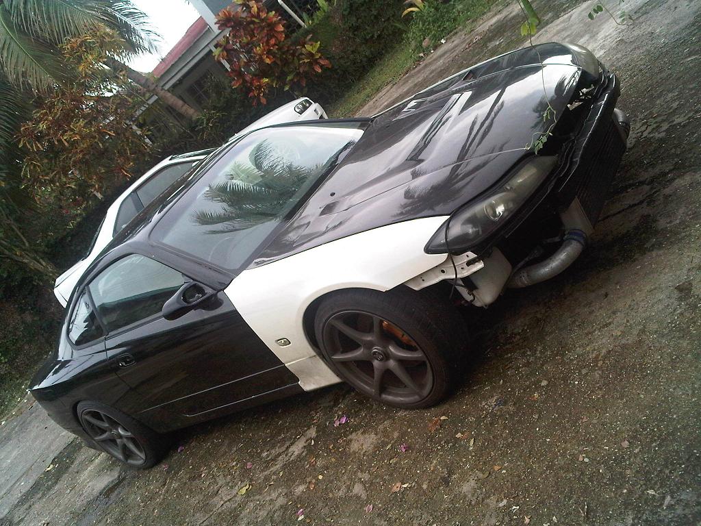

Well some updates, it's been some time and took the car to get a full respray. I am extatic as it has come out pretty darn good. There are a bit of things to be done still but thus far I am happy. Things on the To-Do List are, engine and colour change to be registered, Z32 MAF, Apexi Power FC, 850CC injctors, GT2871R or if I have the cash GT3076R, Refinished Intercooler Piping (Chromed), Blitz Turbo Timer, Blitz Boost Controller, Defi Gauges, I may swap out the Silvia Steering wheel for a Nardi, EP Racing Carbon Stereo Surround, Stereo/Amp/Speaker Install, Custom Pillar Pod Setup, Front Windscreen Molding to be replaced, Custom Bride Interior Door Panels and rear seat stitching.
So far here is the current spec and please excuse the pics as they are off my BBerry,

Some Pics, again sorry about the phone pics.
