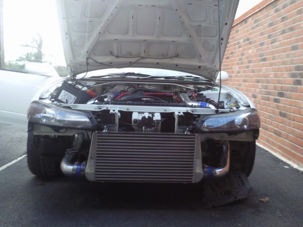

have to cut a hole in the battery tray with a hole saw, i have the instruction for fitting a Apex one if you lik it gives you direct insructions of where to drill the hole and size.

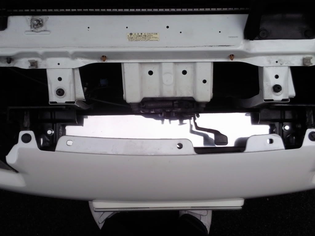

I needed to take a bit off the front crashbar so it could slip behind and loads of the stock bumper but you have a uprated so no bother as my new vertex fitted without trimming.
beware of the other side hole though that goes to the hotpipe, mine rubbed quite a bit so i got some silcone cut it and cable tied it to the pipe to stop rub.

Few shots after I fitted it, the ones without the bumper are before we refitted the crashbar.. It's easier to remove and cut I found.
